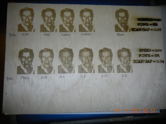

Hi all
I did a comparison for dithering pictures in lasercut 5.83 with different dithering settings with 2 speed and scan gap settings.

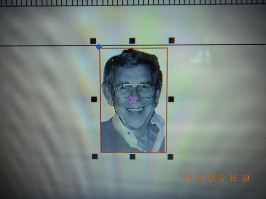

the picture is scanned color picture at 600 Dpi and just converted in corel paint X4 to 8 bit greyscale.
orig picture attached
also a comparison chart for the different dithering settings to see how the setting of the dithering influence the out come of the picture what is tremendous.
I use only a piece of "sandply" from HD.
the speed, power and scan gap settings on the right site, the diofferent dithering settings und each picture
I wana say my machine is a K40 converted to the 2012 DSP with the 40W laser PS from marco and the stepper driver M5042.
I was thinking this shows how easy and quick it is a picture to use without fooling around with photo editting programms.
this are the comparison chart of the picture the dither settings und each picture
this is the picture I used for this test nothing special done to it just converted to 8 bit greyscale
