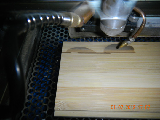

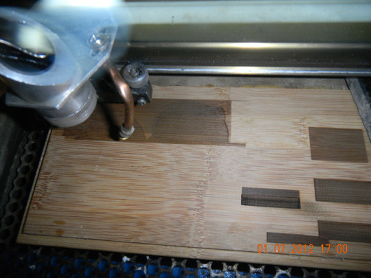

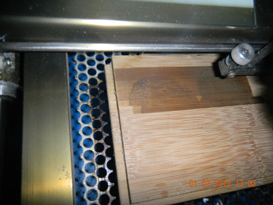

again after installing the new lasercut 5.83 the following is happening :
changing on the LCD panel the power and /or the speed after halt /pause let the laser jump to another position ( see picture)
the probleme is if a job is downloaded to the machine and the machine starts but the result is now what I wanted I used to change the settings with the LCD panel and start again it was fine before with the old version but now when I start again it startes on a different place what ruins the whole.

Is there an offset to the file you are engraving? Does it start right at 0,0 or have you set it so that it starts to engrave 5-10mm away from 0,0 position.
When you reset the LCD panel it might reset the 0,0 start point to where the last job finished and then start engraving at the offset distance.

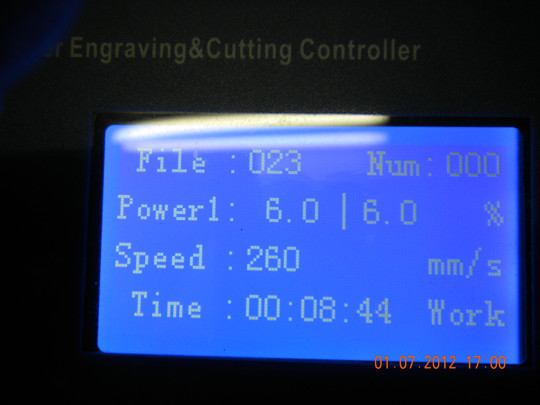

no I dont reset I just pause the job with the LCD pause botton, change the setting of speed and / or power to test the picture and then hit the start botton again.

I dont think it has to do with the lasercut programm used to download the work to the DSP it rather has to do with the LCD panel and the DSP comunication because it only happen after the start of the job was is fine but when I use the pause botton on the LCD and change the speed and /or the power botton and hit the start botton on the LCD to work further the job the change in the start position is happen.
but maybe this all comes from the fackt that I can not upgrade the DSP system because of the error what comes up. I had send you the System file what could be used to maybe find the probleme
