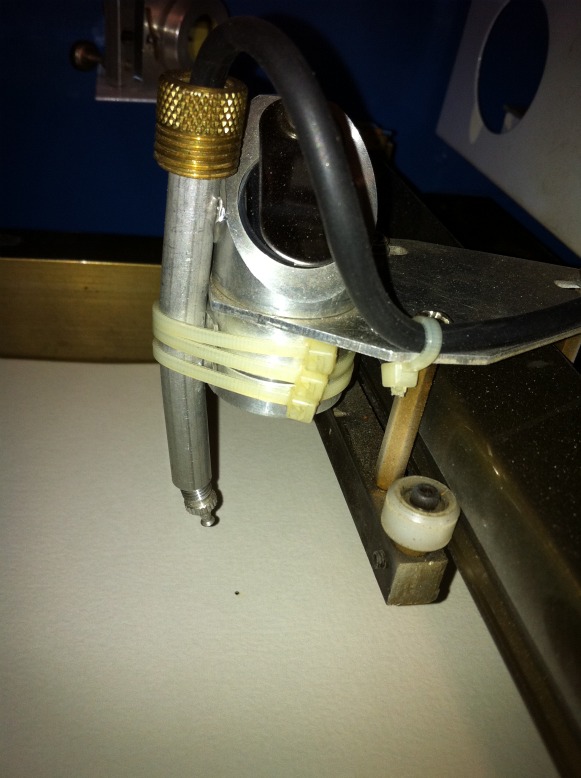

I got a small used airbrush compressor that someone gave to me and I tried making my own air nozzle from scratch. first I made one similar to the one marco sells (at leas the same idea) with a hole about 1/8 of an inch in diameter but it was almost impossible to avoid blocking part of the laser beam going thru that hole. I made a larger hole but the result was a wide air flow and low pressure
which was enough to keep the lens clean but not enough to blow away dust and smoke from deep cuts. Obviously I was not satisfied with that and I came with another idea. I wanted something that would create a very narrow air stream going right where the laser suppose to hit at with a considerable air pressure and here is what I used. A small aluminum tube and a small nozzle tip from one of those cheap airbrush paint guns, something that you could passible find at harbor freight. I know that out there is something that works and looks better than this but at this moment it helps a lot and probably in the future I will do something to better protect the lens from flying particles. My gain now is no flame, less smoke, deeper and cleaner lines. The bad part is that it has to be in an angle to prevent blocking the laser path but it is not that bad.

Here is the air assist I'm using now. Marco's nozzle just did not have enough pressure with my air source. I originally had the tube longer but had to cut it down since it was picking up small pieces and shooting them across the work surface. It seems good now to have enough pressure to prevent flame ups but not enough to launch 1/16th acrylic.

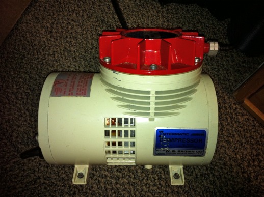

How big is your compressor? can you get a picture of it in here?Gadroc wrote:Here is the air assist I'm using now. Marco's nozzle just did not have enough pressure with my air source. I originally had the tube longer but had to cut it down since it was picking up small pieces and shooting them across the work surface. It seems good now to have enough pressure to prevent flame ups but not enough to launch 1/16th acrylic.
- Posts: 118
Re: airassist from marco brings focal distance to 70mm
I'm using the 1/5hp harbor freight airbrush compressor. The nozzle, hose and tube are from an old Testors Aztec airbrush I had that I never used. I fashioned the mounting plate out of 1/8th and 1/16th inch acrylic.
