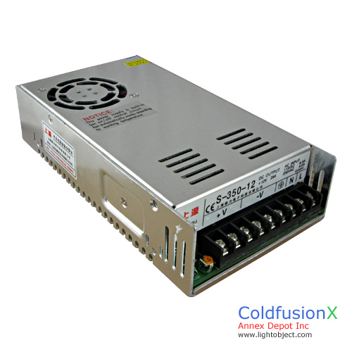

I need help connecting the power cord to the power supply.
I also need to understand the other terminals on the power supply to the 4 axis CNC Stepper Motor Controller ( TB6560) There seems to be NO documentation on the power supply and the terminals for setup.
Any help would be greatly appreciated/ :D
Re: need help how to wire DC 24V 15A Switching Power Supply
It's pretty simple.
N= Natural
L = Live
Earth = Ground
There are 3 sets output terminals, three V+ and three V-. Any pair will get you 24V DC
