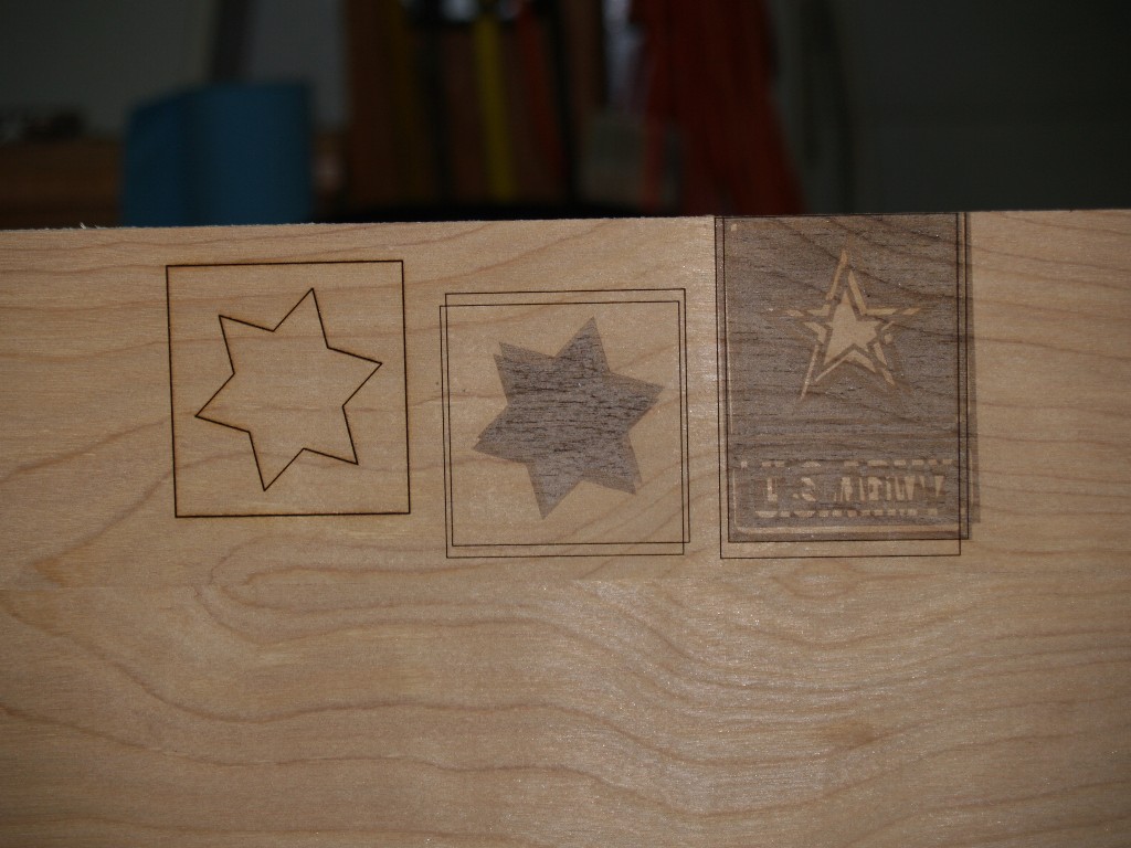

I am having a problem with engraving a raster. The vector comes very close to perfect, but the raster comes 2 degrees to the left (out of square) and 8.333 percent short - both on the "Y". I have tried changing the dip switches for the step motors and changing the settings for measuring the "Y" travel. I can make it worse but not better. Any suggestions? I can't find anyone in San Diego that knows anything about lasers who will try to help.
I would be very grateful. This laser is meant to help with making urns for families who have suffered violent deaths. Having your loved ones photos come out like this is very disturbing.

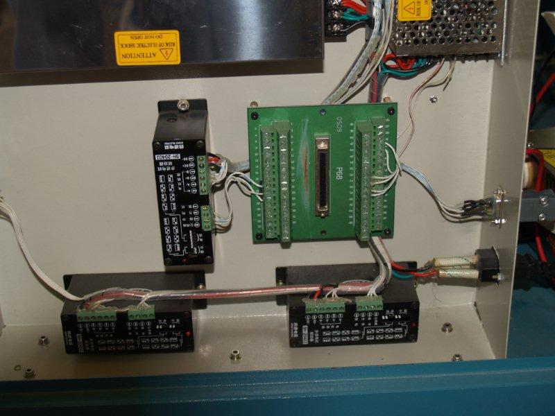

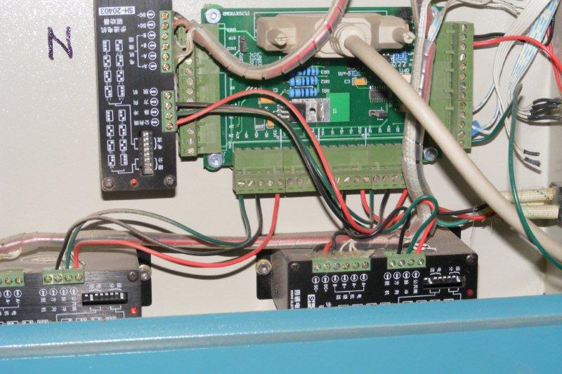

Can you take a few photos of the connectors and draw a little wiring diagram of what it's connected too and get it up here for us to look at?
A little bit of info like this can go a long way to a good result.

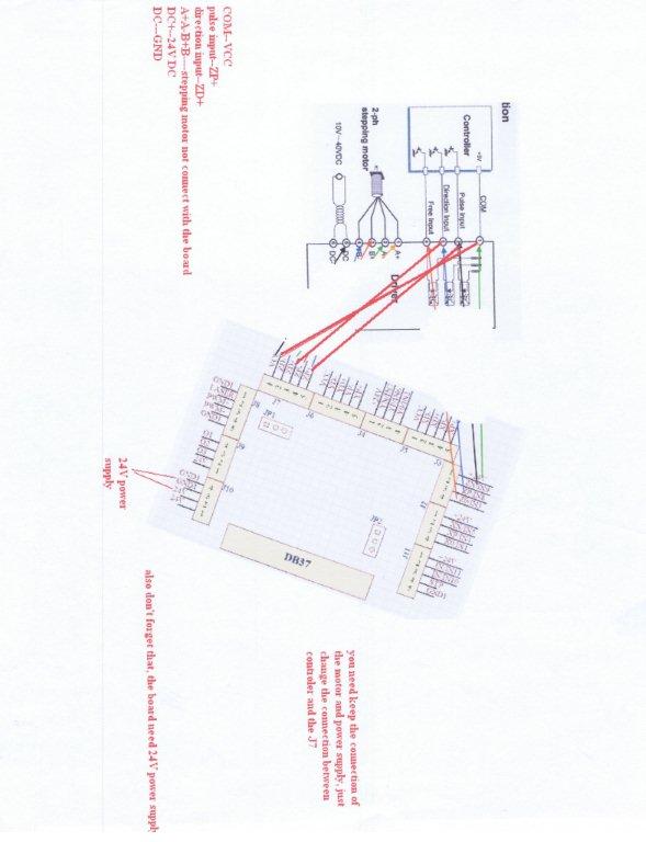

Thank you for your reply. I am attaching photos of the wiring and a copy of the diagram that the vendor gave me showing me how to connect the wires and how the dip switches are set for the step motor controls. The drawing with the red lines are the wiring connections the vendor gave me. The orginal PCI board and Dongle were defective and since I was not the original purchaser, the manufacture would not give me and technical assistance - even when I offered to purchase new boards, etc. That was why I changed to a different board. The drawing is the only assistance I have received. If there are any suggestions you can offer, I will be very grateful. I admit I am really desperate.
Thanks again for your assistance in looking at this.

I just realized the PDF was not readable so I rescaned as a JPG. I Hope this is easier to read.
