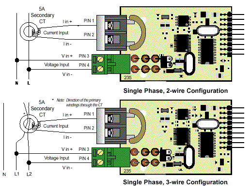

Installing a CT
The primary winding of the CT is a wire that carries the current you want to measure. If you clip your CT around a two- or three-core cable that has wires carrying the same current but in opposite directions, then the magnetic fields created by the two wires are equal and opposite and will cancel. Your CT will have no output.
http://openenergymonitor.org/emon/build ... troduction
Crossed wires inside CT on 240V circuit.
Current Sensing Transformer Wire Diagram.gif (44.44 KiB) Viewed 37133 times
A picture is worth a thousand words!
Can we get a clear diagram like this for the JLD404 AC connections?

Thank you for the good picture. It helps to understand how to monitor the unit US 220V "Two phase" power. Usually, AC220V is single phase common in other country. But US AC220V is combined by two AC110V. So, it's not as common as other country like Hong Kong or China where the electricity is true "Single phase" AC220V. "Two phase" is a strange terms to be used but it is the case here in US. Some argued that it is still a single phase while the other called it "Two phase". Which terms you preferred, though?

You can measure the total wattage from both L1 and L2 through one CT if the wires cross inside.
To measure each leg seperately would require 2 JLD404 systems or one JLD404 with 2 CT's and a switch to select each leg.
Fig 7 + 8 diagram above.
