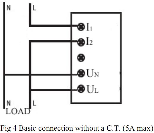

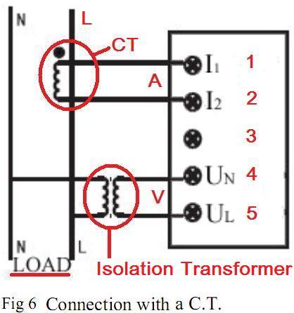

Re: JLD404 sub panel monitoring
Fig 6. did show the connection of the C.T. Simply connect the two terminals of the C.T. to the I1, I2 of the meter. To measure the current flow, you need to pass the load line through the hole of the C.T. That's all you need to dobob21635 wrote:Example pictures would be very helpful. I am monitoring a 30A, 240V, 3 wire load. The JLD404 did not come with any instructions, and the download doesn't explain the CT connection.
bob21635
- Posts: 12
- Joined: Mon Mar 25, 2013 5:54 pm
Re: JLD404 AC Wiring
Hi Marco
I understand all of that in fig 6 for 120V, but for 240V single phase you only sample one power leg?
Does that indicate only half the wattage?
If you put both power legs L1 + L2 through will it read total wattage? Another CT guide I read says the direction of the CT must be oriented the right direction with the power wires, is that true?
Is there a manual for the CT to download?
Which direction does it go and are the terminals the same on both sides of the CT? Also the CT guide showed the L1 and L2 crossing like an X inside the CT from the opposite sides of the CT, is that required? I will send you a copy of the guide, you might want to post it.

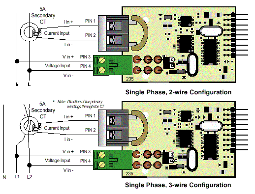

Installing a CT
The primary winding of the CT is a wire that carries the current you want to measure. If you clip your CT around a two- or three-core cable that has wires carrying the same current but in opposite directions, then the magnetic fields created by the two wires are equal and opposite and will cancel. Your CT will have no output.
http://openenergymonitor.org/emon/build ... troduction
A picture is worth a thousand words!
Can we get a clear diagram like this for the JLD404 AC connections?

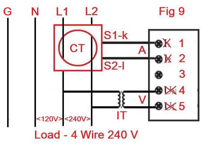

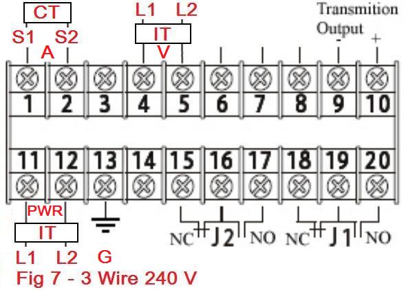

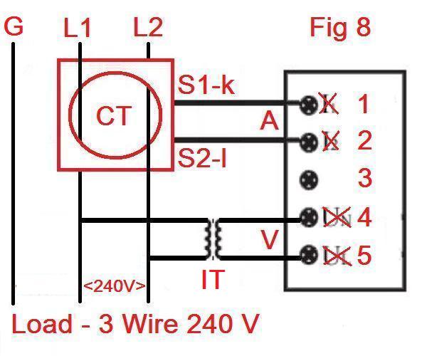

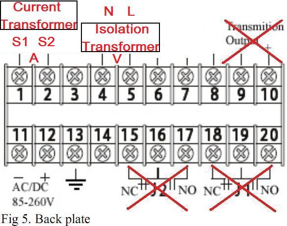

I studied the drawings and came up with my own design for 220/240V single phase applications.
This is what I came up with, I hope it helps others with the same situation.
I'm have been unable to find small isolation transformers nearby, anyone have any ideas?
Would small inline fuses be acceptable?
http://baida-china.cn
Marco - Please make these 120/120V, 220/220V, and 240/240V isolation transformers available for sale?
Basic 120V system
Expanded 120V system with Current Transformer and Isolation Transformer
120V connections (My basic JLD404 does not have the optional 2 relays or analog output)
220/240V connections (3 or 4 wire systems)
220/240V wiring 3 wire (220/240V only) Notice crossed wires in CT
240V wiring 4 wire (120/240V) USA only
Basic 120V system
Why do you need the transformer? The meter by default can handle up to 500v without the transformer
bob21635
- Posts: 12
Fig 6 in the JLD404 AC manual recommends the use of an isolation transformer. They are installed mainly for safety to isolate the high current from shorting out through the unit. Might not be legal to install without them? Anyone know for sure? What does the JLD404 manufacturer say?Tech_Marco wrote:Why do you need the transformer? The meter by default can handle up to 500v without the transformer

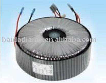

After an extensive search for small isolation transformers, this is the only source I found.
http://baida-china.cn/
They only cost $2 a piece, but have a minimum order of 200 pieces, since they are each custom made.
You could resell them on eBay for at least $10 and get more traffic flow to your website.
They can also be used with any other AC equipment on your website or elseware.
The power equipment I'm designing to sell would require them also.
Bob

You can measure the total wattage from both L1 and L2 through one CT if the wires cross inside.bpescaaz wrote:Is your jld404 meter capable of measuring single phase 230 3wire sub panel. L1-L2-N. if so can you send me a diagram using two cts.
To measure each leg seperately would require 2 JLD404 systems or one JLD404 with 2 CT's and a switch to select each leg.
Fig 7 + 8 diagram above.
