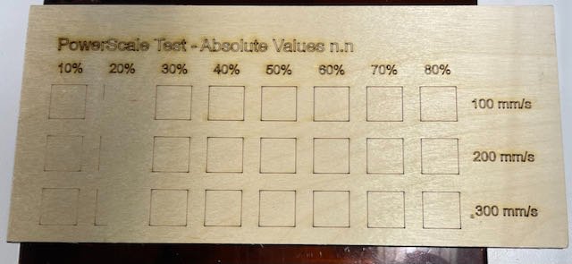

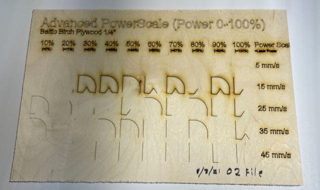

I tend to think this is most likely a power supply issue or my DSP configuration. When running laser cuts (Line), depending on the power setting, I will get segments or partial segments that are not lazing. Based on a lot of experimenting this is not a mirror alignment thing because the milliamp meter will go to zero when the missing line segment is being traversed. And I can run the same design at a different power and that location will be written. The display panel of the Ruida shows the speed and power levels as set in my design in Lightburn; it is the laser power ammeter that is going to zero.
I thought I was imagining it, or that this was a seldom-occuring glitch. But as I've gotten more into using Min-Max power settings and tried some of the O2-Creative power test diagrams (which use fractional power of the Min-Max range) things have gotten really bizarre. The first attached photo shows a power test document exactly as downloaded from O2-Creative. The second one I shortened and set each square to a different color layer with Min = Max. It runs more consistently, but still drops out at certain power levels. I've done other tests with lines and squares at various power levels and it seems like there are a number of "magic" power levels that cause all or part of the line to be un-lazed.
I tried changing from the PWM output of the Ruida DSP to the Analog output. It was no more consistent. And as for Min-Max ranges, all the lettering in these two photos was done with Max 50%, Min 30% - and these drew. However, if I changed the minimum to 20% half the letters will not draw. I've experimented with a number of other machine configuration settings, but none of those changes helped.
Advice???

Result of unchanged O2-Creative Power Test File
Manually created fixed-power levels test file

Solved. Replaced the laser power supply and it works great. I’ll send back the LO Lightbean for repair and hopefully have that as a standby replacement.
