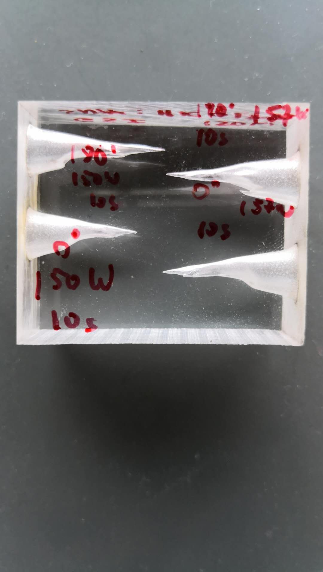

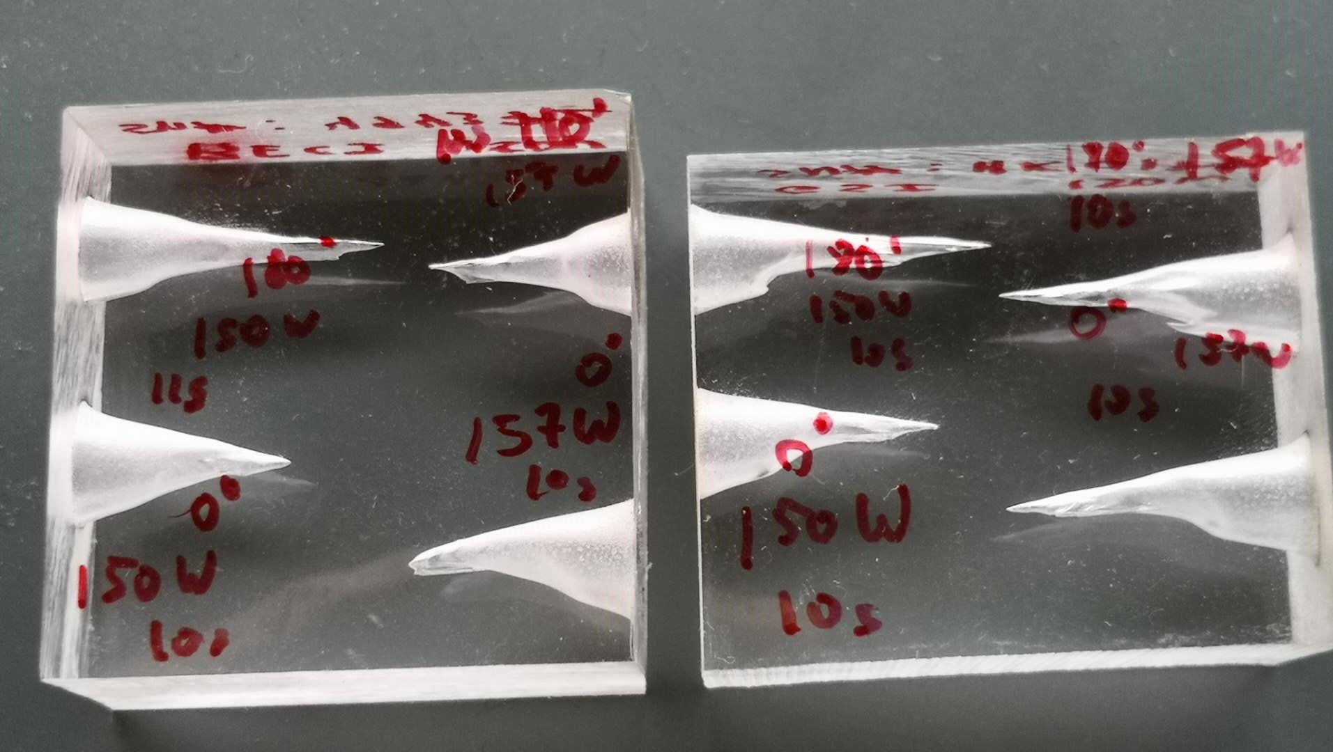

We have received 20x GSI not too long ago. I was so excited to run a few test and here is the results.
Pay attention to the deep (length) of the GSI it was way longer than the Reci
Take 157W as an example
GSI: 24.47mm
Reci: 19.43mm
GSI
Left (Reci) vs. Right (GS)

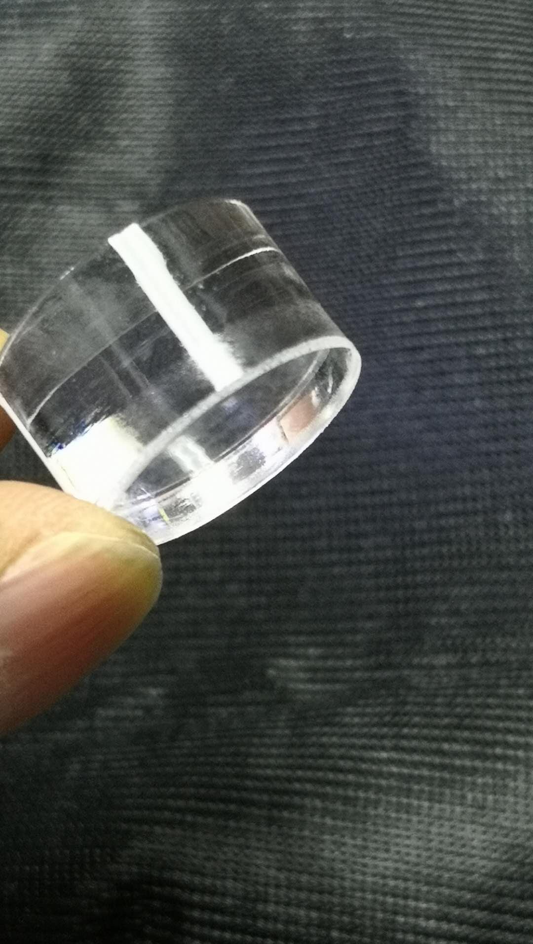

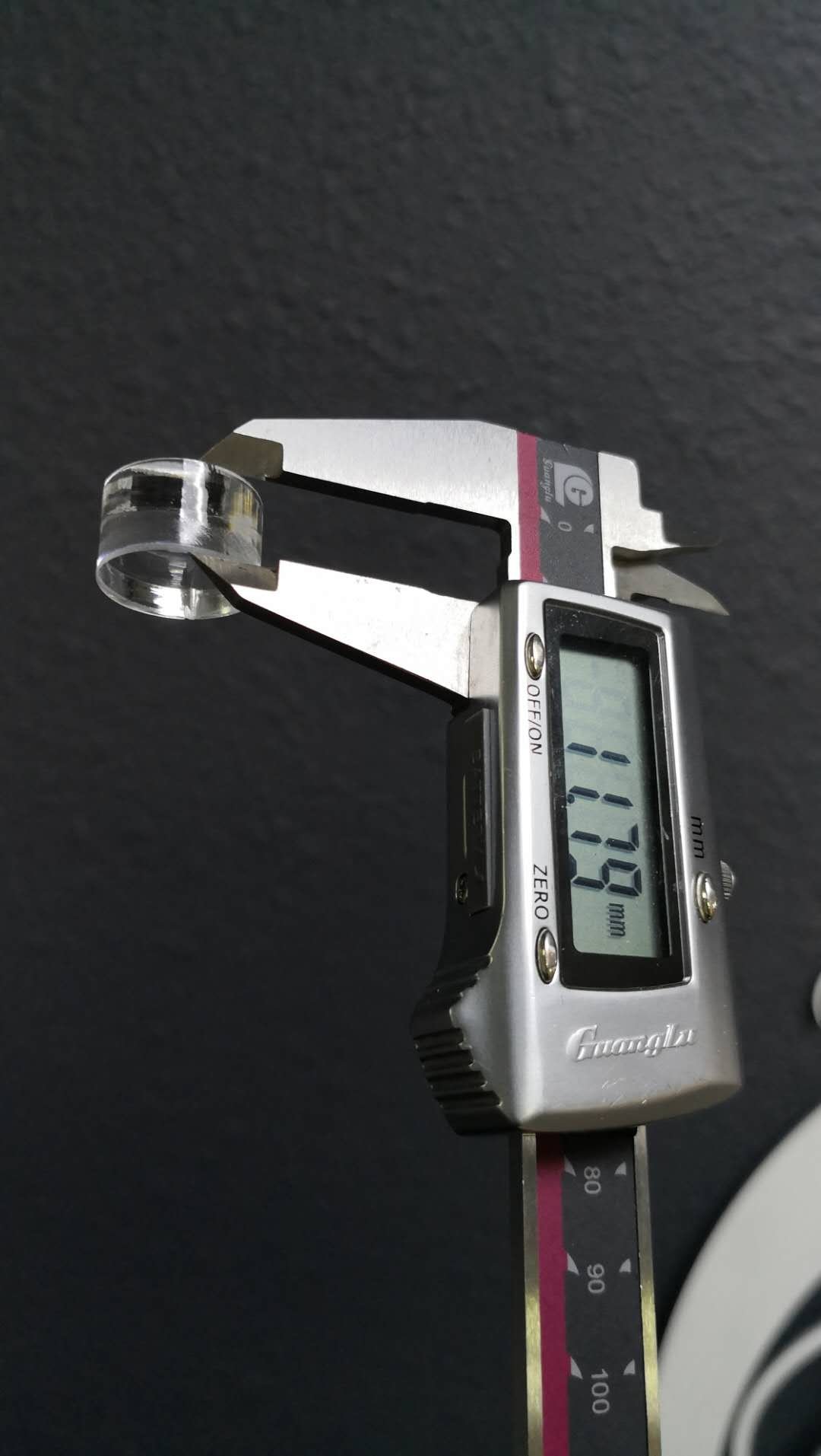

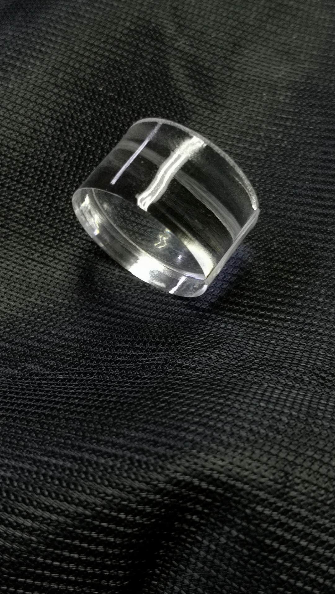

We used a 130W GSI on our Hybrid system and it cut 1.5mm stainless steel like butter!
Re: Beam patten comparsion Reci vs. GSI
Cutting 12mm acrylic with 130W Hybrid system
