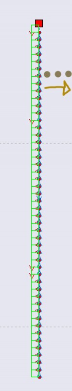

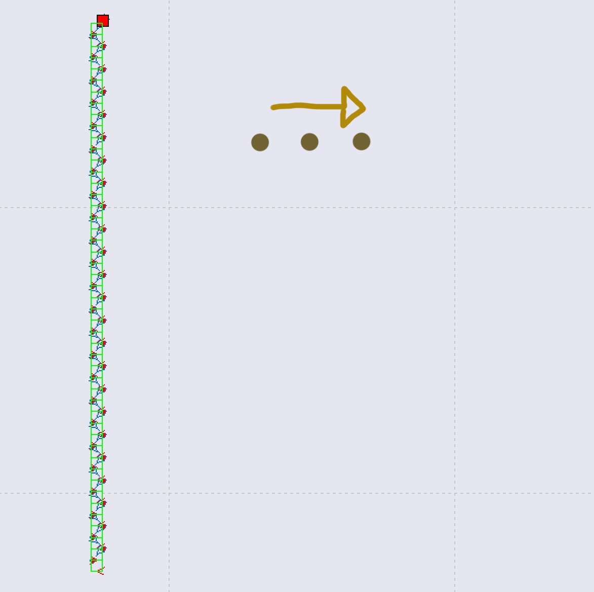

During the job cycle each square would shift up slightly, eventually resulting in the laser head to return to the origin above the original. Each job after would shift it up the exact same amount only along the y axis.
During the job cycle each square would shift to the right slightly, The return origin would be to the right of the original. each job had the exact same results.

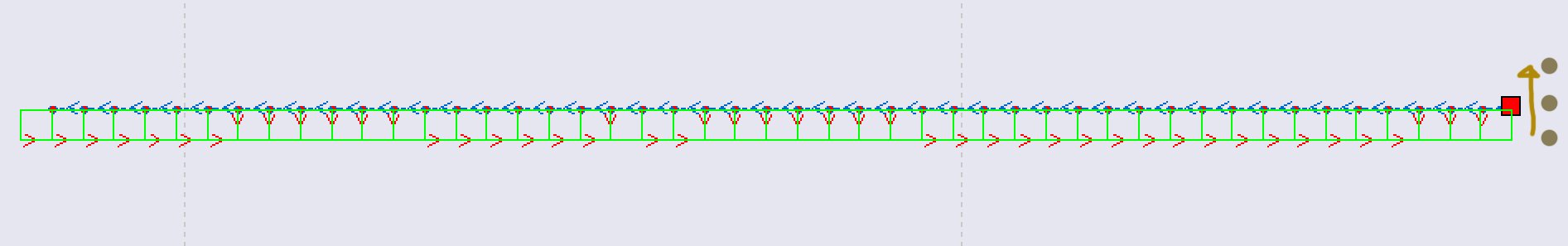

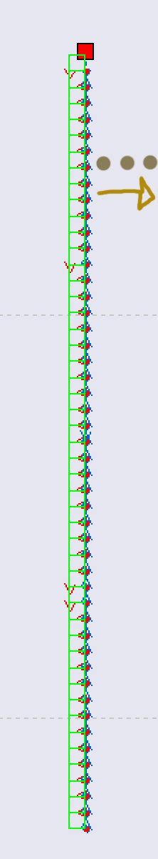

During this job I changed the pathing to have alternating travel paths that moved diagonally. The results were however the exact same as the previous.

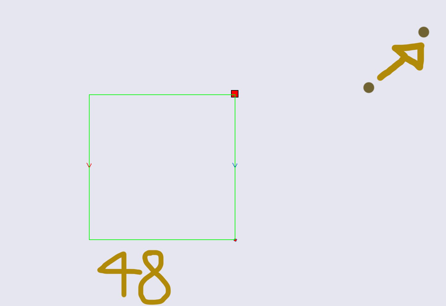

I also tried placing 48 of the exact same squares on top of each other. The result this time was each time the job was run it shifted an equal amount up & to the right

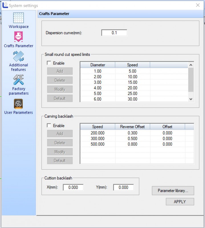

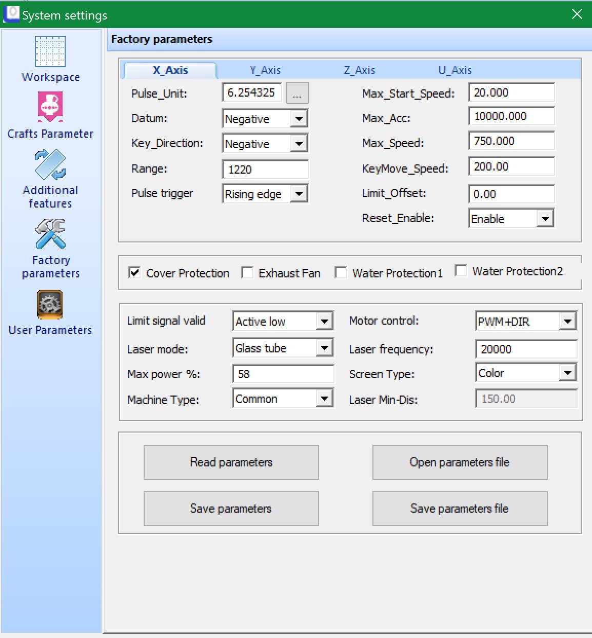

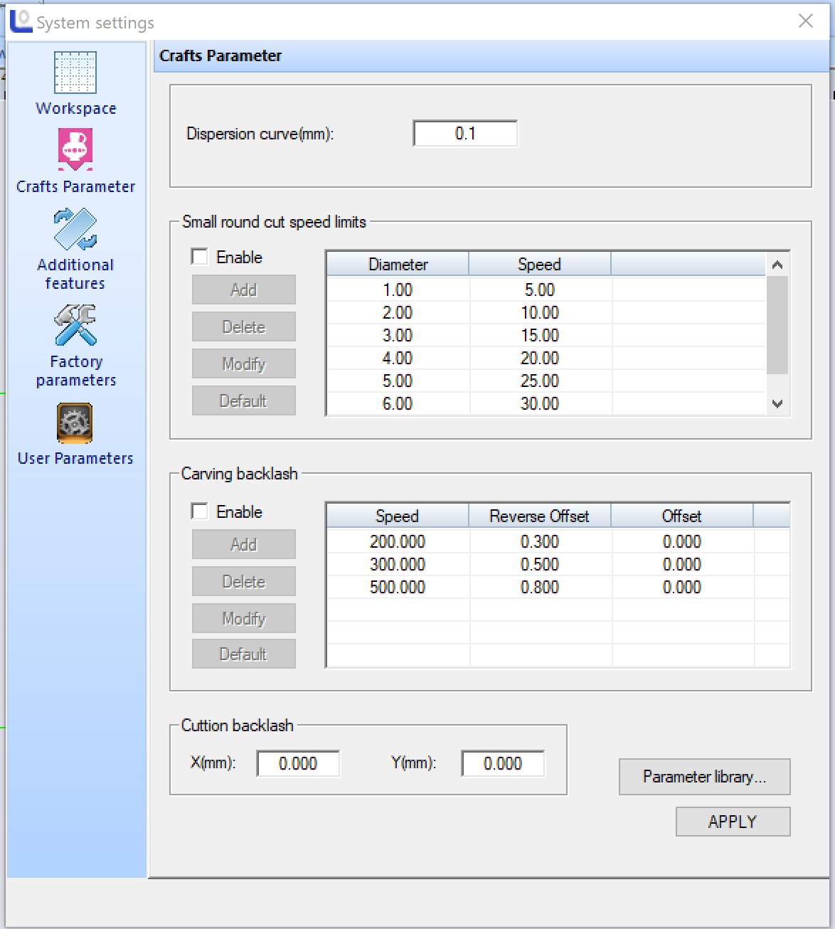

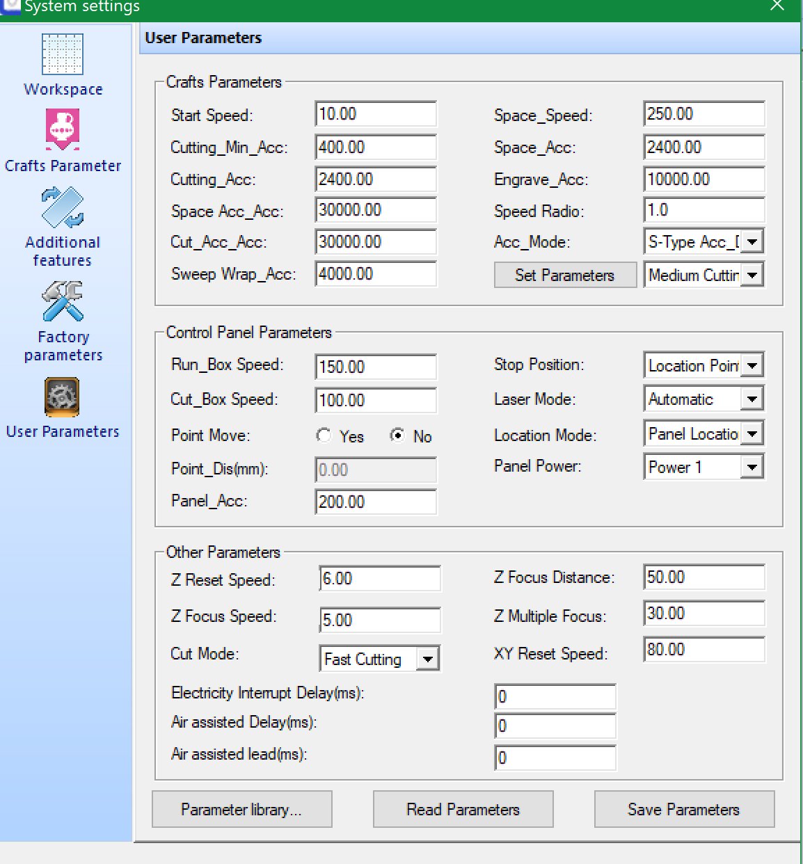

Here's my settings.

Try changing the pulse from " Rising" to "Falling" on Y axis. If not getting improvement, try this on X axis as well

Tried changing only y, only x, and then both. All have the same old results

Ah there we have it. It was in fact the rising edge needed to be changed to falling edge. However it doesn't take effect until after the DSP is power cycled.
