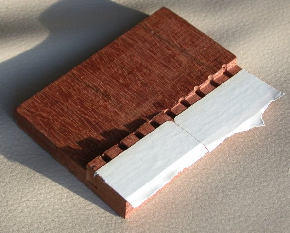

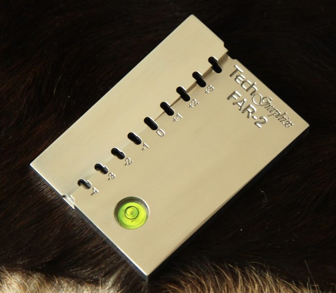

Re: Co2 Laser focus length
General you may say that a short-focus lens is better for engraving and a long focus lens is better for cutting as the Depth of field is much larger.
Although i use a 38.1 (1.5") lens i have no problem cutting 6mm (1/4") acrylic
To find the exact focal length you may use a Focus Adjustment Ramp: It doesn't need to be that beautiful.. This one does the same job: Kees
