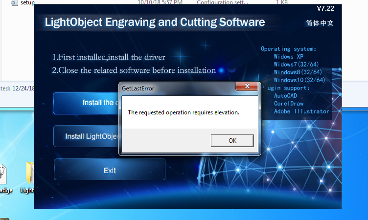

Hi i can seam to install the plug in for corel x6 i can see the plug-in but when i try to install it i get and message
- Screen Shot 2019-03-02 at 8.10.11 AM.png (401.59 KiB) Viewed 52033 times

Try opening the installer.exe file as administrator by right clicking on the icon and selecting "Run as administrator"gary56 wrote: Sat Mar 02, 2019 8:37 am Hi i can seam to install the plug in for corel x6 i can see the plug-in but when i try to install it i get and message

not sure that icon your are referring to? for me to right click on . I am the administrator ! I also tried to reinstall but i'm still getting the same message
