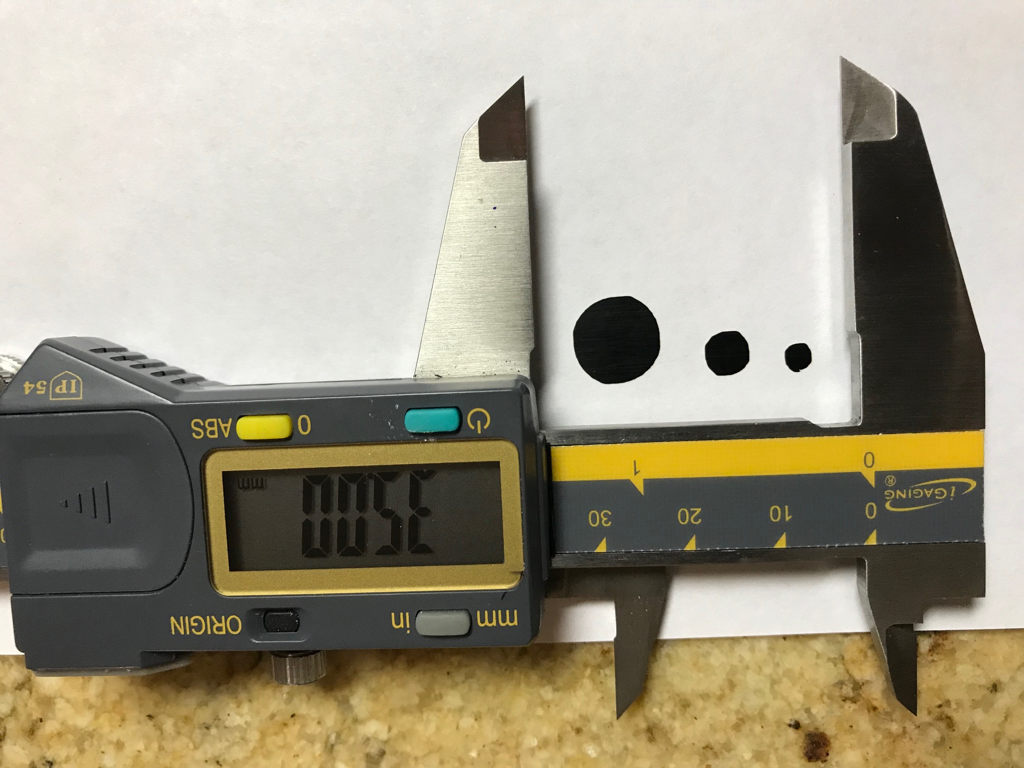

The attached file shows the effect of uncorrected backlash during a cutting job. The circles are 3, 5, and 10mm wide, each cut at a fairly slow 50mm/s. If you look closely, you can see the offset at each axis extreme, much more pronounced in the Y axis (as I would expect based on measurements).

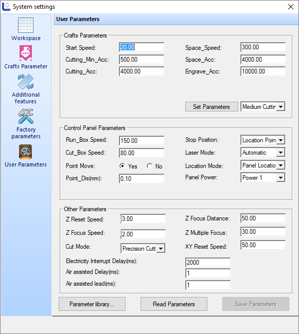

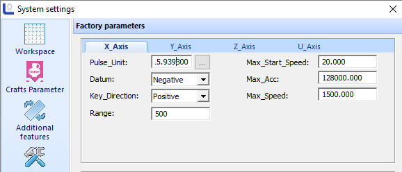

I'm using a DSP T9 controller (hence the post in this forum). The attached images show the parameters you requested. I admit that I may have the acceleration turned up a bit high, and I'm certainly willing to accept feedback on the parameters. It took me quite a bit of time to achieve what you see there, and I'm sure the settings aren't quite optimized since I started from scratch on unfamiliar software. I just noticed that the X um value is cut off - it's 15.939.
The previous picture showing the circles was cut at 50mm/s. As I mentioned in my last post, I did manage to significantly improve the backlash by paying some more attention to the belt tension and doing some raster testing at various speeds.

Re: Backlash compensation?
Your settings of acceleration for X and Y were way too high!
X: 10,000
Y: 5,000
Also, try to use 5000 for micro stepping
X: 10,000
Y: 5,000

Thank you. I appreciate you taking a look. I was playing with the accel settings to see if I could find one high enough to skip steps. Even with these settings, I’m not seeing skipped steps, though I don’t think the controller even accepts these values and uses some default value instead.
5000 for um? The Leadshine drivers are limited to 1600, 3200, and 6400. I used 3200 based on the video about the PR530 table posted by LO’s YouTube account.
—Nate
—Nate
5000 or 6400 for the micro stepping is just fine
