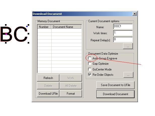

Re: Text engraving problem
Posted: Sat Apr 07, 2018 3:37 pm
by Tech_Marco
Check or unchecked the "Auto Group" should take care your issue
