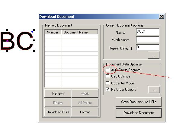

Re: Text engraving problem
Check or unchecked the "Auto Group" should take care your issue
