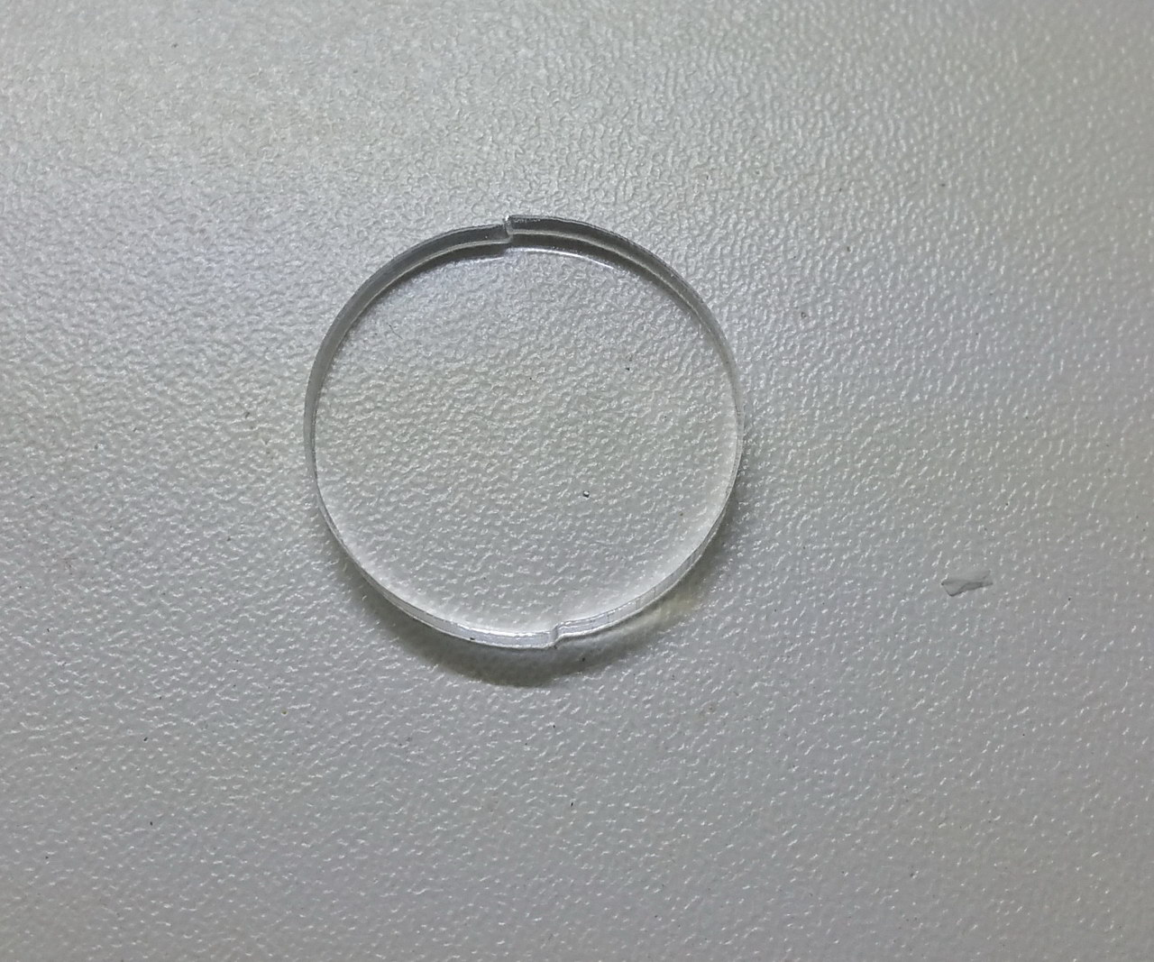

I have never achieved perfect circles with my 100W laser cutter using the LO-X7 Dsp controller.
When the Y motor changes direction in the upper and lower point of the circle, it make a tiny sudden movement and create a dent shown in the attached photo.
My laser is perfectly squared, perfect diagonals in any square size.
I am using the version 1.17.3.20
Anyone with the same issue ?

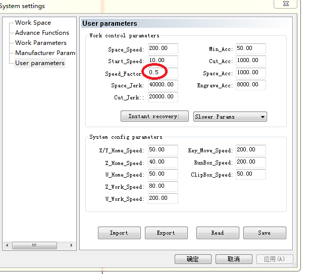

Re: No perfect circles with LO-X7
Send me screenshot of your parameters settings
Also, let me know the hardware setup like micro steppe,size of gantry, ... better send me a picture

After contact with Mr. Chan from Trocen, he asked to change one parameter:
I was almost buyed another DSP.
Frederico
I think this a important parameter and must be emphasized in the user manual.hi, sir, your pamaters is wrong
i will help you to set
speed_factor , you must set 0.5
4.0, it is very big
Frederico
