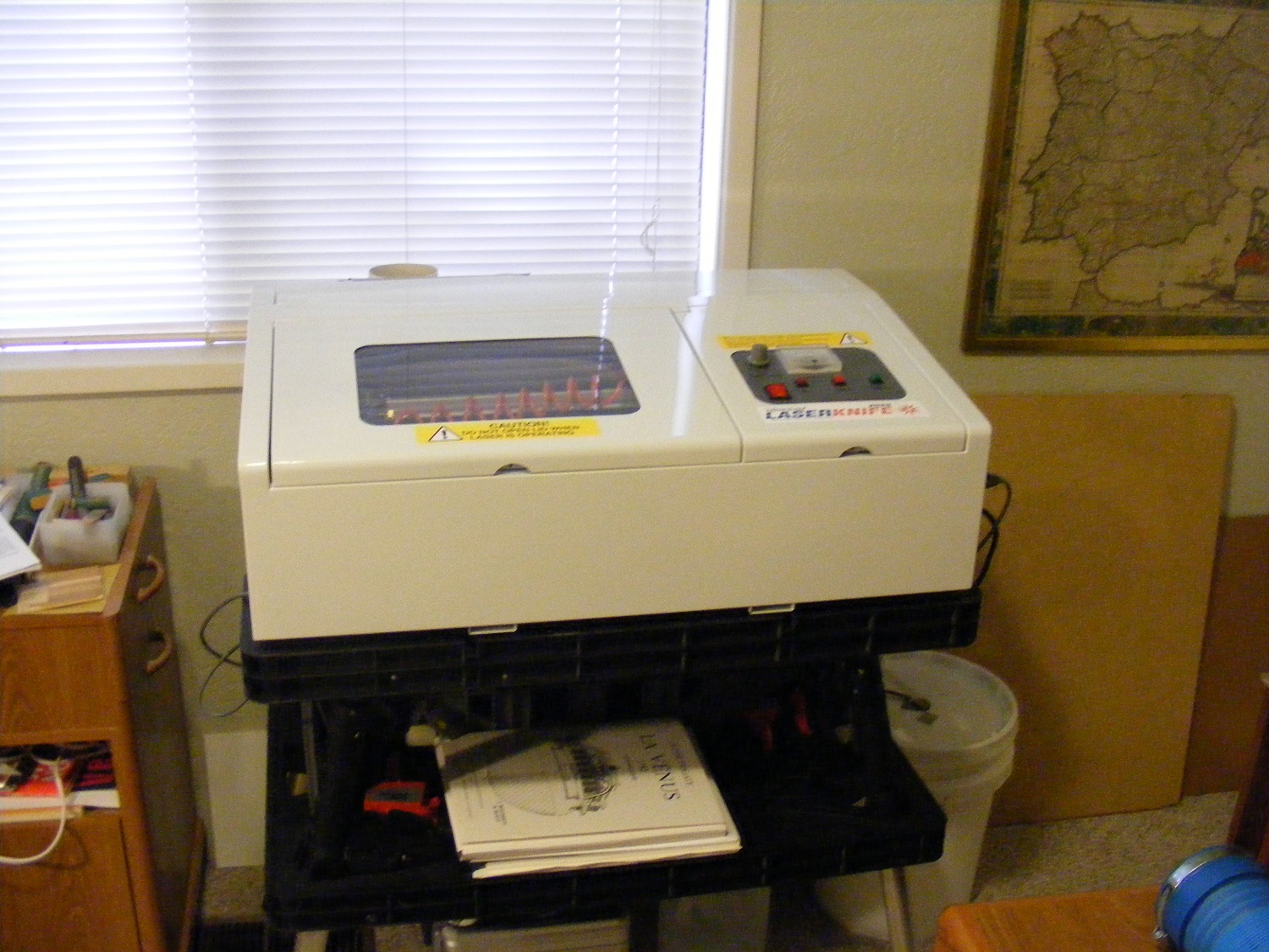

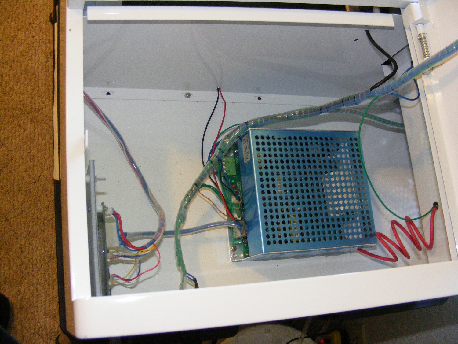

Could you please post some pictures showing your machine before I make any suggestion.

Here's outside and the PS compartment photos...

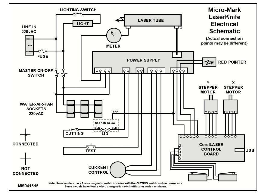

And the wiring diagram. I do need the 220V input for everything else on this beast.
