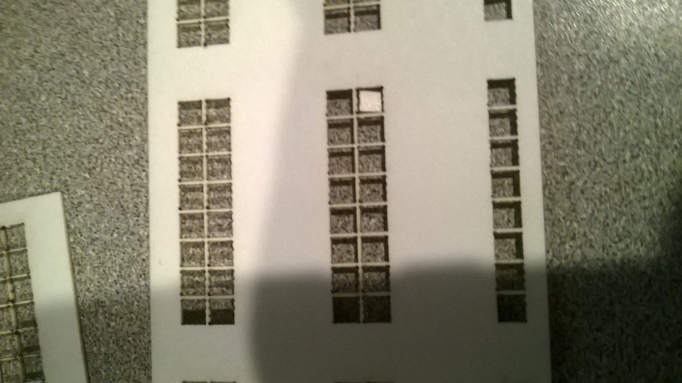

One of the laser users at our Makerspace facility is observing some strange cutting behavior with our X7 controller.
I'm posting his observations to see if anyone can help out. Here is what he observes:
But the new(ish) problem is that the laser is really doing some odd things with short lines. Instead of just firing like normal, it draws a dot, pauses to think, tries to draw the line but just makes a 3rd dot in the middle, then draws a dot at the end, pauses, then fires at a power level well over what it was set for, then moves on to the next line. So instead of a short 2mm line you'll get a dot, a very weak line or a dot, then a a very very strong dot. Its as if the controller is pausing for a moment between lines, and decides to just keep the laser firing while it thinks.
Speed was at 99. Problem is any lower and the laser just burns right through the paper. I'm not sure it's a speed issue though because I was also doing some through-cuts at speed 50 and on some intricate shapes it was doing the same thing, pausing at corners for a half second or so and burning a big dot.
It also doesn't do it with every line, sometimes you'll have like 50 identical lines with identical spacing in a row, it will then over-burn every 5th or 3rd or 10th line, but it will be consistent in that respect and create a pattern.
I made a little video. You can see it stops to "think" every 2nd or 3rd line. It should be rapid-firing these lines out without pause. They are 2mm lines. I have a similar pattern of 4mm lines that it does very quickly without these pauses. It seems to only happen with lines under 3mm or so.

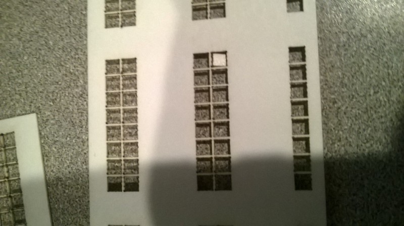

the fourth photo shows square cuts with "jagged"/"bumpy" lines. This situation happens for short squares like 2-5mm/side, but disappears when the boxes are longer, for example, 6mm/side or more.
Any ideas are greatly appreciated.

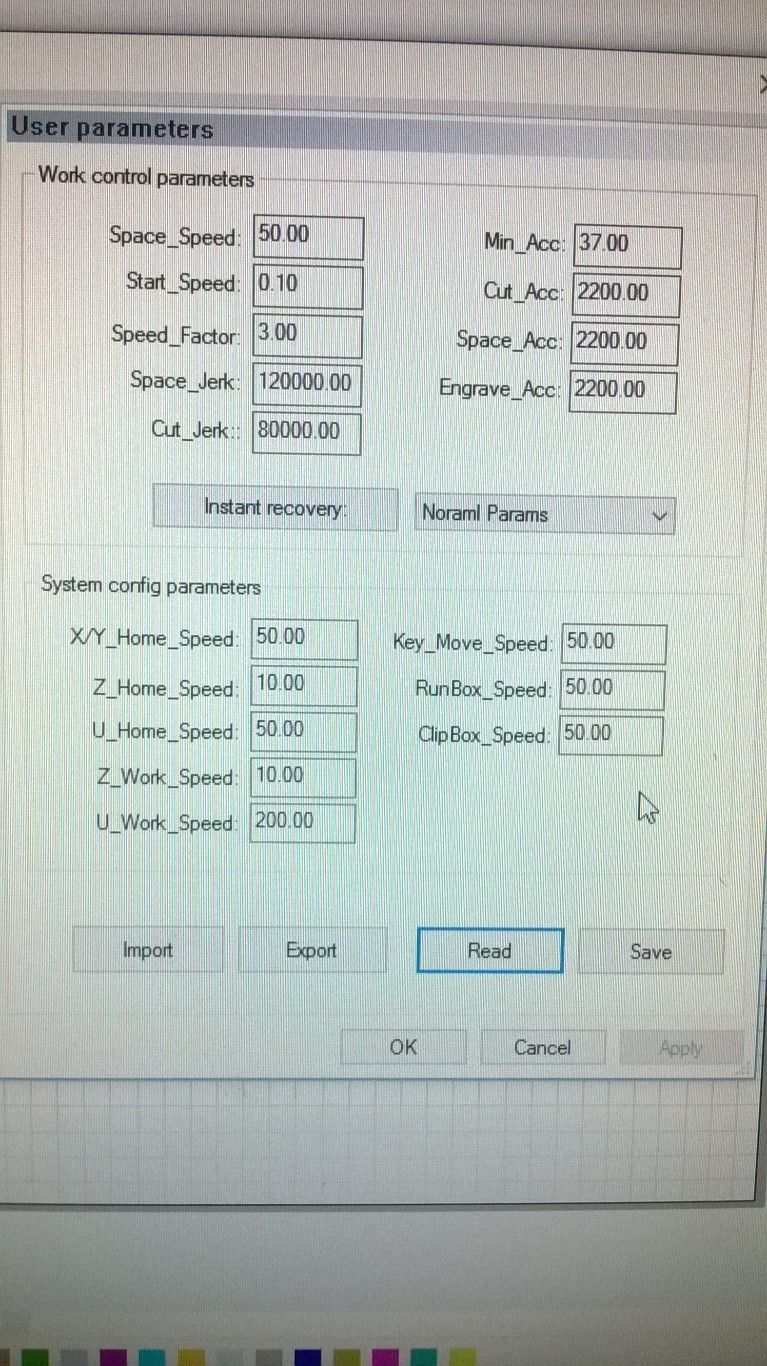

Want to see your "User parameters" as well

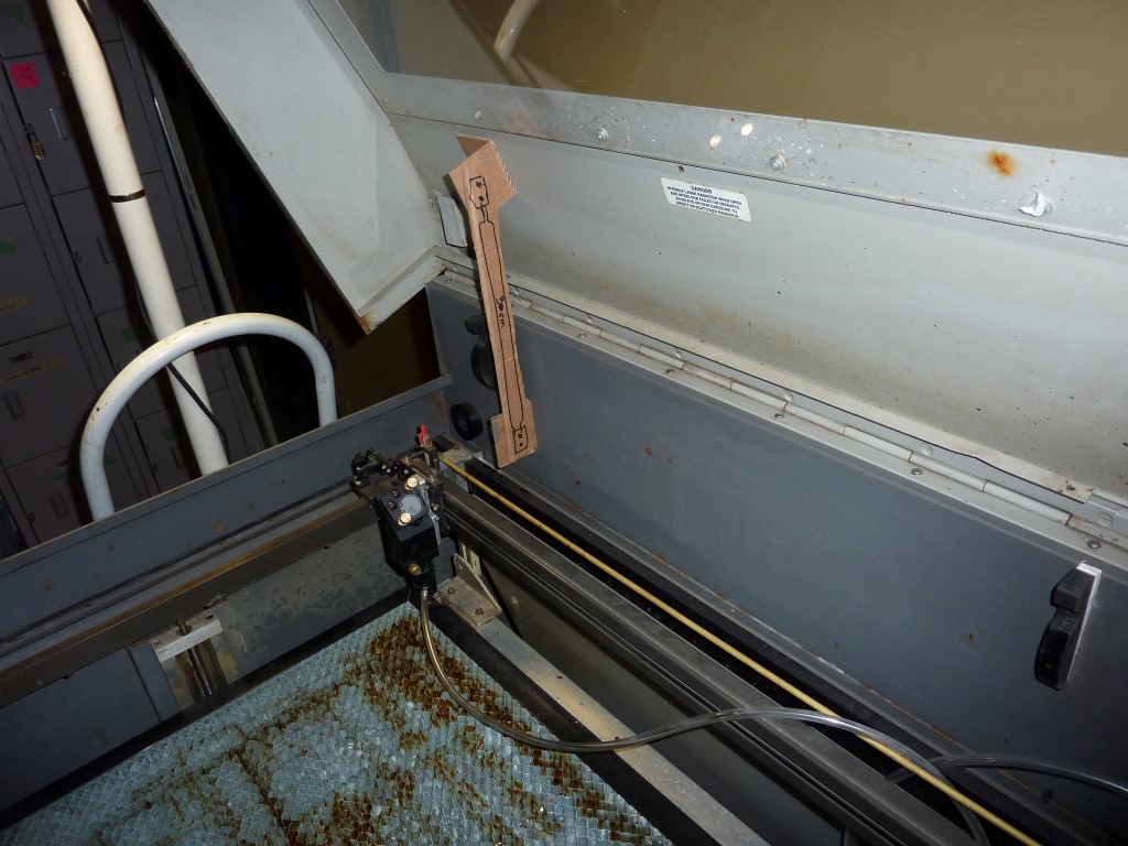

Post a picture of your gantry system

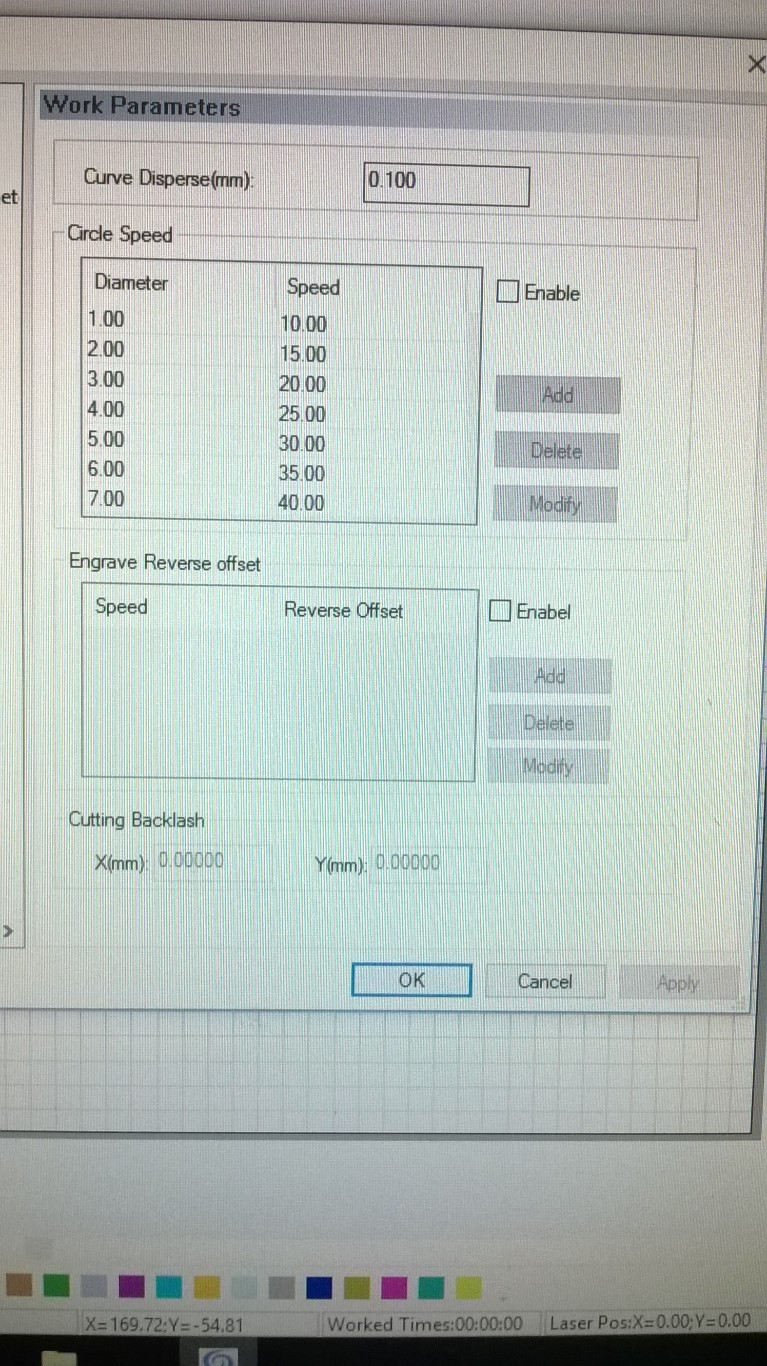

Post by Mike Teachman »
The cut speed was 50, but the issues happen at any cut speed.

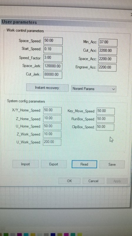

You asked for User Parameters - I took a screen shot of the User Parameters and attached in a photo in the previous post. Hopefully these are the User Parameters you are looking for, and you just missed the photo.
A photo of the gantry is attached.

Re: seeking help to solve X7 controller pause issue
Try this:

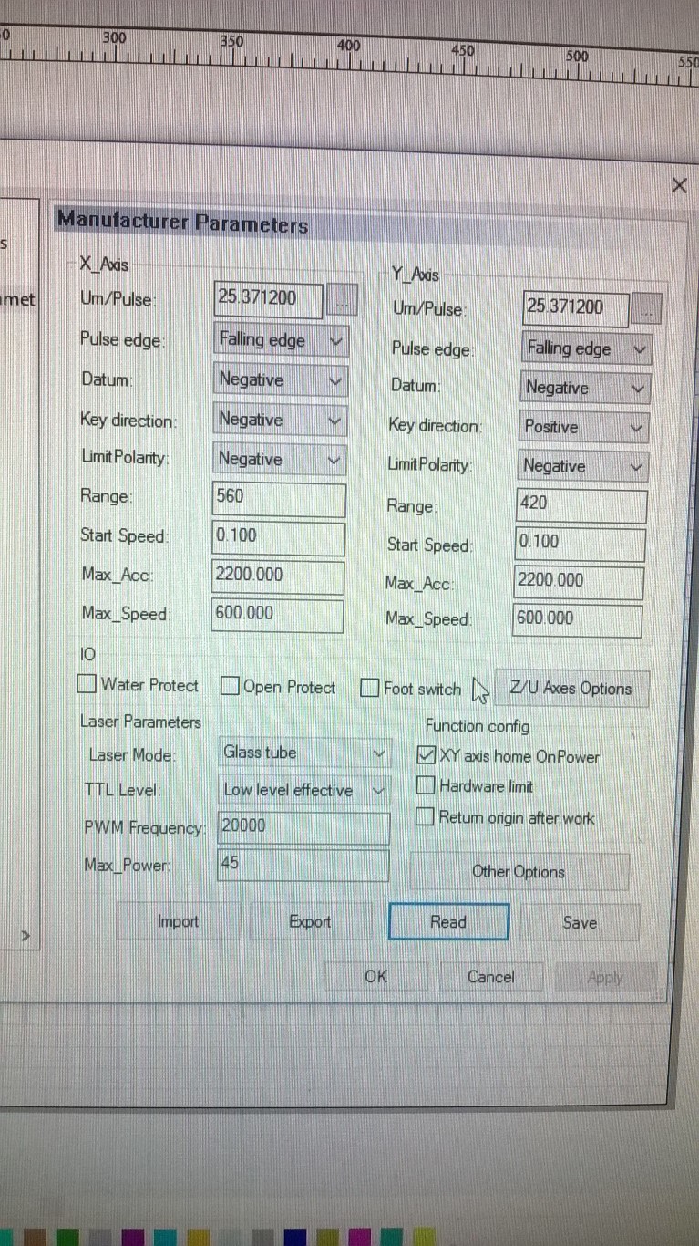

Manufacturer Setting:
- Start speed: 10m
- Max_Acc (X): 5000, Max_Acc(Y): 3000
-Max_Speed (x): 600, Max_Speed(Y) 400
User parameters:
Space_Speed: 100
Start_Speed: 10
Speed_Factor: 1
Space_Jerk: 30000
Cut_Jerk: 20000
Min_Acc: 100
Cut_Acc: 2000
Space_Acc: 2000
Engrave_Acc: 3000
Home_Speed: 80
Z Home Speed: 5
Key_move: 200
RunBox_Speed: 200
ClipBox_Speed: 100
Give it a try!
By the way, you may need to lubricate the guide, motor, and bearing. Also, belt tension need to be adjusted as well

I was able to try some of the settings you recommended. Unfortunately I did not see any difference in the cutting performance. The controller continued to pause and we still see a ragged cut line for short lines.
notes:
- the laser controller would not accept some of the setting changes. For example, the recommended Max_Acc value of 3000 was not accepted by our LO-X7 - the max value I could enter was 2200. I tried making the change both in the software (making sure to Read from the controller as a first step), and with the controller keypad.

You couldn't get acceleration over 2200 because you put the limit on the mac parameters under manufacturer parameters setup

ah ... I think I get it. The issue is the order I used to apply the new settings. I need to adjust the manufacturers setting first, and then User setting.
