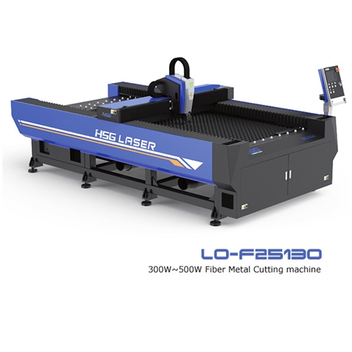

Belt driven:
Belt driven fiber laser machine is similar to a regular CO2 laser machine but with a dynamic auto focus laser head system. So, the whole laser head attachment move up or down freely to a fixed focus point against an object being cut. Because of belt elastic, a minor offset error could happen.
Estimated Price
300W: $50,000 ~ $55,000
Cut: 3mm steel, 1.5mm stainless steal, 0.8mm aluminum
500W: $62,000 ~ $75,000
Cut: 4mm steel, 2mm stainless steal, 1mm aluminum

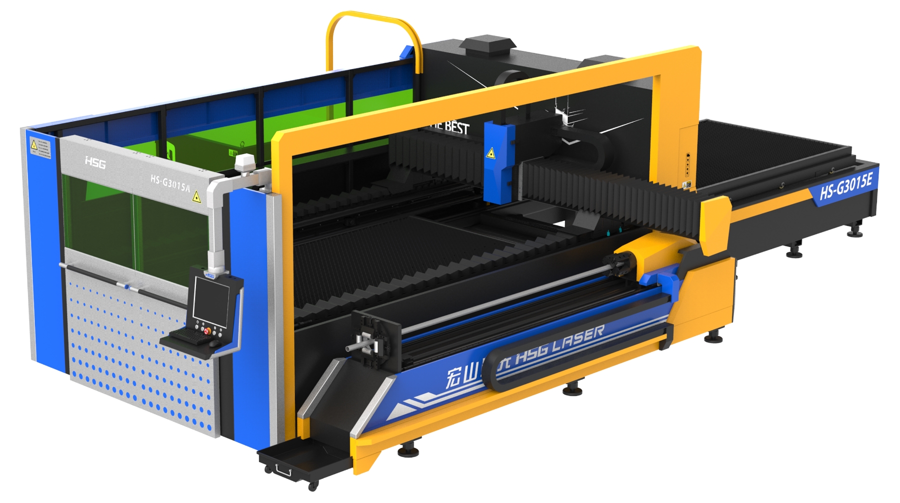

Installing a belt driven fiber laser is pretty easy because the size of that is usually limited to 2500x1300 or smaller.
Plus, the requirement for smaller laser is much less than a 700W or bigger fiber laser. Leveling is an extremely important for a Gear driven fiber laser machine because of the heavy weigh gantry and imbalance means stress over the bearing. Beside that, there is linear guide/rack could wear out quick if leveling is not being fine tuned. Trust me, to level a G3015 machine is not easy! The weight of the 3015 is way over 9000lb so level jack is required and two level gauge is needed. If the unit is coming with housing and/or material loader (double power bed), things are more complicated during installation
