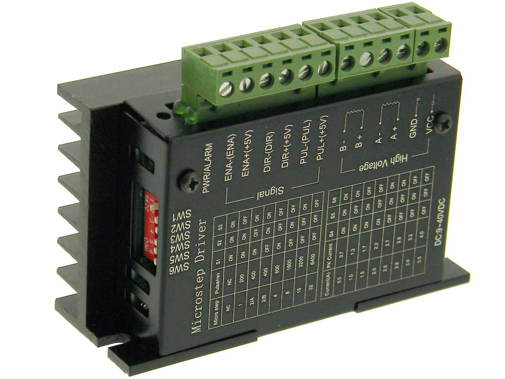

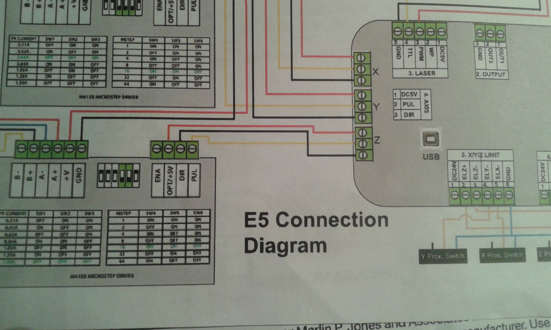

Marco: I am just about done with the wiring of the E5 DSP controller to upgrade the K40 Laser Cutter. I am using different Mircostep Drivers than the ones shown on the wiring diagram for the E5 DSP upgrade. I want to make sure that I have the wires going from the E5 to the Mircostep drivers in the right place. This is the Microstep driver I am using.
The Wiring diagram for the E5 shows the three wires DC5V, PUL and Dir on the E5 going to opt/+5v, Dir and Pul on the Mircostep driver and the ENA is not used.

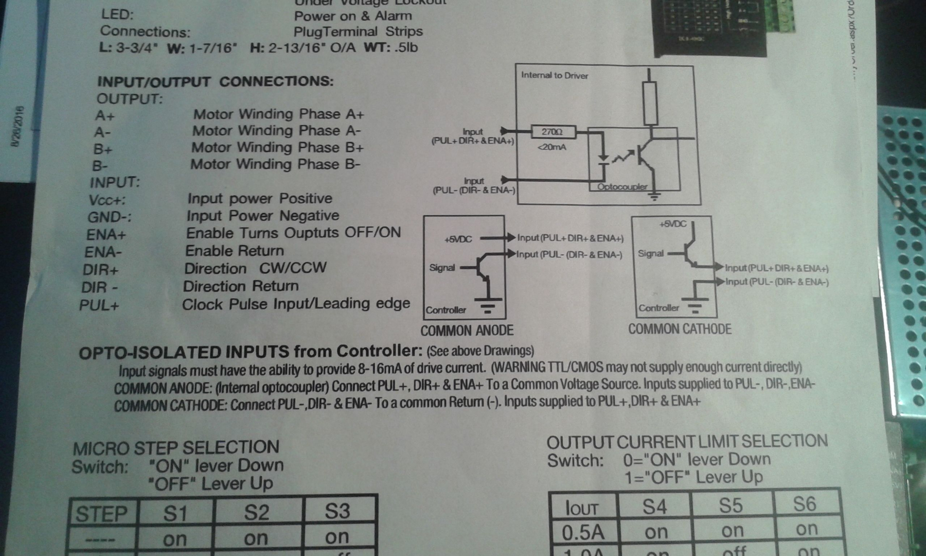

However the Microstep drivers I am using have a + and - for the PUL, DIR and ENA I currently have the wires connected to the +PUL, +DIR and +ENA. Is this the correct place to have these wires connected or do I need to use the -PUL, -DIR and -ENA terminals. Here is the data sheet for these Mircostep drivers.

You should select the micro-stepping to '16' (or 3200) which ended up S1 S2 S3 in "Off Off On" respectively
For the K40 in general, I'll set the X current to 0.5A and Y current to 1.0A
Ignore the EN+ or EN-, no connection needed.

Marco: what do I do with the +5V connection on the E5 then. I currently have the PUL going to the +5 PUL and the DIR going to the +5DIR and the +5V going to the +5ENA on the Micro Step Driver. So I can just leave off the +5v wire all together and only use 2 wires instead of 3?

The DC5V on the E5 is connected to both the PUL+ and DIR+ on the driver. The PUL on E5 is connected to the PUL- on the driver, whereas DIR on E5 is connected to DIR- on the driver. Just ignore ENA+ and ENA- at the driver for now.
