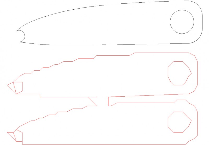

Most of my desire for this machine is cutting. I cut balsa wood and some lite ply. I use CAD to make my files and import them into LC (which is really a graphic program, not CAD BTW). How do I get the parts to come in at 100% size? Also, I noticed LC was adding lines and "interpreting" the drawings incorrectly. I design ribs and parts that go in aircraft and the parts have nibs, (some of the line missing so the parts will stay on the sheet after cutting.) It's taking some of the lines and attaching them to the part above. On other drawings, it's actually adding lines to the rib file. I couldn't find a way to make the parts have nodes so I could correct the file before cutting.
The black rib is what was imported. The red ribs are what I got. Disregard the straightening of the lines in the photo. It comes in smooth like the correct part but you can see it's added lines to the leading edge and attached itself to the rib above.
Any ideas how to solve these issues?

I don't use AutoCAD, I use Corel however I had similar issues, So I found that if you have guide lines it will give problems, If you use text, convert the text to curves and then use the Weld command before exporting to LaserCAD.
So in your cad design, just before you export, delete any guide lines, convert everything to curves and see if that helps.

AutoCAD usually works in imperial (unless you set it otherwise), while LaserCAD is exclusively millimeters.
Convert all of your fonts to vectors using Express->Text->Explode. (I usually keep my raster fonts on a "text" layer, then using _copytolayer to copy them to a "vector text" layer, then convert that layer. It's nigh impossible to edit the text once it's converted. The raster text will be ignored by LaserCAD")
Make sure to run overkill to remove overlapping lines
Then do the scaling by 25.4.
I keep my drawings in imperial for convenience, the scale each time before downloading.
Hope this helps,
Joe
