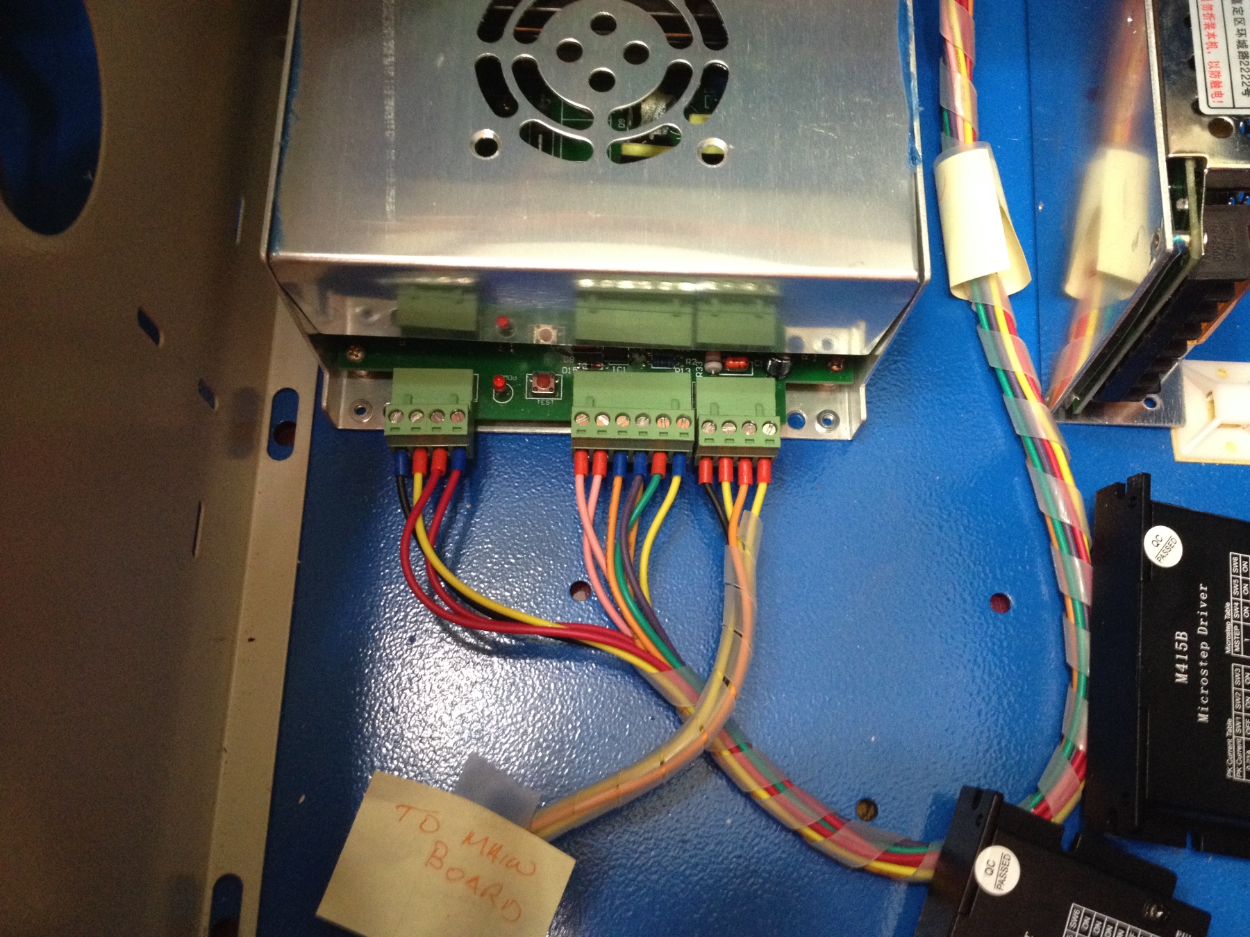

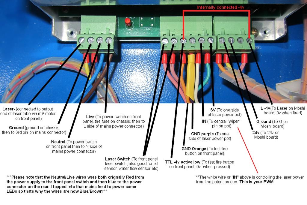

I have the PSU below. I need to know what the hook ups are so I can follow the wiring diagram. Any help is greatly appreciated. I also need help with the 12-wire Y axis drive motor wiring.
Wiring help needed BADLY! Has anyone wired one of these PSU's?

Re: Wiring help needed BADLY! Has anyone wired one of these PSU's?
Using Google and typing "HV Supply K40" gave me this picture:

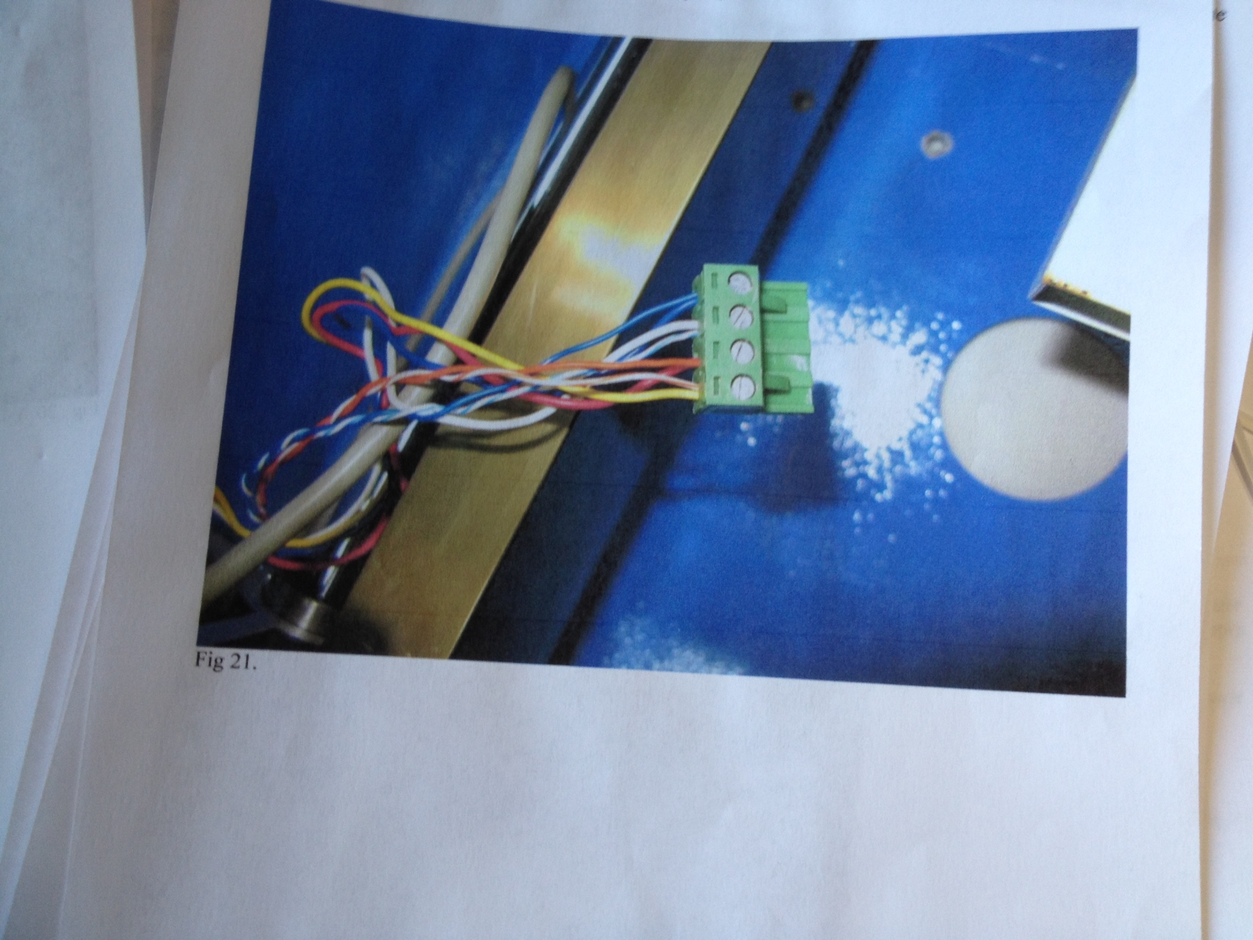

For the motor wiring: what is the motortype? 12 wires on one motor is not very common, i've seen them with 4, 6 and 8 wires but not 12, yet..

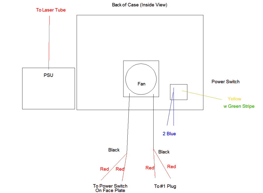

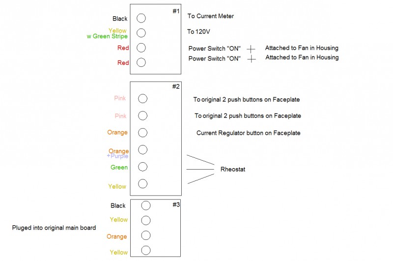

Attached are 2 drawing showing where each wire goes in the current setup for the Moshi Board. I really appreciate the help.
Now I need to know where to hook them up to the X7 board upgrade.
As for the motor wiring, the instructions show using a 6 pin plug with multiple wires attached. If I just need to cut and attach the 4 wires to the drivers then that's no problem. looking at their photo in the instruction manual, it left me with the thought I needed all 12 wires addressed.

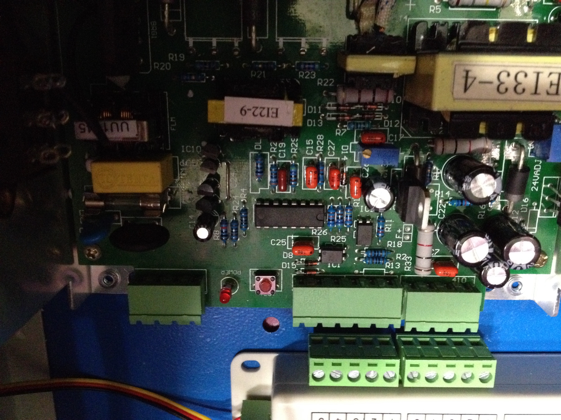

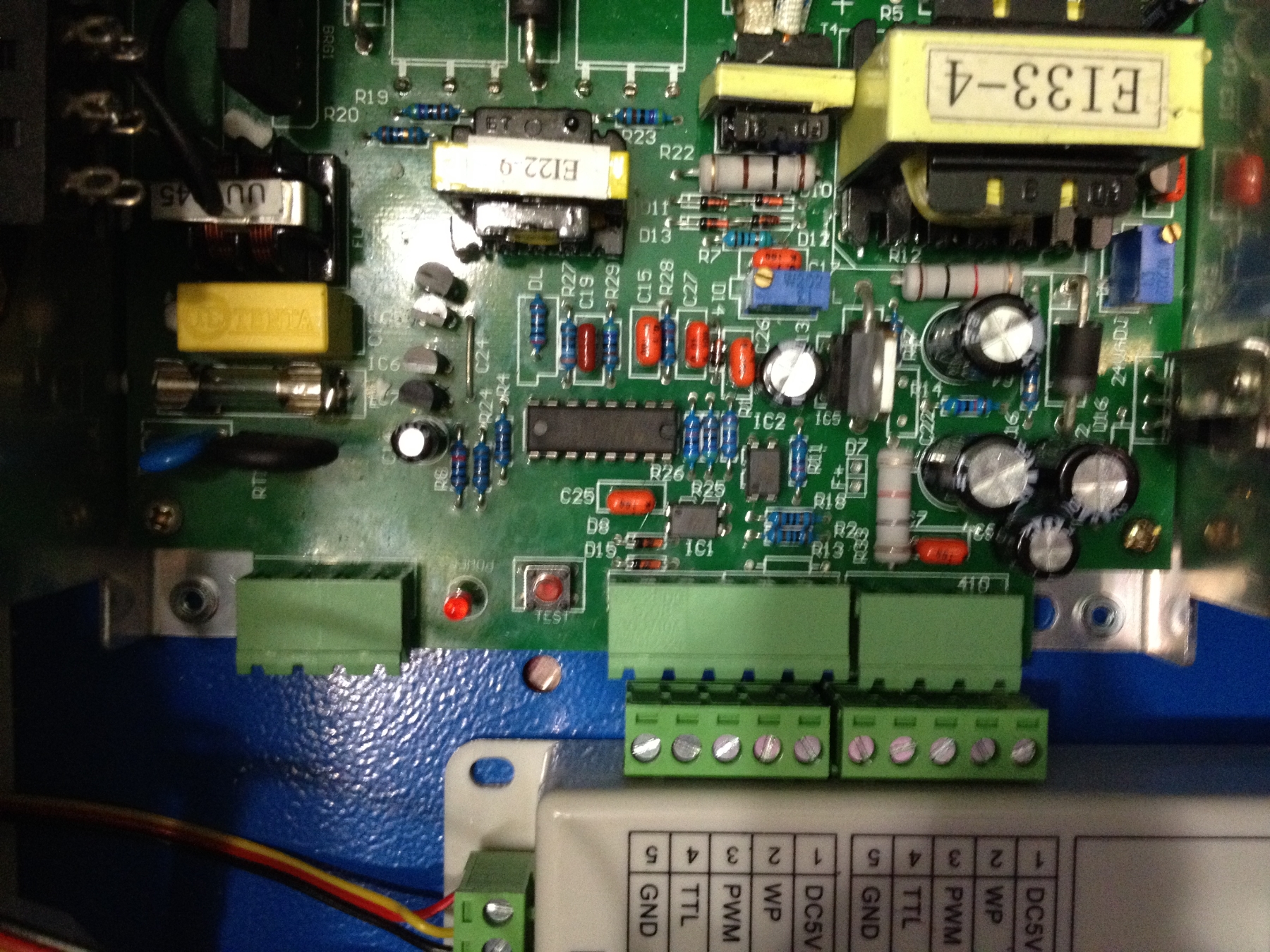

May be you should take a picture of the PC board from the PSU and show the legend mark. It should print something like this on the PCB board: TH, TL, WP, Gnd, IN, 24V, 5V....
You don't want to 'guess' when making the connection to the DSP because by making a wrong connection, it could lead to a brutal consequence (very odd). A while ago a folk got the DSP blew off and I really don't want to see that happen.
Here are the photos. I didn't see anything that was labeled like you mention. Maybe it's labeled under the plug in housing, I don't know. That's why I'm having such an issue. That's also why I make a map showing where the wires to the plug goes in hopes you could back trace them and come up with the answer. Does the photo in the above post help any?
Next, on the photo in the instructions showing the X axis 4 lug cable connector that there are a # of extra leads coming out. I don't understand where the extra wires come from or where they go to. Since this is a basic machine, i.e. no Z or U or anything else, can I just hook up the 4 wires like I did on the Y axis?
Lin got me hooked up with this discussion: viewtopic.php?f=70&t=2684&p=12809&hilit=moshi#p12805 and as you can see it has the same PSU so I'm off to finish wiring! Thanks so much guys.
Thanks to LO and wadz222 (without who's help I'd still be fiddling with the machine) I'm done with the upgrade. I'm adding 4ea 5V terminals, one for the laser pointer and 3 extra and a larger, more robust 24-5V converter per wadz222's recommendation. He provided a wiring diagram for my PSU and that got me over the hump as they say. Anyway, I know what/how to wire this type PSU and if someone else has questions about a build using this PSU, I can probably answer them. Now it's getting used to the software.
