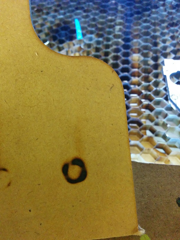

I have been having issues with my laser for the last couple weeks. I cant tell if its my Tube or PSU. I replaced the PSU in hopes that it would be the culprit but I am still having issues and Im guessing I need a new tube which sucks. My tube is about 17months old according to the date on it and probably has about 50 hours of cut time.

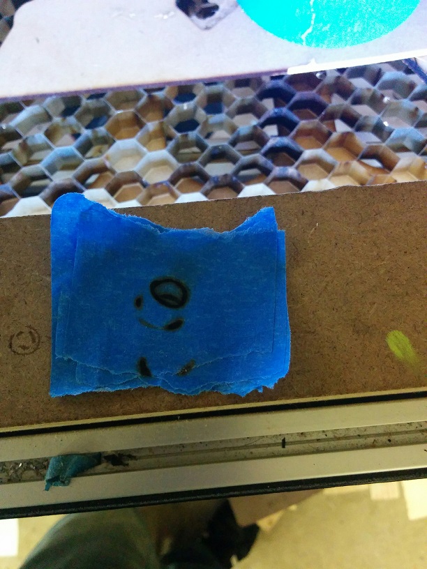

I get some cut power but not really much at all at 25ma. I cant even get through 1/8" MDF. The pictures are of Unfocused Beam spots the one on the MDF is about a half in wide which is about double what it used to be. On the blue tape the full "circle" is on the first mirror. The partial is on the second mirror.

It looks like to me that the tube is dying. With a 100W laser tube running at 25mA, I believe that we could cut through 1/8" MDF at speed of 20mm/s.
There are four major factors that affect a laser tube the most: how old of the tube, how many work hours applied to the tube, water temperature, and current applied to the tube. Most laser manufacturers offer 6~9months or 2~3000hrs working hrs. To me, the working hours is insignificant because there is only 1,728hrs in six months if the laser is running 12hrs per day.

Seen from the shape, i would say that one, or both of the "mirrors" inside the tube is broken or even loose.. I have seen simmilar effects with cracked mirrors.
IMHO you can better set your cooling temperature as low as 20 degrees Celcius max. Keep in mind that the temperature at the hottest spot can exceed the temperature that will melt the glue.
I run my tube at 15 degrees but my workshop's temperature almost never raises above 18 degrees in summer.. so condensation or thermal stress is not the case..
What i understood from some lasermanufacturers is that there are a few kinds of gasses in the tube that interact and will form an unusable gass in time so a tube stored for a few years can be almost dead without ever been used, even if there was no leakage.
This is definitely the tube that needs replacement. A good tube gives a dot with the most energy in the middle, diameter approx. 4-5mm for 60-100W. 40W tubes give a somewhat smaller dot, about 3mm
