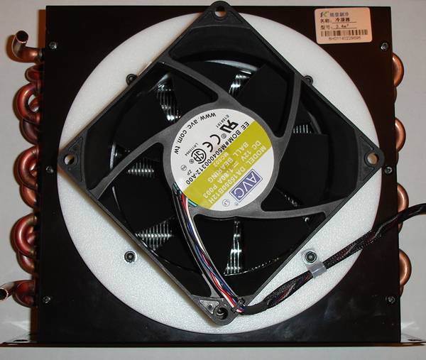

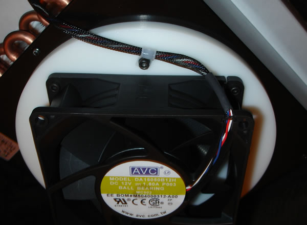

Hello,
I just wanted to add my experience with the same fan and radiator. I had to make an adapter in order to mount the fan to the radiator. The bolt patterns are different. Here's two photos showing what I did.
The fan is great, it really pulls the air through the radiator. I was also recommended to use the 12v water pump ( http://www.lightobject.com/10Lmin-158GP ... -P511.aspx ) and use the larger silicon hose ( LSR-WTUBE8X12 ). The combination is perfect and it showed how poor the performance of the "Power Head" aquarium pump that came with my machine was.
-Tim
