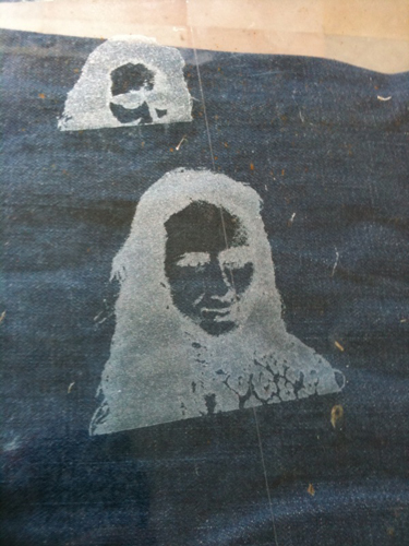

Here is my todays result in attachment, engraved on dirty glass.
I don't like it.

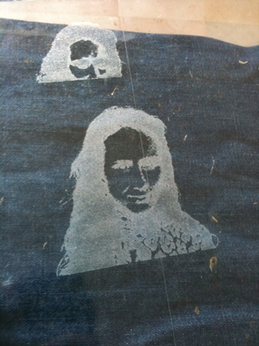

Re: DSP question
It's actually pretty hard to engrave on glass.
You need to reduce your dots per inch to something like 150 and make sure you have your laser focused really well.
The laser blows little pieces of the glass away from the surface so you won't get a very good engraving. Try 15 watts at 4" per sec and 150 dots per inch.
Now if you engrave the back of a mirror then that is different and a little bit easier.
You can do this at 300 dots per inch (2" focal length lens) and 100% power and 3" per sec speed. PhotoGrav does a good job at converting the picture to mono 1 bit if you can afford it.
Then paint the back of the mirror to bring out the picture. Black paint works well for this. Don't forget to invert the picture as you will be looking at it from the other side.
If you get very small horizontal lines in the engraving then you need to increase your dots per inch to about 340 or there-a-bouts.
Let me know how you get on.
