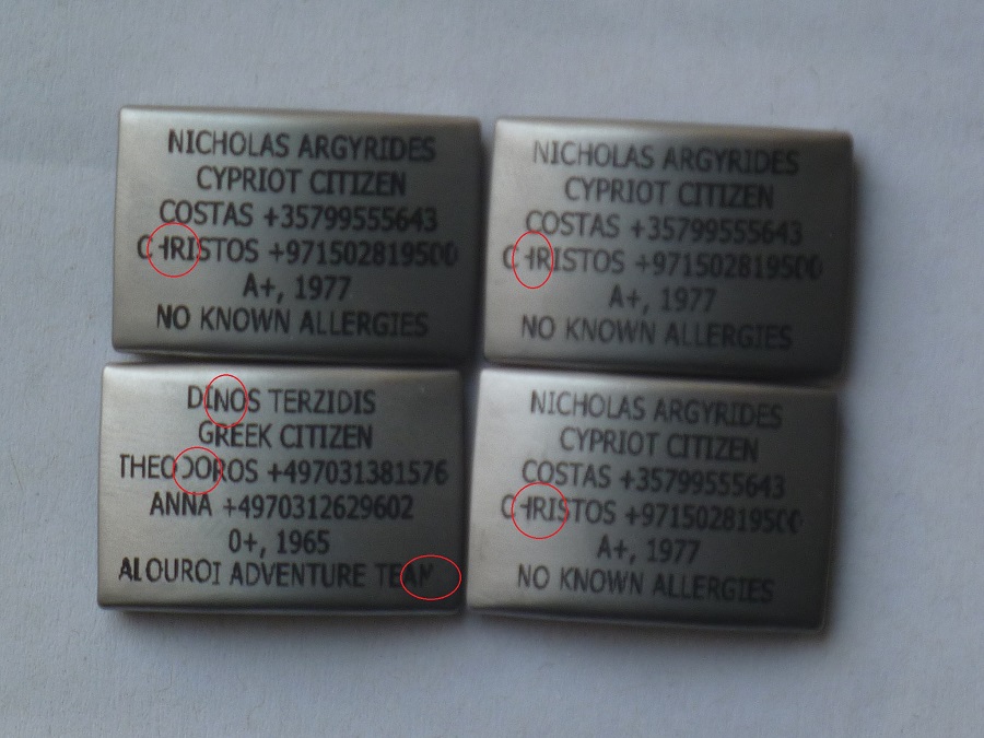

My problem is that the engraving quality is very low and in many cases the letters are not complete (as you can see in the photo, parts of the letters are missing and sometmes the words are not in the same line). I did several tests with different speeds and positions and I didn't managed to fix the problem. To my understanding the problem comes from the SW and not the machine.
The settings I use are:
-Cermark as a Laser Marking Ink
-Current Indication 20mA
-Engraving Power 100%
-Engraving Speed 1 cm/s
So, my question is, if the upgrade to DSP will help me to not have such issues.

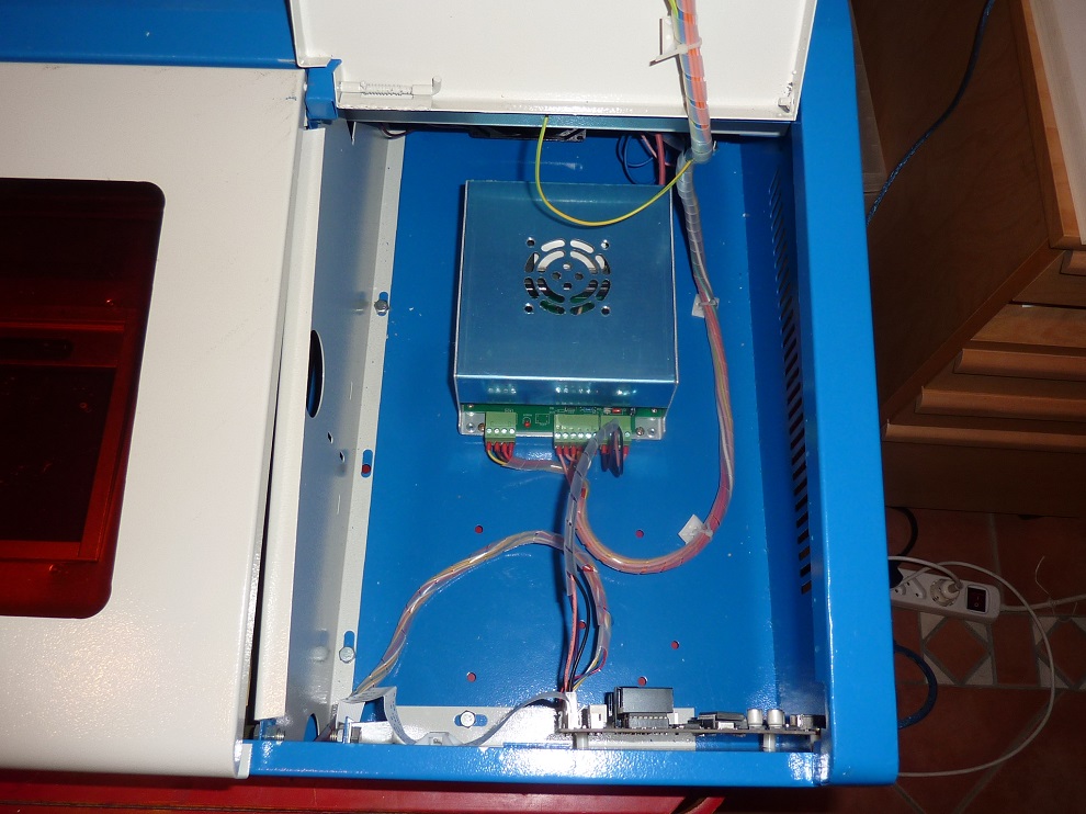

PS: I have attached the photo of my Power Supply, in order someone to see if I need to change it as well when I do the DSP uprade
Re: K40 for engraving - Need to upgrade to DSP?
It is considered a simple task withthe DSP card. No such headache at all and you can do more than that
By the way, limit the current to 16ma because 20mA is too much for the small tube

I upgraded my K40 to DSP a little over a year ago and have never looked back. You have made the right choice. You also need to get a pulse width modulator power supply, if you K40 doesn't have one.
I also engrave steel tags, and do it for a living now, all with the K40!
I use Thermark LMM14 on steel. The settings I use are:
Speed: 20
Power: 55
Scan Gap: 0.04
X Swing
Laser PPI: 1200
I always get an excellent black finish with these settings and LMM14. All the best with it!
