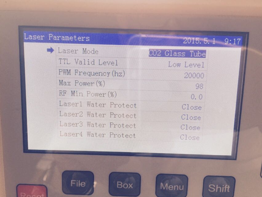

Re: Water Protect broken in LaserCad for LO-X7?
Under Laser parameters, it shows Laser1..2...3...Water Protection
Not sure why couldn't you locate it
I'll look specifically for that when I get home tonight.Tech_Marco wrote:Under Laser parameters, it shows Laser1..2...3...Water Protection
Not sure why couldn't you locate it![]()
Why I haven't seen it? Not sure until I look again tonight.
Thank you, Marco. I appreciate the explicit description of what to look for.

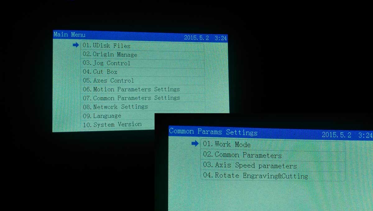

We are talking about the X7 right? Mine does not have a laser parameters in the menu. It also is not under "common parameters". Picture attached.Tech_Marco wrote:Under Laser parameters, it shows Laser1..2...3...Water Protection
+1
I looked for about 10 minutes through every menu I could get to, and found nothing. Maybe we need to do a Firmware update. I'm running Version 1.14.12.22

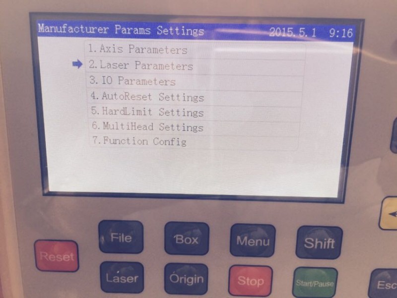

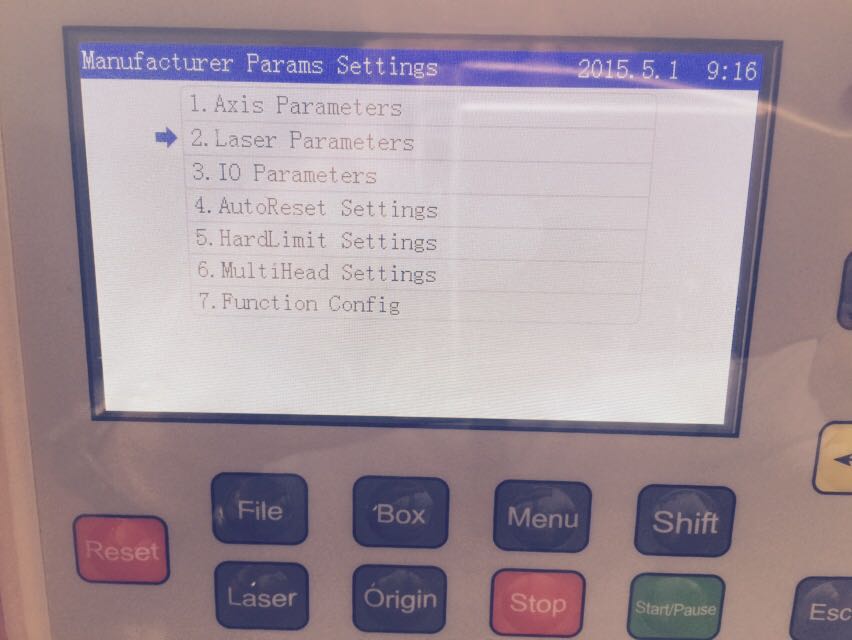

Late discovery!
Press "Stop" + "Shift" to enter the Manufacturer parameters setup manual
So sorry for the inconvenience that it may caused
Tech_Marco wrote:Late discovery!
Yes! This secret key combination is confirmed, it lets you alter all of the manufacturer settings normally set in the LaserCAD program. I set them to "open" and reset and the option seems to stay set.
Yes yes yes! There it us! Thanks, Marco.
