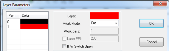

I upgraded from v7.36 to v7.43 and now unable to select PPI and Work Passes. They are grayed out in v7.43. Anyone else having this issue?

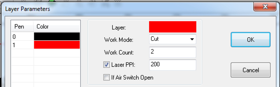

Find the "SoftCfg.ini"
Change the line "IfEnbleCountAndPPI=0" to read 1
Do this while LaserCad is not running.

Another thing to be aware of is that because of the way the installer is set up, many LaserCad/CorelDraw users will have two separate installations of LaserCad.
One where the stand alone program was installed (often C:\Program Files) and another in the CorelDraw/Programs directory. Not sure if this is also the case with Autocad and Illustrator.
If this is you and you want to make changes to the ini file, then make sure you change both instances. Or things can become confusing.
To my mind much better to only have one instance installed. In my case that is in the CorelDraw/Programs directory.
Just put a shortcut to the program in that directory, wherever suits your normal usage practice. (taskbar for me)
