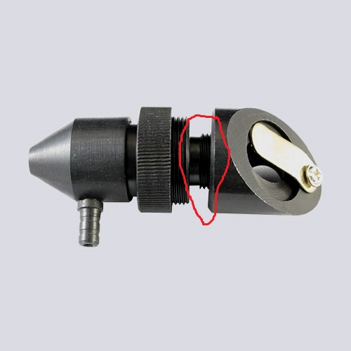

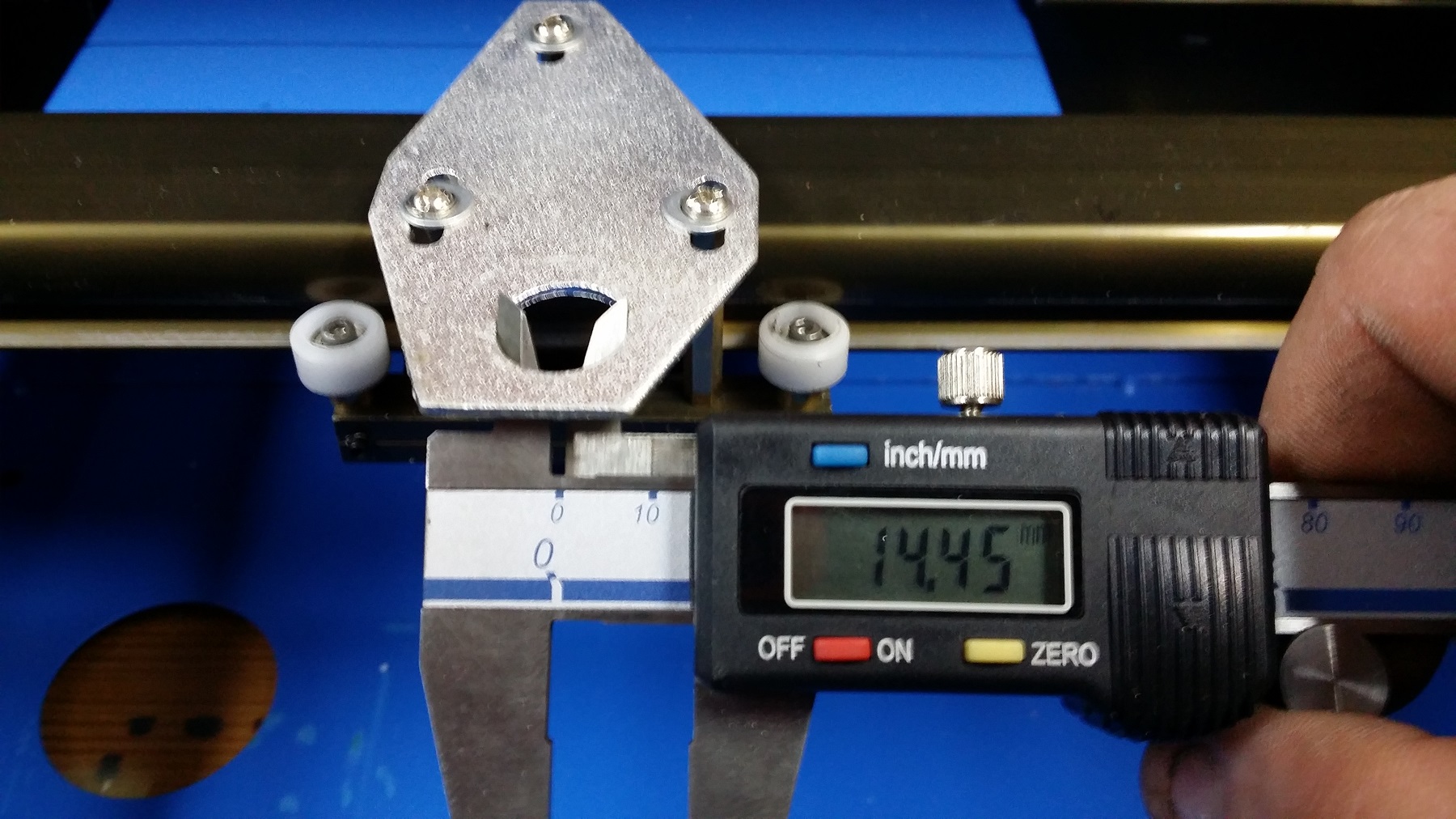

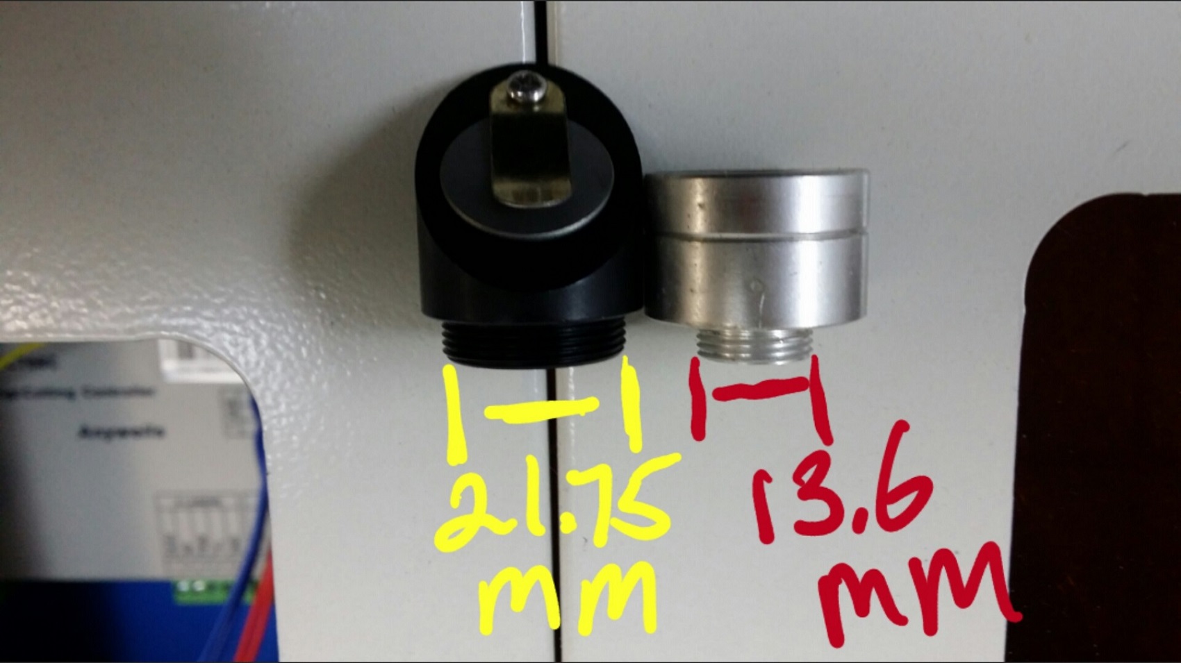

Just got my LO-X7 upgrade kit yesterday..And it is going in one the 40w Ebay lasers..First snag i have noticed is the plate that holds the laser head has a much smaller hole than the head that came with the kit......Is this something i can just enlarge?....Second snag is my Focus lens is only 12mm and doesnt fit into the laser head very well......Im sure there will be many more snags to come in the future but i am only just getting started.....

I believe you missed the other part not showing on the picture. The laser head (ours) came with 3 different parts and can be disassemble. The part you're showing wasn't for the mounting plate.

I do not see a way for it to work, Can you please tell me which parts go through the mounting plate? The only way i see it to be securely mounted is with the 2 parts on the right.....Tech_Marco wrote:Hey Mike:

I'm going from memory here... I don't have the head at hand...
Doesn't the rightmost part in your picture actually disassemble into two parts? I think I remember the threaded section actually being a collar threaded onto a smaller threaded section inside.

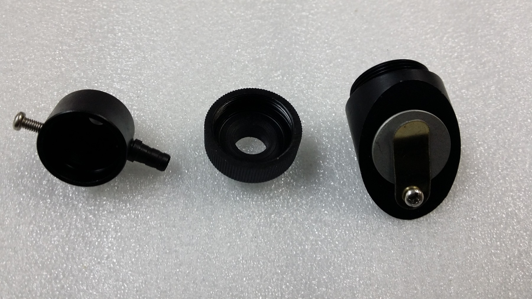

acuralegendz
- Posts: 18
- Joined: Thu Oct 30, 2014 9:11 am
Re: Laser Head question
Eureka, thats the part that goes through the hole!!!

Don't feel bad. It took me a little bit to figure out that last section unscrewed also. The way it works you can leave the top section with the 45 degree mirror in it attached and in alignment and you can remove just the bottom section when you need to change lenses.
Hoping one of these days Marco makes us one with a quick change lens section. It is a little bit of a pain the way it is now. I would like to have my different lenses mounted in metal sections that go on with a quick quarter turn or something similar. Would like to get a dedicated bottom section with the air nozzle attached and lens mounted for each lens so the whole thing changes and I don't have to fiddle with the lens and take a chance of breaking it every time. This could also have different length air nozzles like the other new one to suit different focal length lenses.
