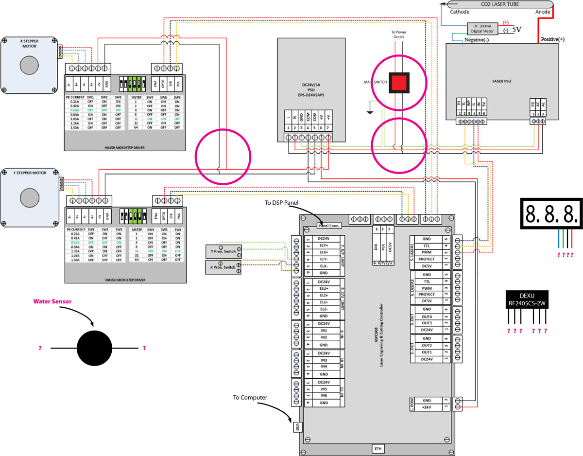

I'm having a similar issue and would appreciate some help as well. As for me, I'm running the DSP with the 40-60w laser power supply from LightObject and a fresh 45w tube. When I press the laser test fire button, the laser stays on until I turn off the machine.
I double checked all of my connections; they look fine and worked before my last tube cracked. All of my connections are per the wiring diagram here on the forums: http://lightobject.info/download/file.p ... &mode=view
Any help would be greatly appreciated.

@jgecik: Did you connect "TH" or "TL" on the power supply? Double check it as you may reversed TH and TL where TH = level high triggering and TL is level low triggering.

Thanks for your response. I double-checked all my connections. My set up had TTL on the DSP hooked up to TL on the power supply. I tried hooking TTL up to TH on the supply and trying out the laser test fire button, but I got the same result (laser remains on until I cut power).
Okay, here's something interesting: The laser cuts off when I hit the "Reset" button.
I also ran a test cut (a small circle in some MDF) and after the cut finished, the laser still remains on. My wiring set up is the same as it was before my last tube broke. Nothing's changed except the tube, so I'm not sure what could be going wrong.
Also interesting, I loaded the above test cut into the machine with a speed of 10mm/s, but the machine is cutting at around 50mm/s, which is the DSP readout's default speed setting. It also seemed to be cutting at 35% power, which was the readout's default power for the test button. It cut deeper after I bumped up the power on the readout to 98%. The cut instructions seemed not to load into the DSP correctly.
