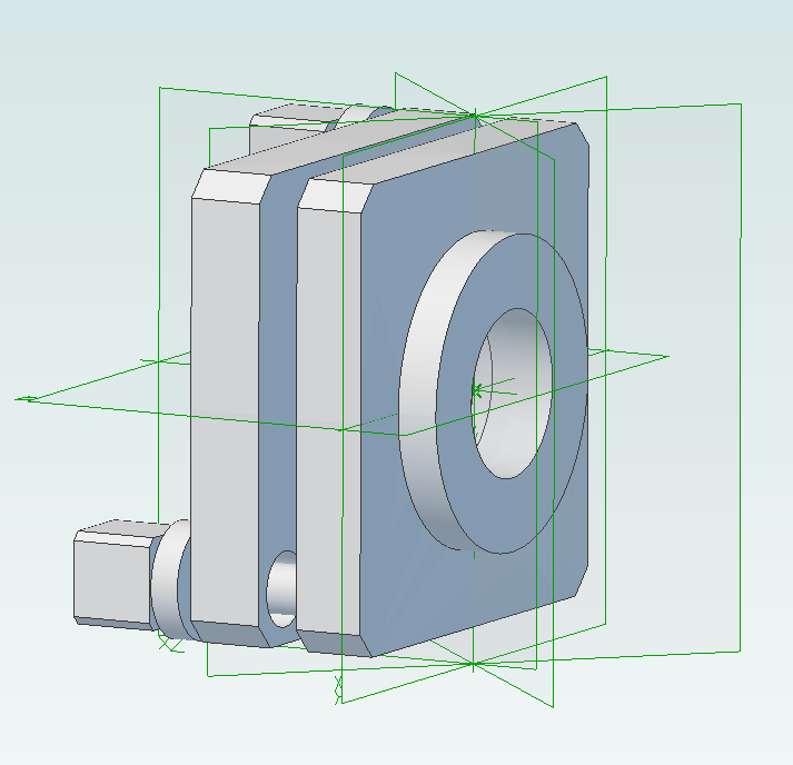

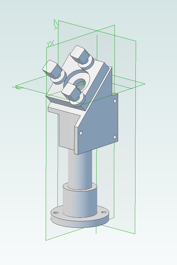

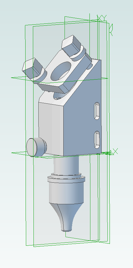

Screen shots of the parts below:
Mirror Assembly picture
Head assembly picture
Beam Combiner picture
