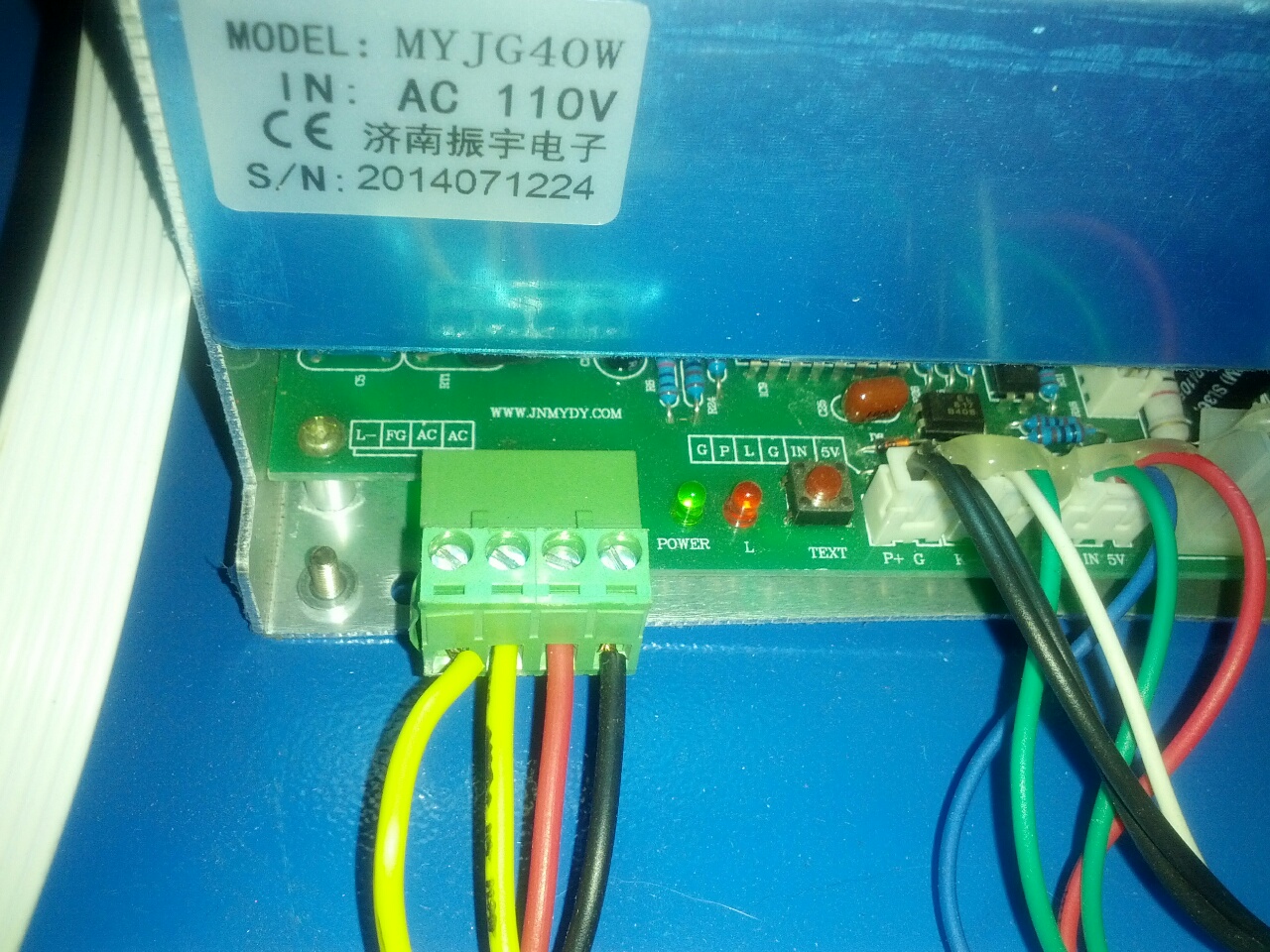

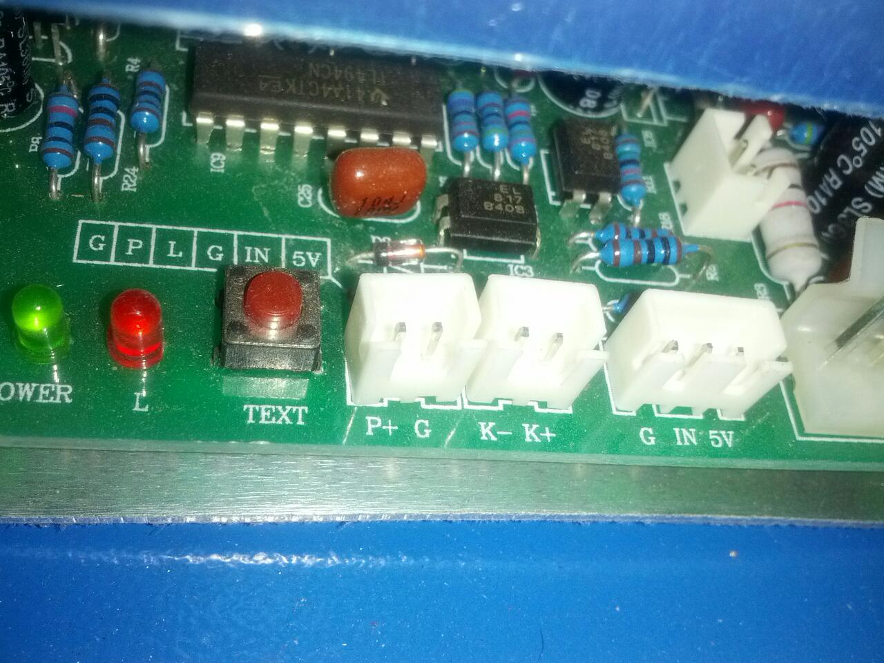

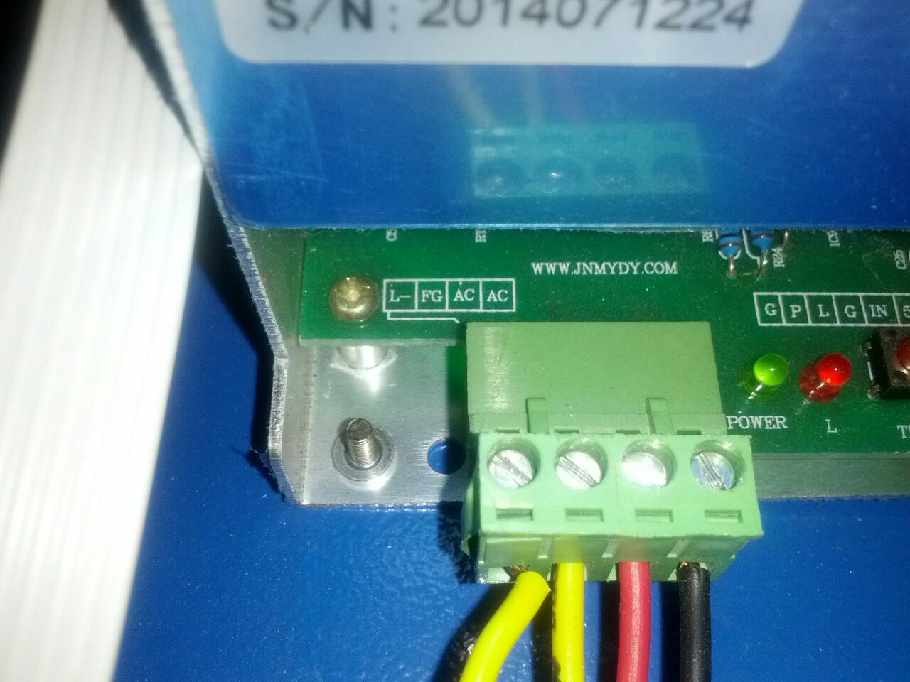

Ok here are the pics as promised (sry for delay it's been crazy here)
and here is the link to the MFG of the PSU
http://en.jnmydy.com/products_detail/&productId=22.html
It looks like it might have PWM (item 3 on the description)
But I can't tell if it has TTL
I will continue to look over the forums.
Please let me know if more pics are needed.
Thanks for any help in advance.

Hey Marco
Maybe we can help each other here. I have the PSU I have an old Fluke Meter (Basic things like AC DC Resistance and what not).
For TTL what am I looking for output voltages and so forth. (http://forum.allaboutcircuits.com/threa ... er.100211/)
For PWM what am I looking for output voltages and so forth. (not my video https://www.youtube.com/watch?v=z_7lG86CbLM)
Just let me know what to look for and if these link(s)/video look right.
(PS the red and black leads were reversed. I just placed them in position for the photo)
cheers!

Re: Purchased DSP - Do I need to purchase PSU too?
TTL - a form of output in modulation, as opposite to an analog output. Ideally it is ether 0V or 5V (In computer world, it is 0 and 1). For Positive logic, 0V = low (0), 5V = High (1). But in reality, we always used Level Low logic for controller for better false triggering caused by noise (electromagnetic causing). So, 0V is High and 5V is Low. Anyway, TTL signal is 0V/5V
PWM: Pulse Width Modulation
It is similar to the TTL, as signal is either 0V or 5V. However, the pulse width is adjustable from 0%(0V) to 100% (DC) call duty cycle. A square wave is 50%/50% or 50% OFF and 50% ON. The DSP control laser power by controlling the duty cycle
By controlling the % of duty cycle, a PWM circuit has a integral circuitry to sum up the the pulse and output voltage from 0V to 5V(ideally). So, at certain time, if PWM is 100%, the output is 5V. If it is 50%/50%, the output is 2.5V. The laser power supply output level is proportional to the voltage. 2.5V should get your roughly 50% power while 5V (100% cycle) give you a full power output.
TTL installed on the power supply is a gate operator. It enable the PSU and can take certain frequency from 0Hz to 10KHz. I believe that the PPI feature is having something to deal with it. There is TH and TL (Level High and Level Low). So, you either connect the TH to +5V or TL to Gnd(0V) to enable the PSU.
Anyway, the power supply that comes with K40 is a little different than the regular PWM PSU. But the concept is similar. The K+ K- or D+ D- is something similar to the TTL but may not support pulse input. So, it may not support PPI. Plus, if it is not PWM, while it may work but the quality may not be good as a PWM (detail wise), especially for engraving. I don't think there is much difference on cutting except for the PPI.
What I need to find out is the voltage level at K+/K- and the D+/D-. If it is TTL circuit, then highly chance the DSP can work with that. If it is not, then.... be careful. I blew mine when I connected my DSP to the non standard PSU. It didn't kill it right at the moment but may be a few hours of usage. When I said it blew my DSP, probably it damage the PWM output circuitry.
Not sure if it help. Again, without the stock PSU for testing, it is hard for me to make conclusion.

So far I have been able to determine that The PWM signal goes to the input marked "IN".
