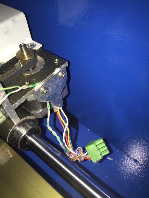

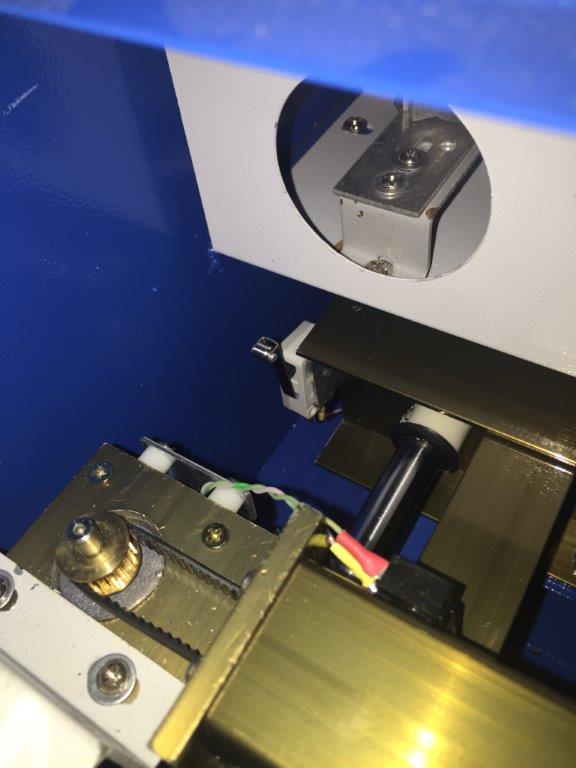

Okay, here are a couple photos of my situation:
I've slid the gantry back into the case. At this point the back edge is up on top of the "standoffs" that it'll bolt to, and the front edge is resting on the front lip of the cabinet. It's in as far as it will go as it is hitting the new limit switch (actually the bolt holding the limit switch) against the edge of the laser tube cage.
This is a close up of what's hitting. The right-most bolt on the limit switch is hitting the bottom of the laser tube cage. Even if I removed that screw, the switch itself would hit.
Once the gantry is in, looks like the switch and its bolts will slide under the laser cage... it's only because the gantry must go in at an angle until it gets past the front lip that is causing the problem.
Theoretically I could unbolt the floor of the laser cage and flex that up a bit to temporarily gain enough extra clearance go get the gantry back in, but I have to think I'm missing something as no one else seems to have had this problem.
Am I doing something wrong? Suggestions?

jeckardt wrote:Okay, here are a couple photos of my situation:

Kiwi53
Posts: 33
Joined: Tue Aug 05, 2014 8:13 pm
Re: Conversion snag
Post by Kiwi53 »
Hi jeckardt,
You will find that if you lift the exhaust vent up slightly then you be able to slip or manuver
the X-Y stage into position easierly. I found it was sticking like you mentioned an I just
lifted the exhaust vent up some an it almost fall into place. You'll have to use some force
to an a bit of jiggling to get it in, it would be easier to have the mirror removed for
ease of handling an have the X stage as far forward to the front of the machine.
Hope this helps.
Neil
ps: mark the washers on the mirror with a marker pen an also the allui edge, this
will make it easier to re aline the mirror.
