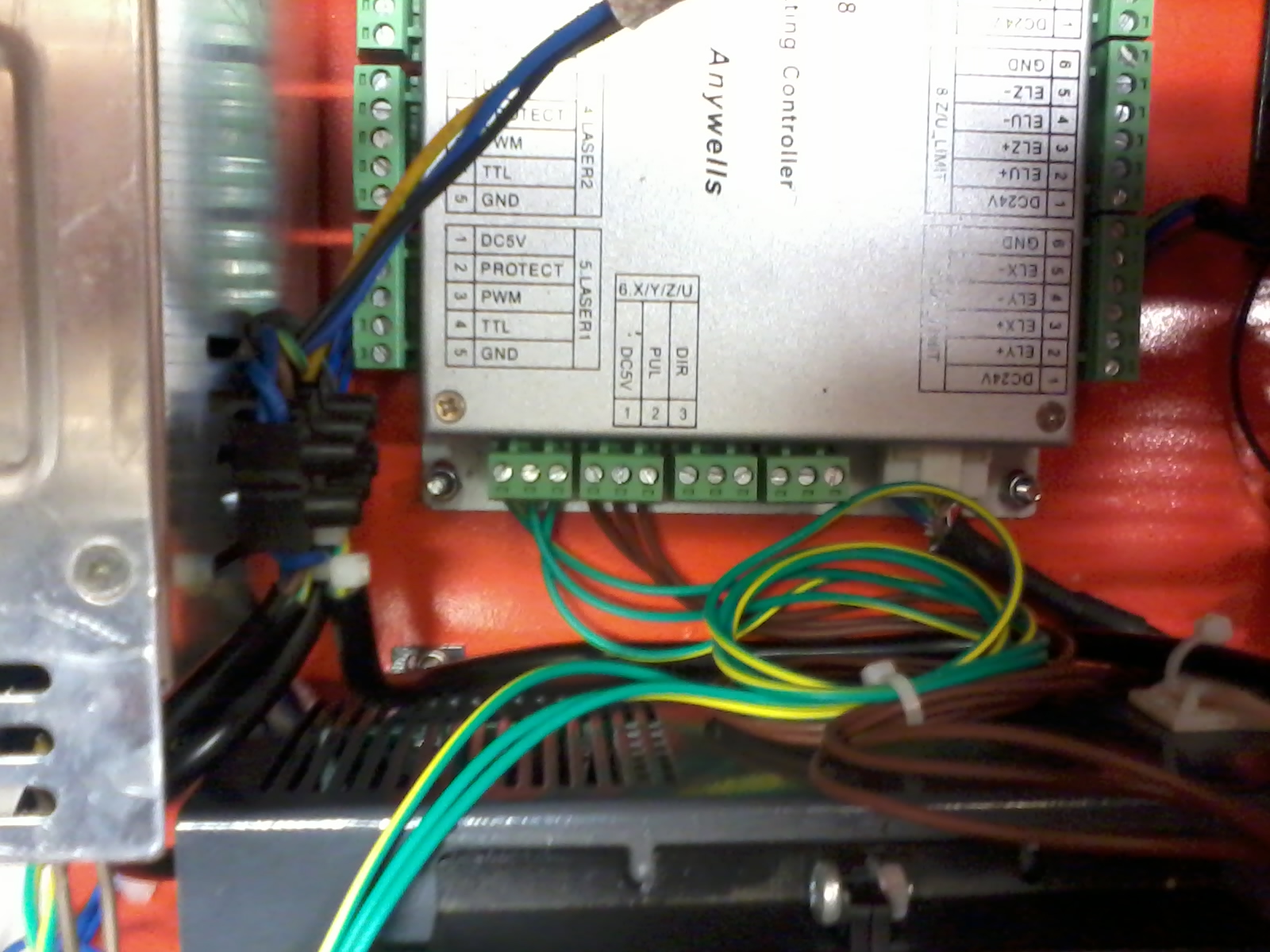

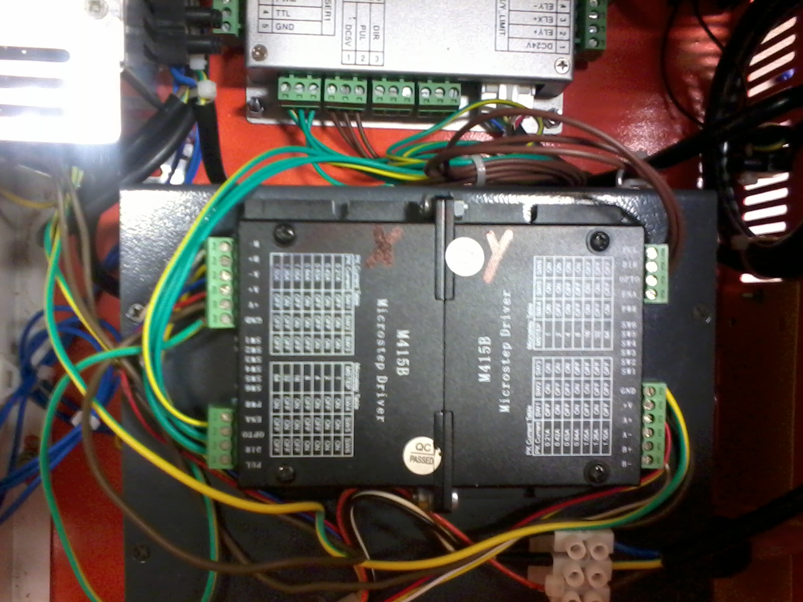

Hi,
I try to connect DSP to my mini laser engraver but have still problems with X axis. Everything looks well conected but if prees left on DSP LSC - laser head move to the right.
Please help
Check connection:

Reverse either the A+ and A- OR the B+ and B- (but not both) connections from the stepper driver.
