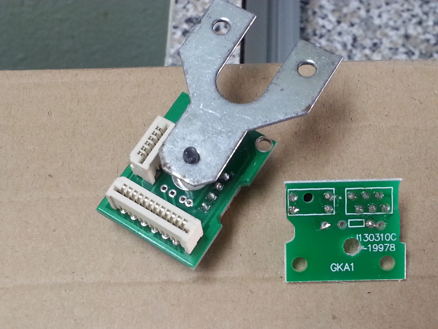

I got bunch of those sensor unused. I will post a picture and you let me know if it is right for you
If it is, then send me postage + $5 and I will mail you two

Re: I broke my K40 and can't find parts (sorry long post)
You are the man!
Let me know when/where the pic is posted, your contact info, and your Paypal info, and if it's the correct sensor I'll buy 4 of those things. You can never have enough spare parts lying around.

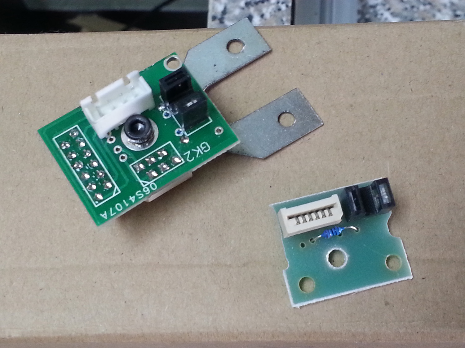

There are two home sensor: X & Y. Tell me which one you want. See picture
Note: it may not 100% compatible, so you may need to do minor modification.
The pin layout (flat cable) should be identical
The small one is what busted. I already ordered the sensor itself.
