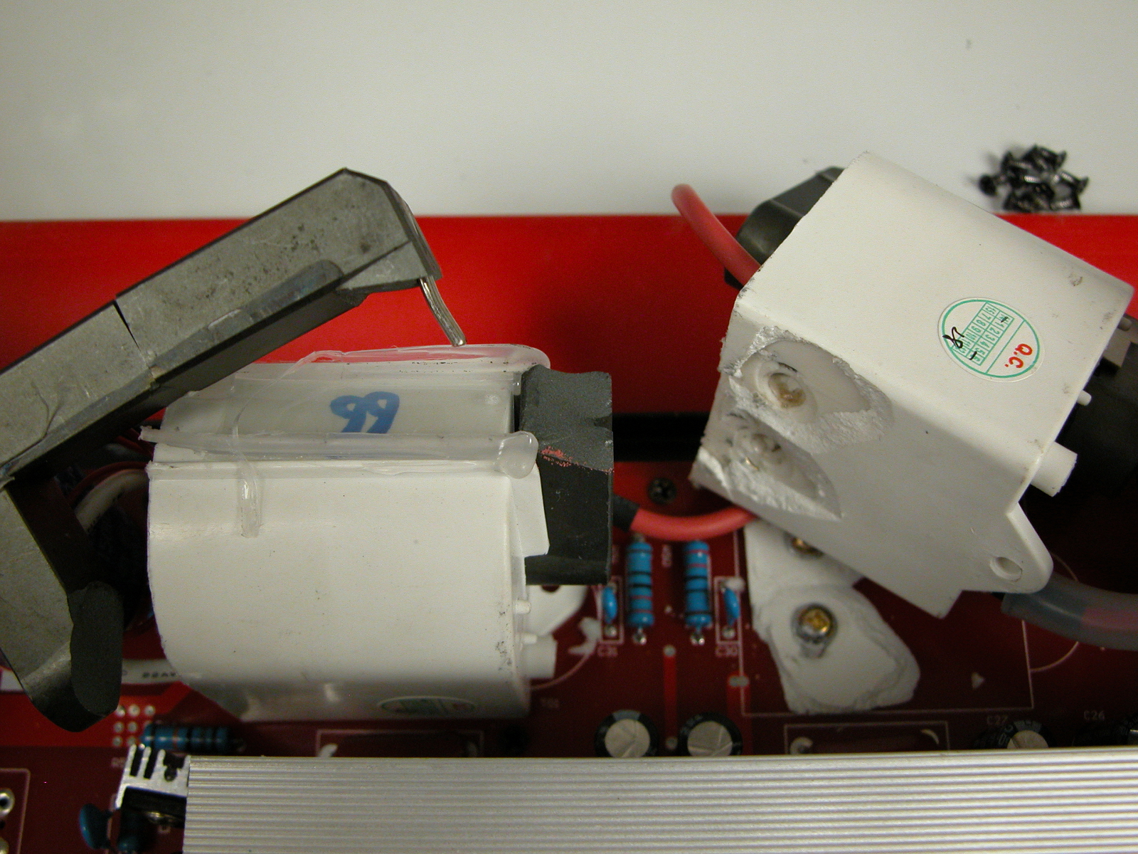

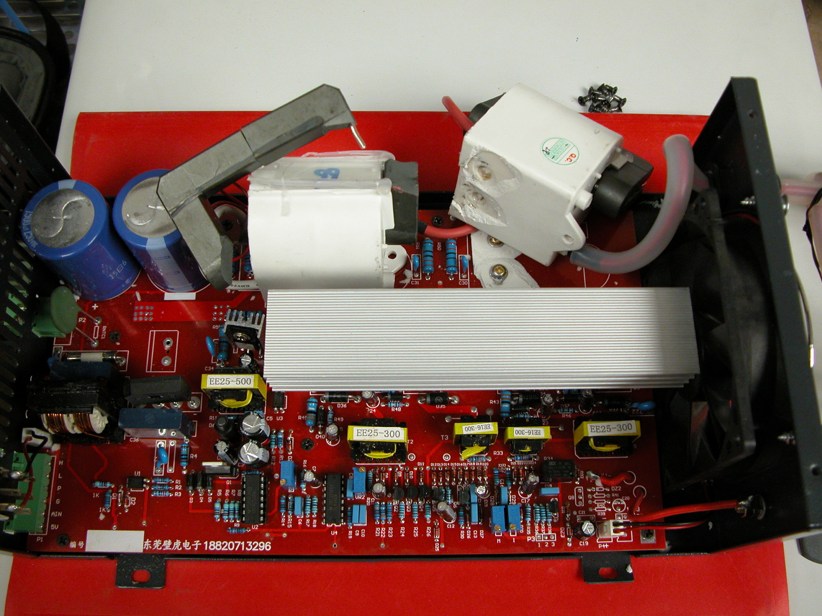

When I started unpacking my 80W PSU I just received today, I could hear a bad noise coming from something moving inside the unit.
I opened the cover to check the origin of the noise, and found the 2 HV coils broken! You can see the detail on the photos
The package itself was in perfect condition.
Can you send me a replacement unit, or just the spare HV coils and I will replace them?

Each PSU got bubbles wrap protection , so one can imagine how rough those postman are taking care our packages!
Dan:
Try to power it with low current output. I just need to make sure that the PSU is still functioning. You can glue the magnet with super glue
After testing, then you can take it out and I will order you two transformers
What is your order#? I believe we purchase insurance. If so, I need to file a claim. Very sorry to see that happened!

For the first transformer (on the left), just the magnetic core is broken, and I agree to say that gluing can allow to test the PSU.
I am more afraid for the second one (on the right): the primary coil connections are still on the PCB, separated from the coil itself!
It would be very hard to establish a connection with the broken ends of the primary coil on the second tranformer, because they are inside the resin.
Can I do a test with only one tranformer? I have got a HV resistor array that I already used for testing a second hand laser PSU, it is 576kOhm an it can dissipate 1kW. I also have an oscilloscope if needed.
If I absolutely need to connect the second transformer for testing, then I will try to carefully remove some resin...
Just for information, no bubbles wrap was used to protect the PSU, but only styrofoam chips filling the package. But it is not enough to disculp the postmen, you still need a very hard shock to cause such a destruction...

I have been examining the second broken transformer with more attention and I think it could be dangerous to remove some insulating resin to connect the primary and test the PSU.
I would like to get a new unit, the same as this one if you have it in stock. I could then use the broken one for spare parts, or repair it later with 2 new transformers.
