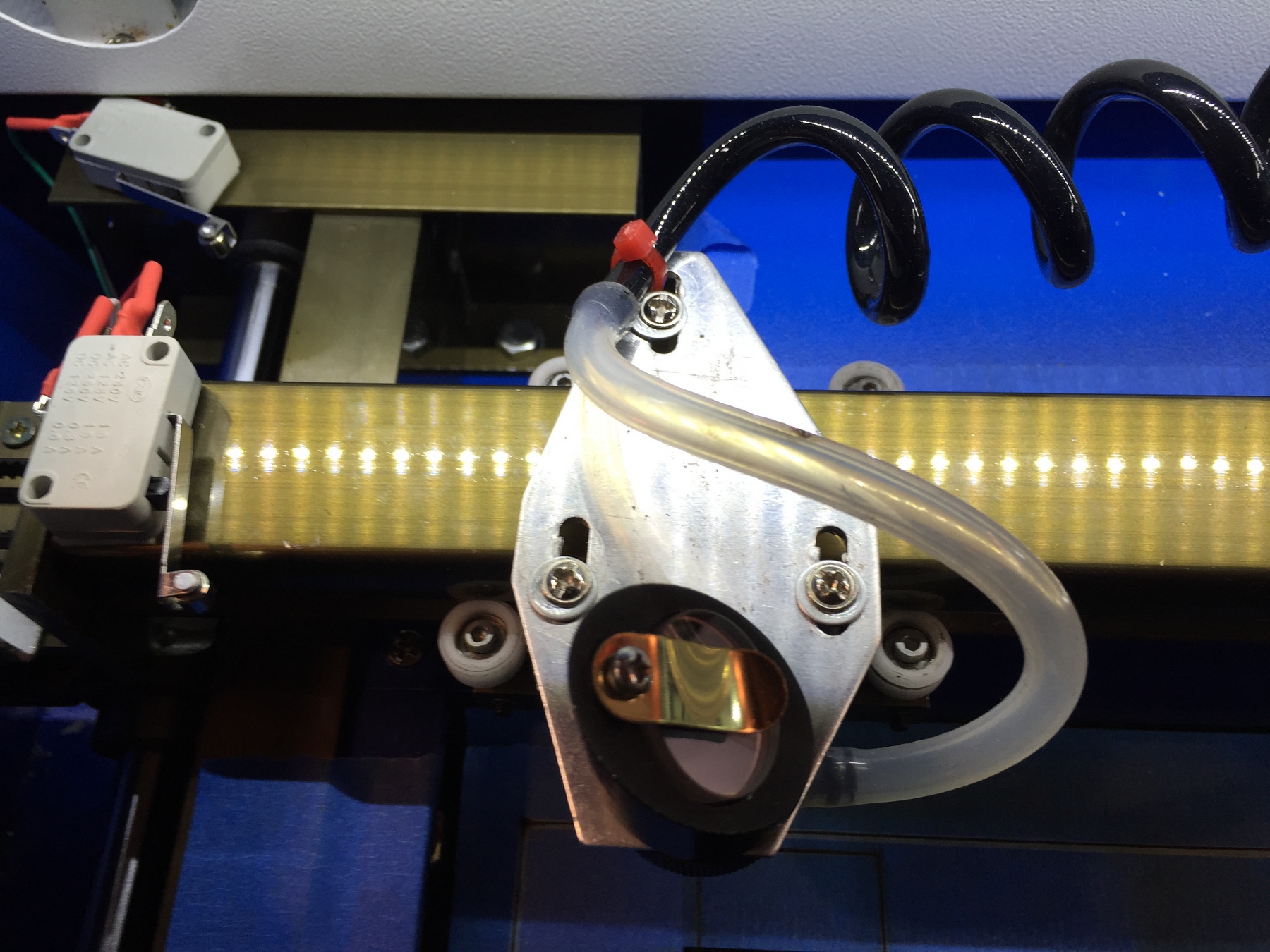

This is what I ordered after my initial K40 purchase from ebay, unfortunately I've made 3 separate orders so your lucky to make one lol:Mini 2
1 of: Mini 2 Phase 1.5A 1-axis Stepping Motor Driver
1 of: Power table/ bed kit for K40 small laser machine
3 of: 20mm Gold Plated Reflection MirrorSize of mirrors on orginal k40
1 of: 5mW 650nm Red Laser with adjustable focus
1 of: 300X200 Honeycomb. Fit K40 machine
1 of: High quality 18mm ZnSe Focus lens (F50.8mm) Size of the lens in new laser head
1 of: DSP upgrade kit for D/K40 small machine which comes with these items:
1 of: AWC608 Commercial DSP CO2 Laser Engraving/ Cutter Controller
1 of: DC 24V 5A Switching Power Supply. Good for CNC stepping motor and water pump
2 of: Proximity Limit Sensor Switch (C2)
1 of: Emergency Push Button Switch with lock
1 of: 3 digit Mini Blue LED DC 100mA meter. Ideal for CO2 Laser power indicator(100mA)
1 of: 2405S DC-DC 5V (2Watt) Isolated Power Module. Ideal for 24V system
10 of: 3 wires Limit switch/ sensor cable
1 of: 18~20mm Laser head w/ air assisted. Ideal for K40 machine
2 of: Mini 2 Phase 1.5A 1-axis Stepping Motor Driver

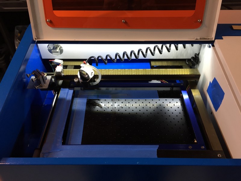

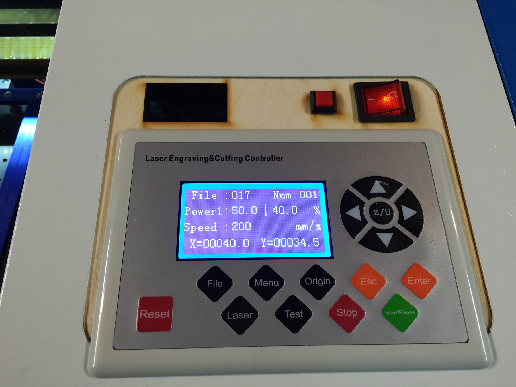

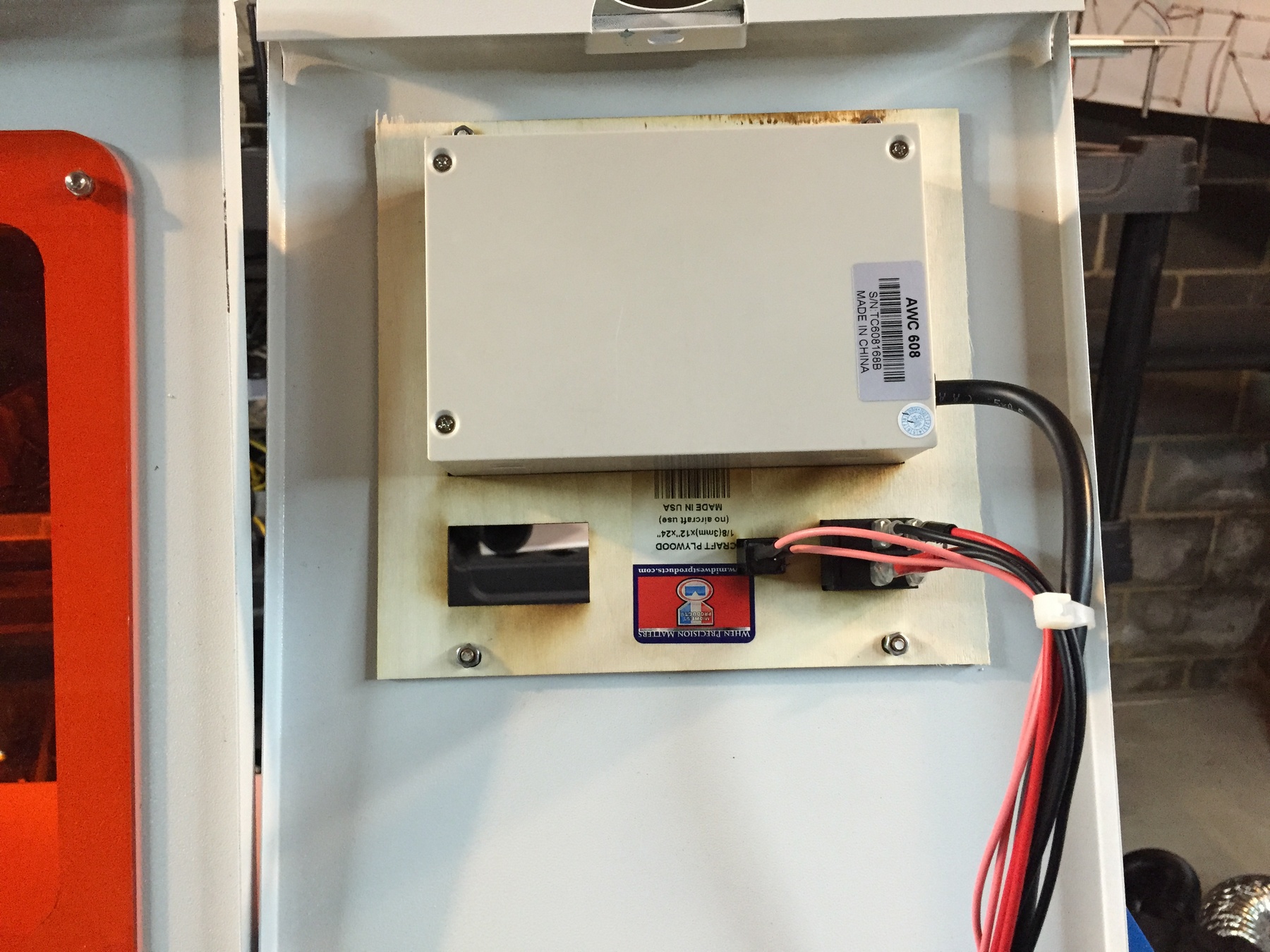

Found one important item missing from Acura's list: airline tubing for the air assist.
D40, X7 DSP upgrade (and all the other bits from Marco), and an air pump all scheduled for delivery by end of this week! I'm excited.
The one big unknown still remaining for me is how to mount the X7 DSP front panel so it looks nice. I'll have to dig through this forum to see how others have done it.

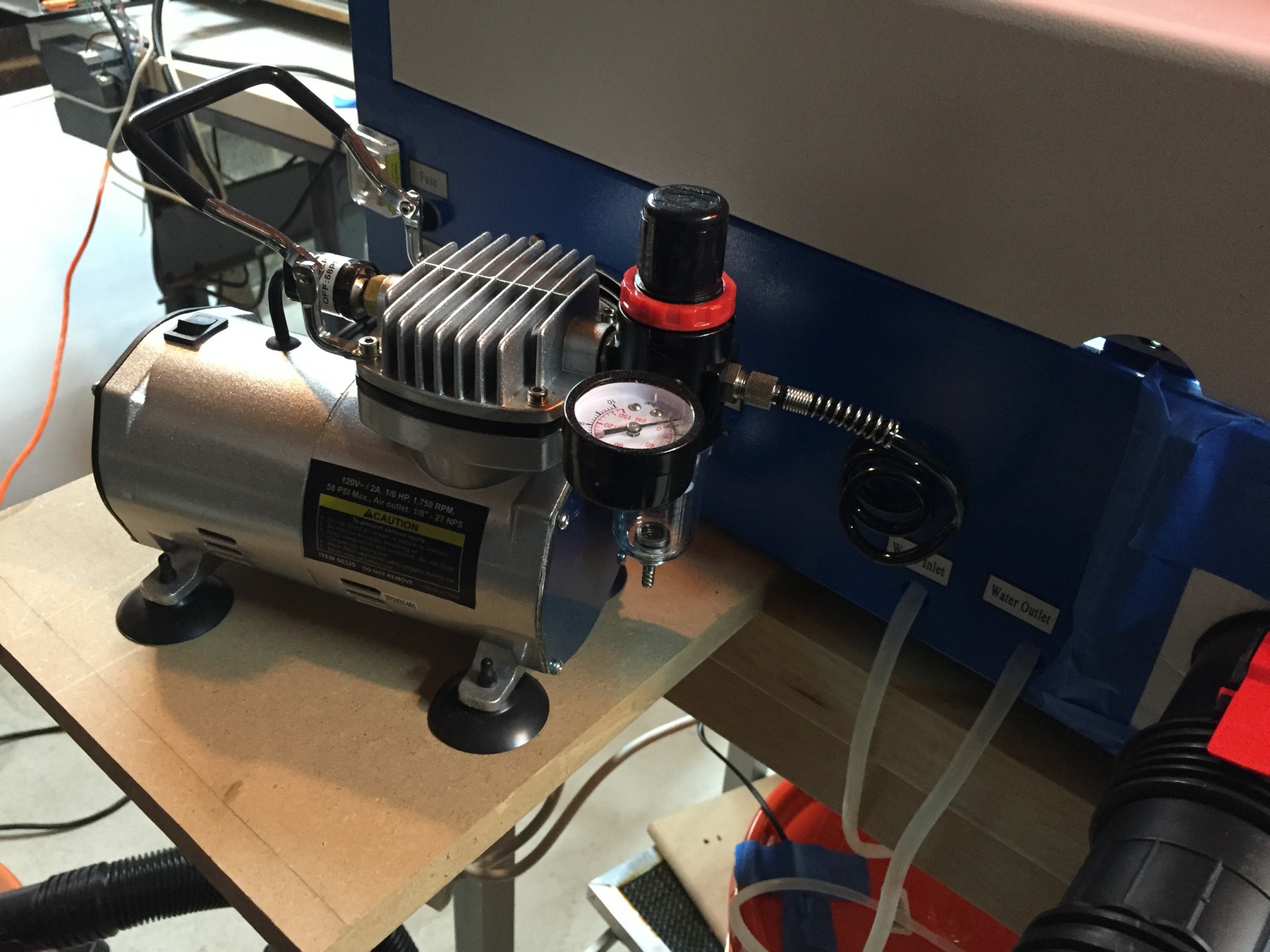

Re: Upgrade K40 (re AIR PUMPS)

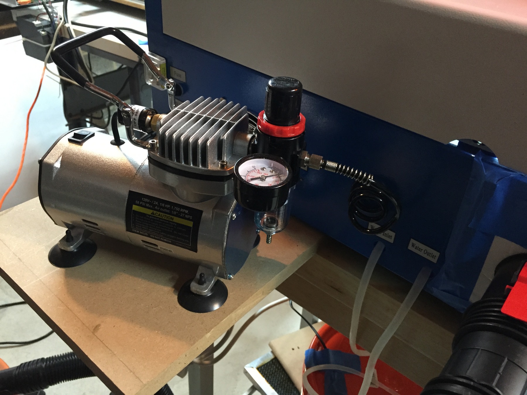

I made a BIG mistake with air pumps - just listing it here for any other K40 owners looking to upgrade.
I bought a two-cylinder airbrush pump with a 3(?) litre reservoir. It pumps, fills the air tank, switches off. The air squirts out through the nozzle.
So far so good.
Then the pump cuts in when the tank pressure drops and about one in every ten times this cutting-in triggers a reset of the DSP and another job is ruined.
I used to have an aquarium air pump which gave no such problems and I think I'm going to go back to the same again. Continuous running.
Though I may just try a bit of isolating and earthing first - but not easy.
Or I can set the compressor to continuous running but it's noisy.
Nick

You're correct, I bought like 4 different types and sizes of tubes but found that I could have used the tube that comes with the compressor, i just had to cut the end off of the side that connected to the air head. I then uses a small piece of tubing to connect the air head to the hose. I'll post pics of my setup later.jeckardt wrote:Found one important item missing from Acura's list: airline tubing for the air assist.

The pump I bought and linked too is pretty quiet. It does get warm but I put it behind my k40 right where the exhaust fan is behind the laser power supply so it does a good job at cooling it. I have not had any issues with resets. Your not controlling your pump through the dsp are you? Also my pump runs constantly when turned on, I don't believe there is a reservoir.NickWL wrote:I made a BIG mistake with air pumps - just listing it here for any other K40 owners looking to upgrade.
So far so good.
Nick

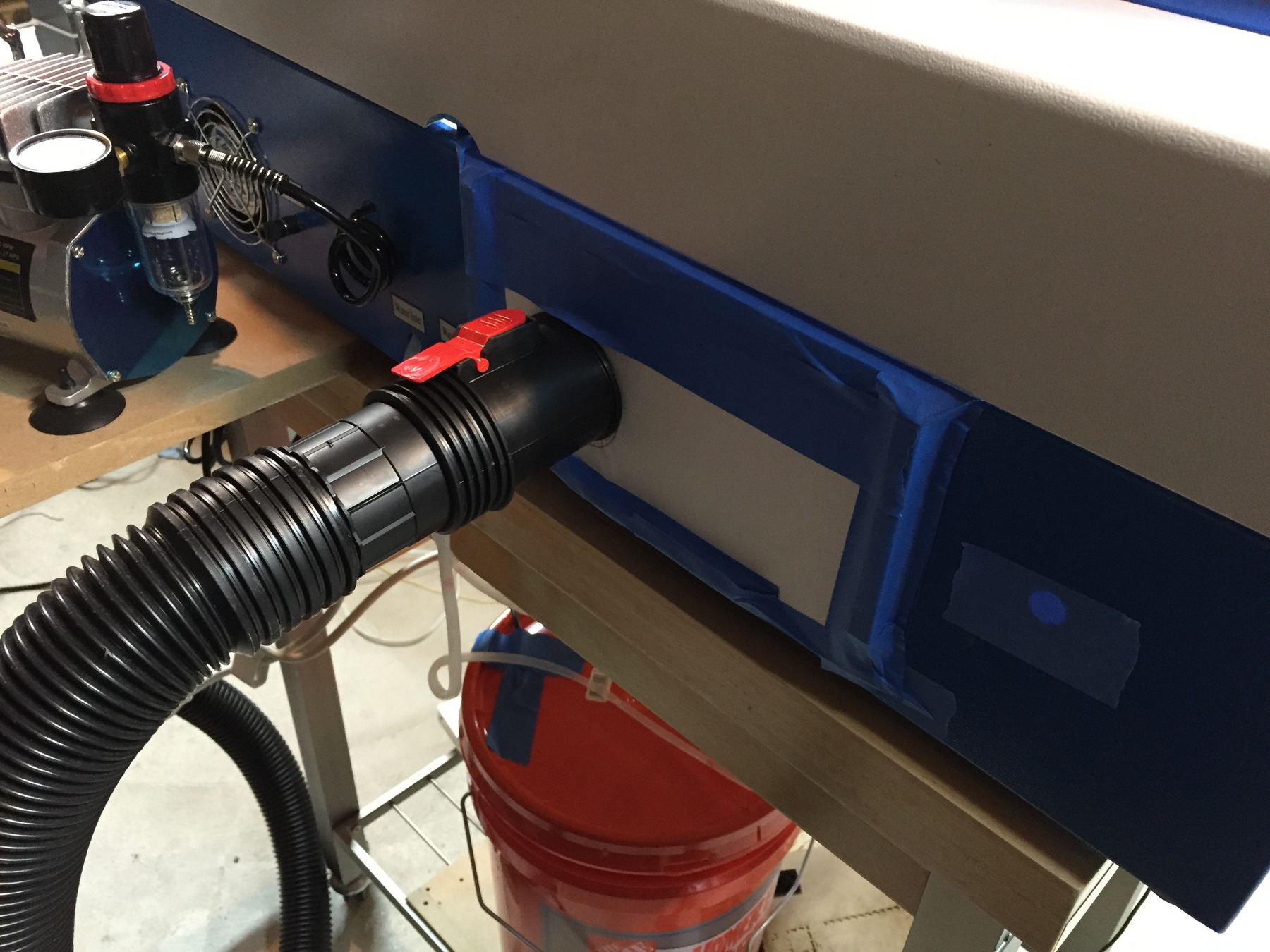

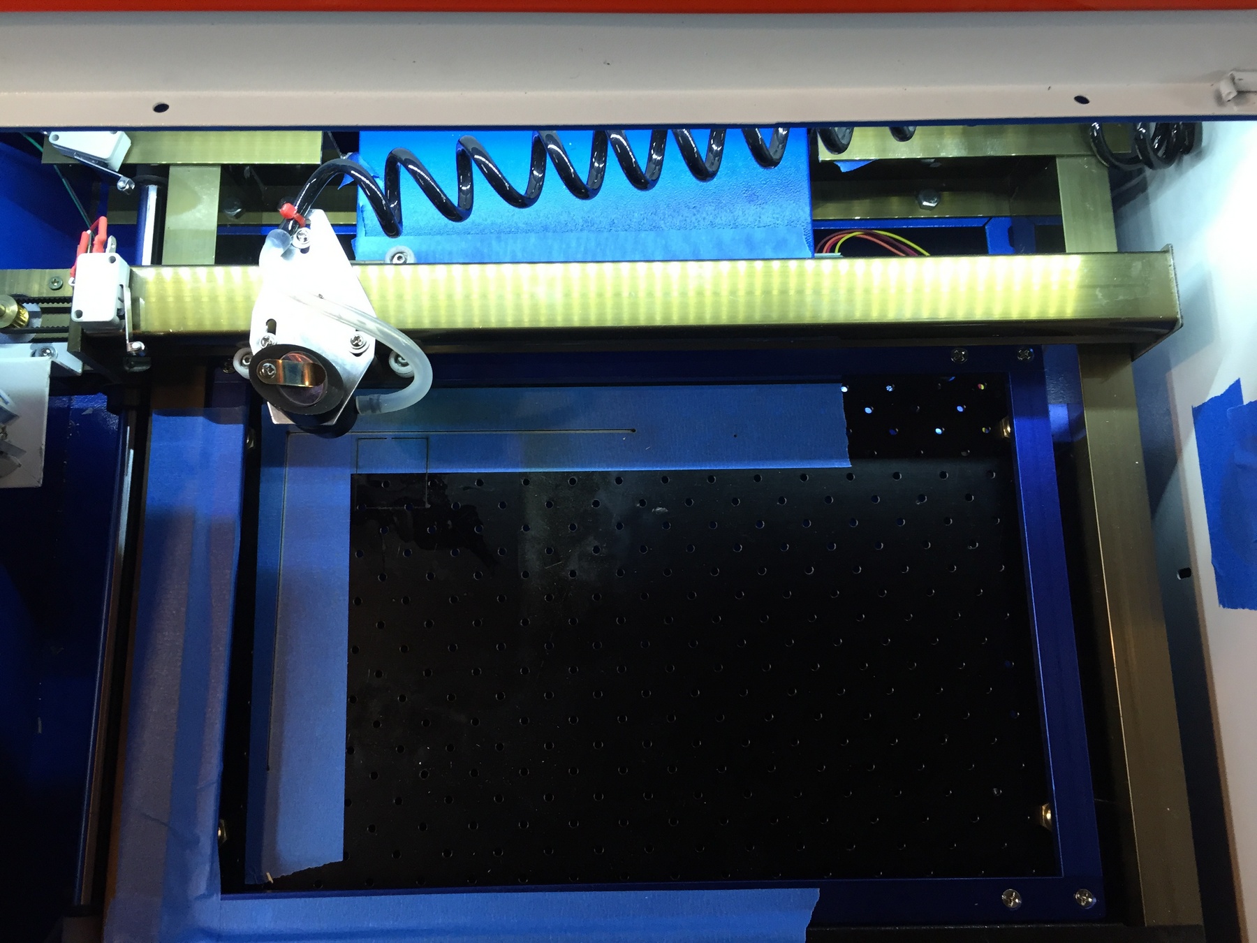

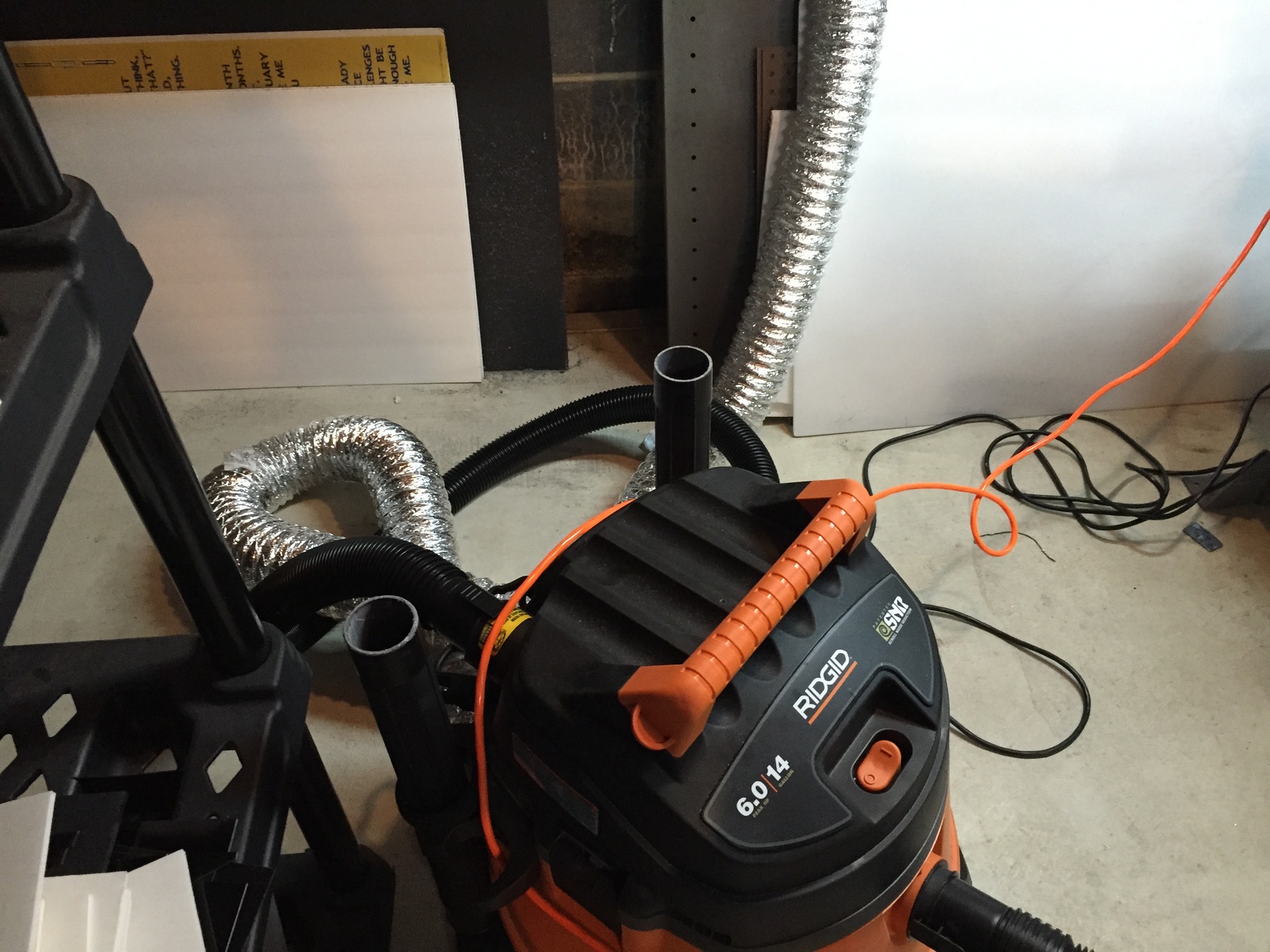

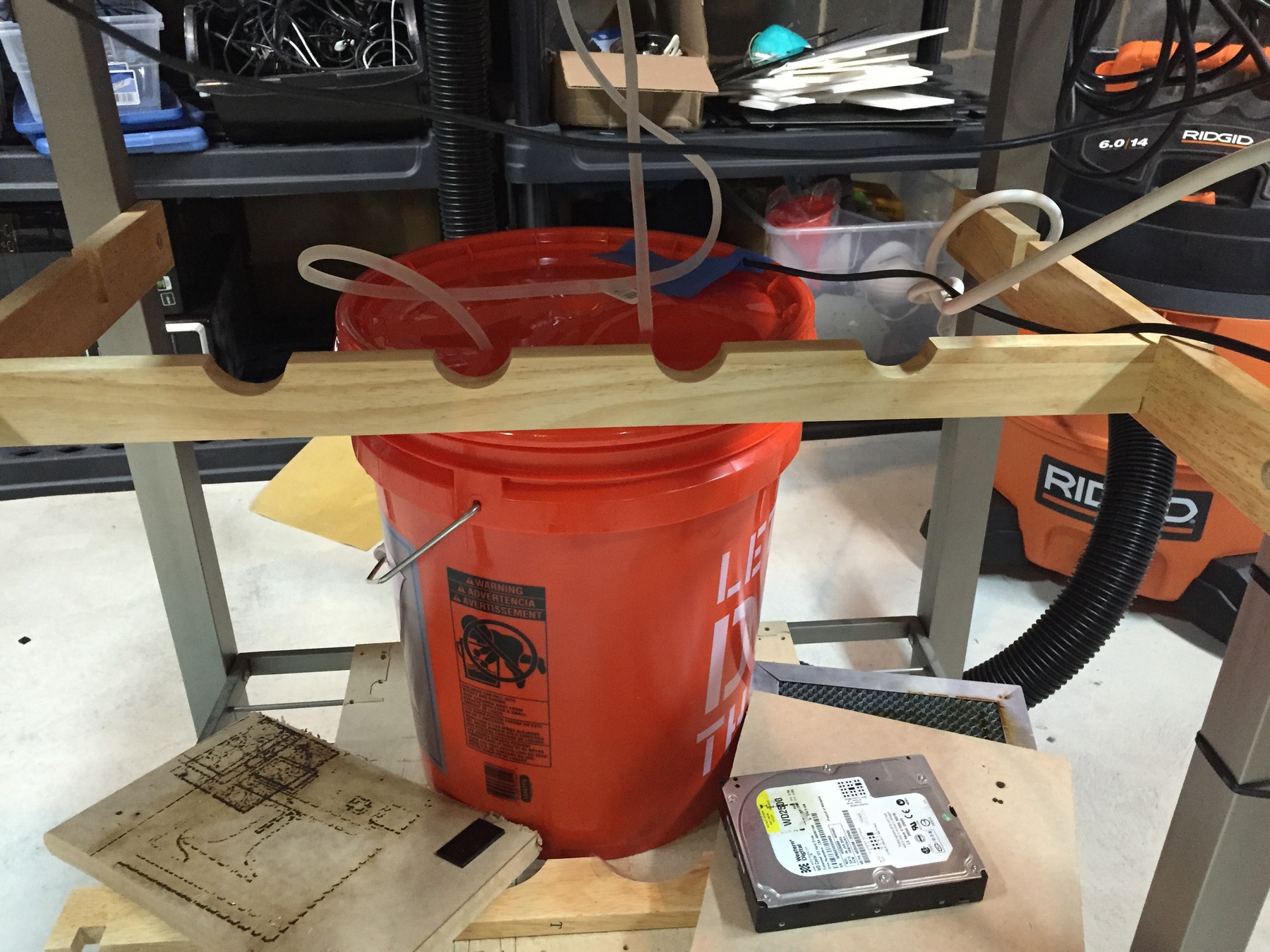

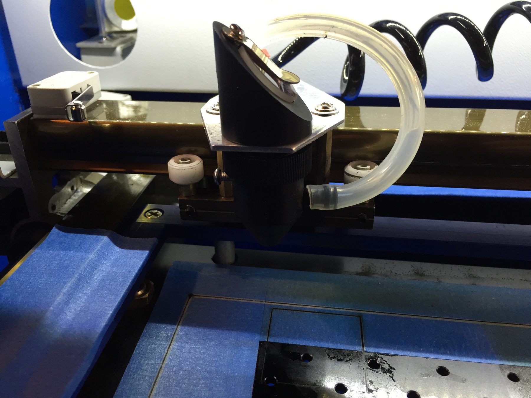

acuralegendz
- Posts: 18
- Joined: Thu Oct 30, 2014 9:11 am
- greg_gran
- Posts: 16
- Joined: Tue Oct 21, 2014 4:18 am
- Location: Central Pennsylvania, USA

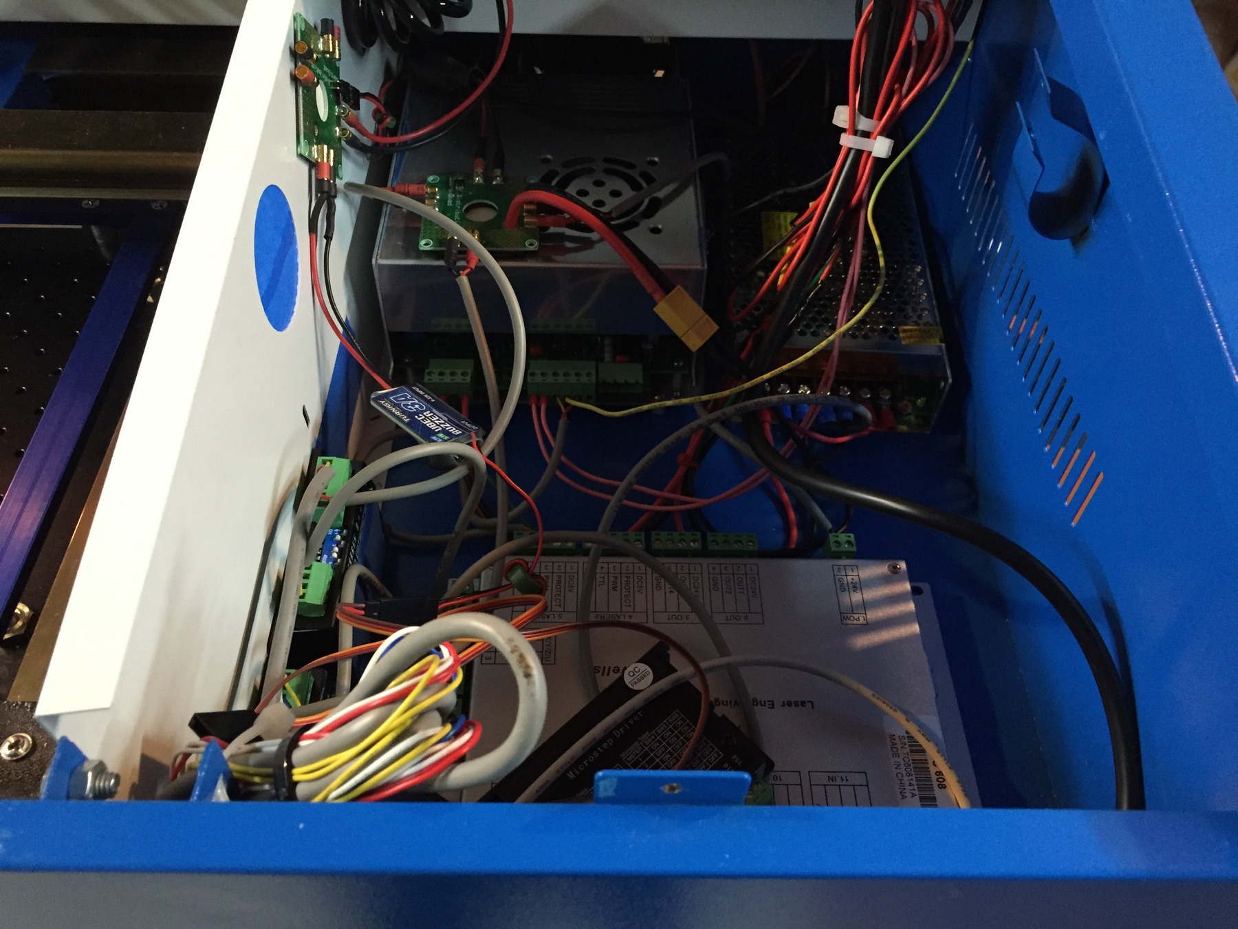

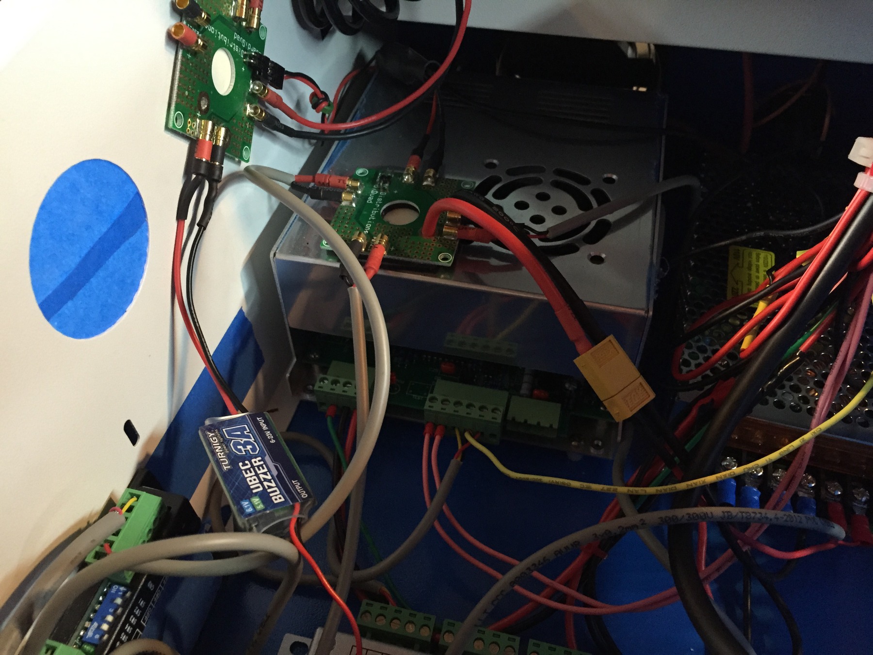

Re: Upgrade K40

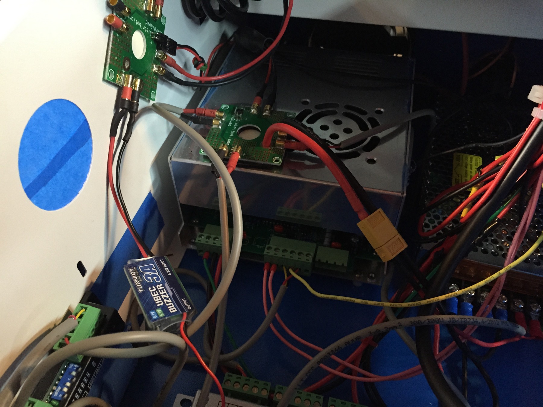

acuralegendz - Sure can tell you're into RC and multicopters!
The XT60 lipo connectors, hextronik quadcopter power distribution board, and turnigy UBEC are a dead giveaway
My workshop is littered Hobbyking parts too. I've got three or four of their multirotor frames built up and flying.
One of the reasons I bought the lasercutter was to make my own custom camera gimbals and mounts, frame parts, etc.
Greg
Greg
