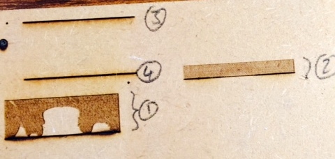

The symptom now:
On startup I can move in the x- y- and z-axes under manual control as much as I want.
As soon as the laser has been fired - even if only a test pulse - nothing will move in the y-axis either under manual or program control and a reset just hangs with the message 'System resetting'
Previous symptoms:
When engraving, the job would get partway through before stopping response to y commands and just burning a line in the same place (larger area on picture marked '1').
The amount of y movement reduced on the next job to just a few mm (smaller area in picture marked '2')
The next two attempts just burned a line in the x-direction with no y movement at all (picture '3' and '4')
Diagnostic results:
Changing the stepper controller (I have a spare used on my z-table) made no difference.
Swapping the x- and y- controls from the DSP box made no difference - it still only cut in the x direction
Advice please!
A little while later...
I left the machine turned on and unattended, came back a ran a file - and IT WORKED!!!
I thought my problems were over so turned it off and on again ... problem returned x-axis movement only.
WHAT is going on??????
No y-axis movement after firing laser

Tightening ALL connectors - whether they are apparently relevant or not - seems to have cured it (for now?)
