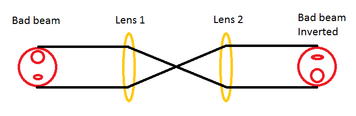

I have drawn a picture of what I think you are suggesting. Please correct me if I am wrong, but isn't this simply going to invert the beam and waste power? I don't think there is any way to fix this problem with external optics as it is something wrong inside the tube itself. Is there any way to have it replaced or repaired be Reci?

Re: 80 watt Reci laser beam problem
Therotically speaking, if it is going through a high quality lens set for image or video, yes it could be duplicated to the output. But over here, we're talking about high power CO2 beam going through a ZnSe focus lens, but not passing through a high pecision focus lens you found in the camera. Considering the beam may diffuse itself rapdily when leaving from the focus point due to inferior in quality of focus lens. So, the beam after being compressed and expanded, I believe that the "flaw" could be absorted away by the beam itself. Well, it's my theory only. I can't proof unless I can test it on a faulty tube like yours.OK Robotics wrote: I have drawn a picture of what I think you are suggesting. Please correct me if I am wrong, but isn't this simply going to invert the beam and waste power? I don't think there is any way to fix this problem with external optics as it is something wrong inside the tube itself. Is there any way to have it replaced or repaired be Reci?
