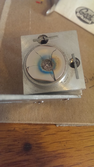

It's also worth noting that you're gambling with the quality of components. Take this mirror for example:
That's the first mirror closest to the tube of my K40III. Aside from alignment checks and about an hour of laser time cutting cardstock, this happened midway through my first attempt to cut 1.5mm acrylic (10mm/70% power). I'd taken care to make sure the gap between the tube and mirror was at least an inch (mine came set up at 3/4") and the laser still cooked the mirror 70 seconds into a modest cutting job. The second mirror is fortunately unmarred, but it's going to get replaced too.
Play it safe, order better mirrors with your DSP.
-Tod

This is totally unsafe, It could reflect the invisible laser beam away to un expected direction !.

Wow, that's crazy!
What percentage where you running your power at when that happened?

Toasty,
I was running the job at 70% power with 100ppi; my analog current meter wasn't going above 10ma when it happened. Marco isn't sure what the coating was, but it was obviously thin and unsuited for the first mirror. That was not a fun find.
