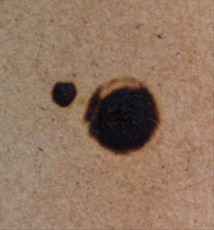

Hi, I am testing a new 150w RECI tube now. Every time I fire the tube, I got 1 big dot(around 8mm) and 1 small dot(around 1mm) next to the big dot on the testing material.
I thinks there should be only 1 big dot. Do you guys reckon the tube is faulty or it needs to be adjust somewhere?

It is not a fautly tube but "imprefection" on the beam spot. If the little spot is not too far away and able to reach the focus lens, the affect is very mininial.
I have a 100W installed on one of demo machine having similiar issue. But after the focus lens, no performance dropped could be seem obviously. You may put it on your machine and give it a try

I can tell you that Reci once a while may have some issue. We have two customers were complaining low power output or "miss fire" issue with Reci tube
The longer the tube, the more issue it could happen. I was told that the Reci 150W isn't very stable compare to lower power tube. Most 100W or 80W are very stable though.
You may contact Reci see if they can assist you for a replacement but I doubt it as it is not a faulty tube but as I said, "imperfection". Your tube should cut pretty much the same.

Well it looks something like this in the attached pic. I managed to take out the small spot out of the mirror but not sure how many percent I lost the tube's power. Maybe now it's just 70W tube
??lol
- ScreenShot218.jpg (118.63 KiB) Viewed 4827 times
Re: Reci tube Beam Adjustment
That looks bad to me. It seems that the internal mirror/lens is damage. You better call your supplier to report it to Reci before the expiration date. You may lose at least 10~15% in that matter

By the way, I could cut through a 19.5mm pine wood with 10mm/s through a 100W tube. Even a K40 can cut through 9mm with speed 2mm/s. So, you better called the seller (if not me) to request a replacement
