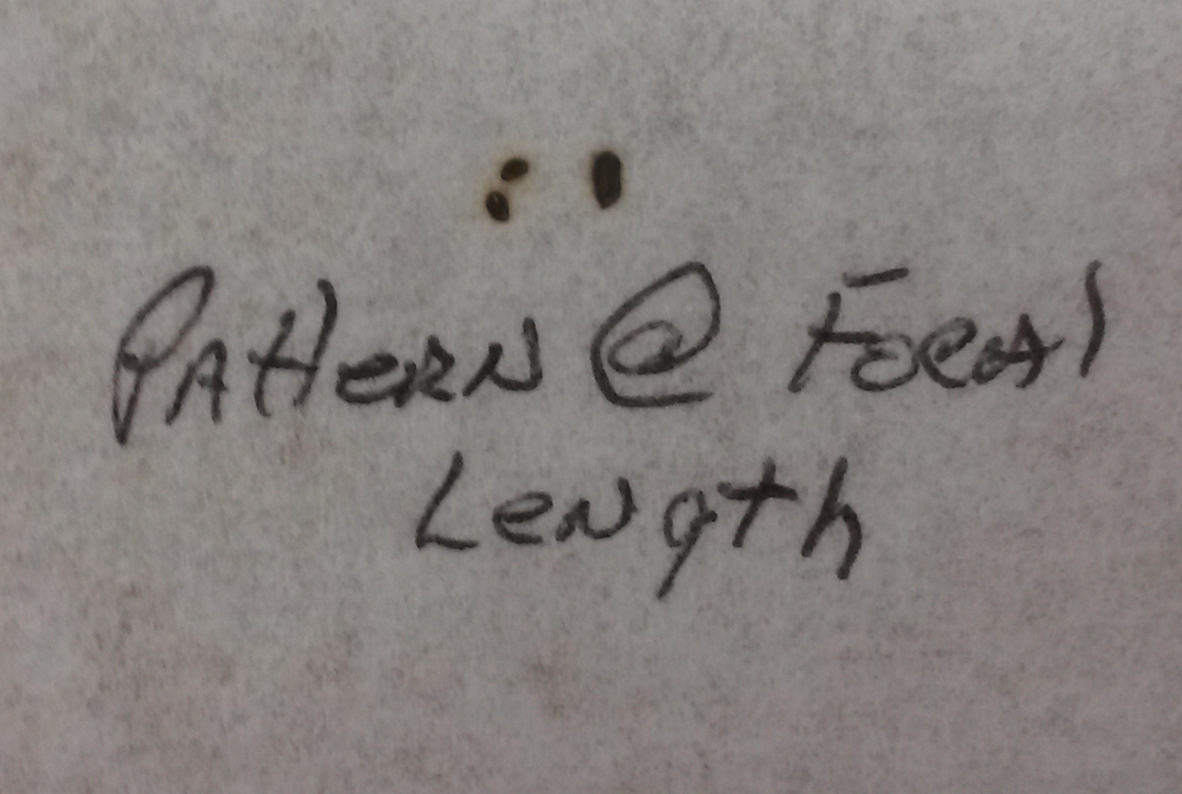

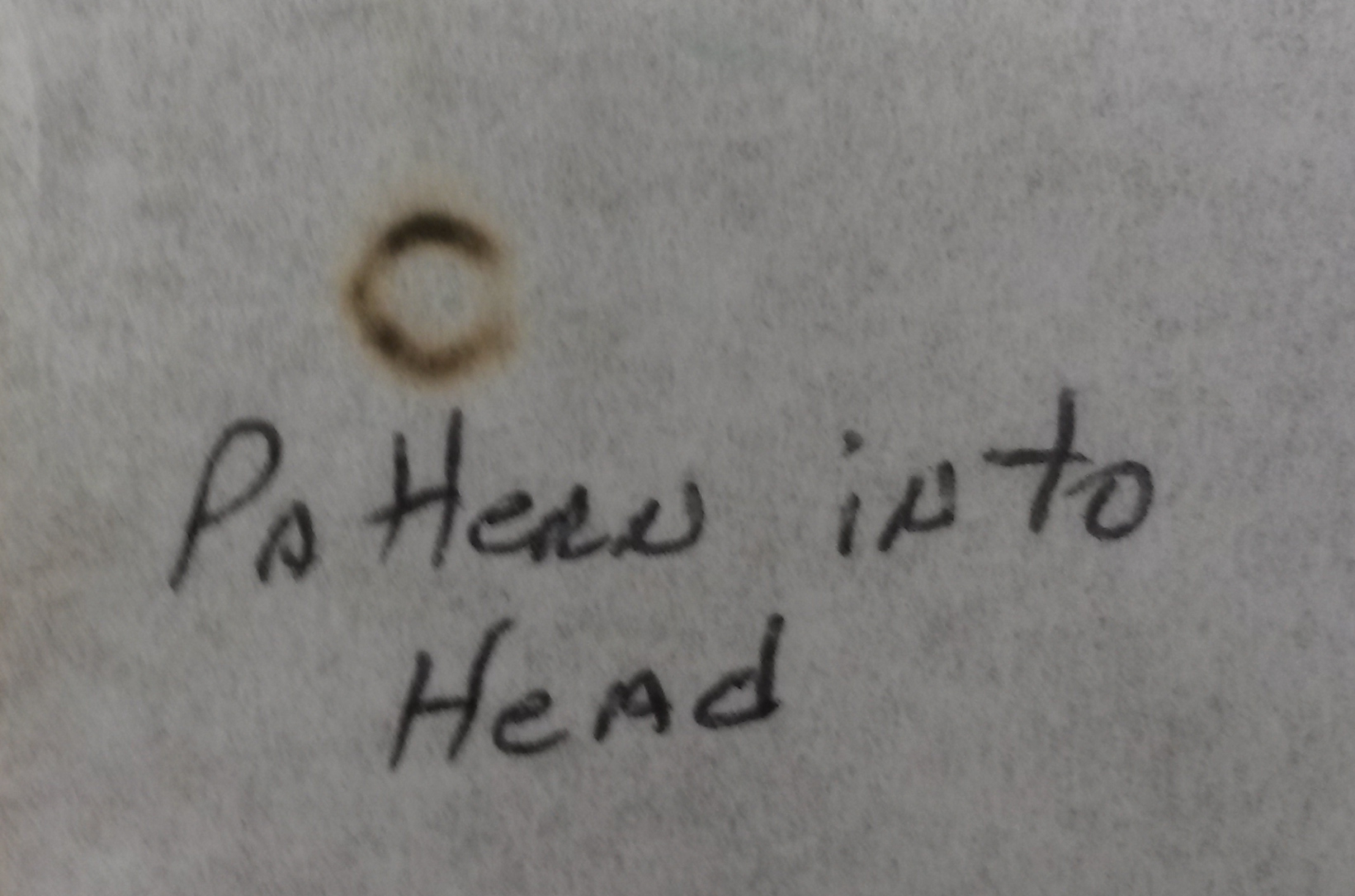

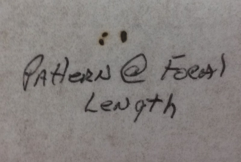

Here's some pics of the laser pattern. Same patterns when flipping the lens. Thought maybe I had it in upside down, but no.
Re: Problem with laser power
Bob:
What was current setting on the laser tube? It seems that the current was very low somehow that's why you got a "donut" ring like burn mark
Check the connection on the HV laser wire to make sure high voltage is not "leaking" by lose connection or damaged wire somewher

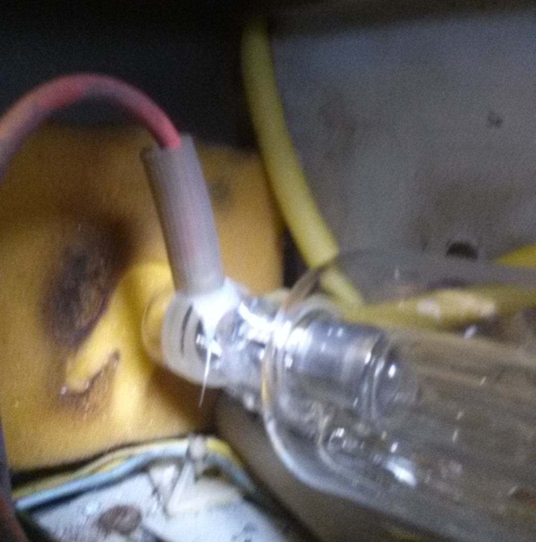

You soldering the wire on the laser tip??
Send me a picture what you have done. You should NEVER soldering a wire to the laser tube. It will damage the bonding as glass and metal 'never' bond together well. You can wrap the wire on the pin and glue it with silicon glue.

Here's what I did.
Cleaned post. Wrapped with soft copper wire leaving a tail of copper wire. Soldered with low heat soldering gun. Placed HV against post. Wrapped it with the tail of copper wire. Soldered in place. Did the same with the ground. Covered both with silicone, slid a piece of silicone over the joint.
Not sure I can get it in a position to shoot against a wall, but I'll try.
By the way, now it won't even cut thin shirt cardboard at 28 mA!

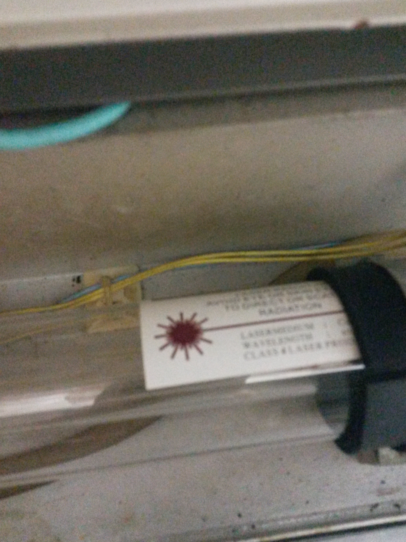

Bob, when did you buy the tube? Got a picture of the tube?

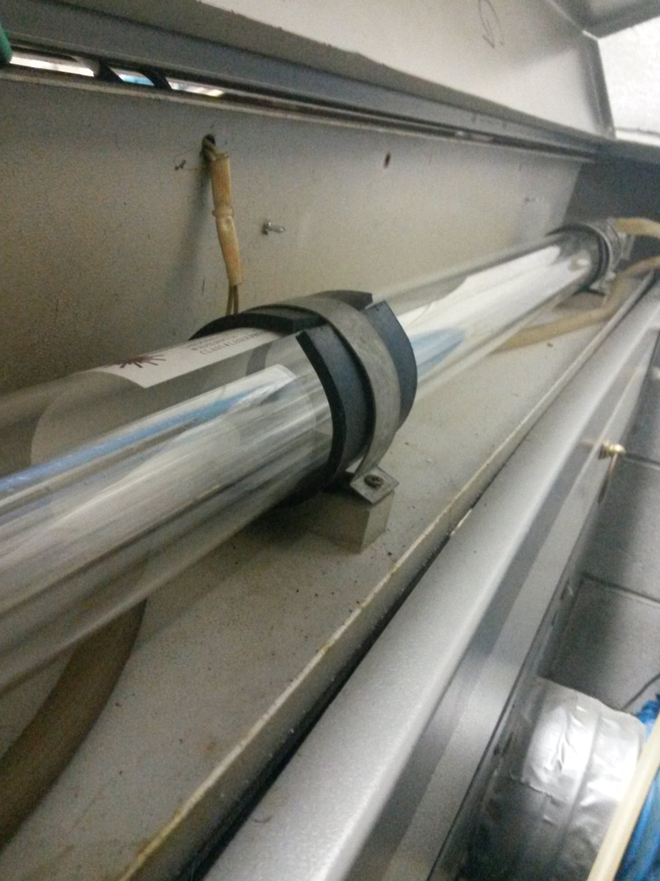

Here's the best pics I can get right now. This is a big heavy machine. It sits against a wall and I have to move a table and other things to be able to get to the back.
I have to go to a play this evening
so it might be later before I can get back on this.
Thanks for your help. Will you be around tomorrow afternoon?

I ran the tube onto a 2 x 4 for about 25 minutes at 18mA. It charred a nice hole about 5/16" in diameter and about 3/16" deep. It was bright red the whole time. Nice purple straight line in the tube as well.
