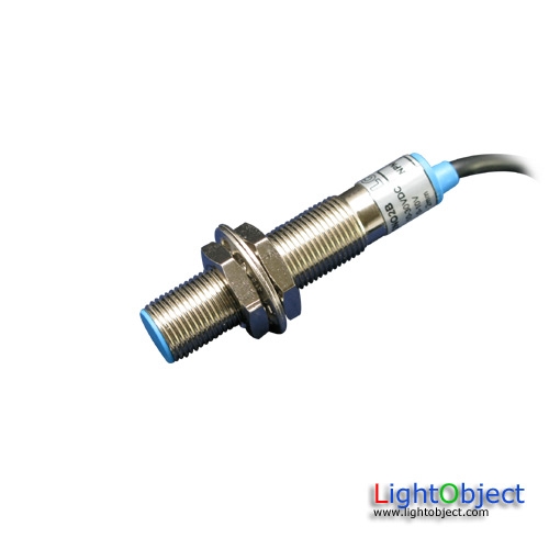

using for limit end pos. X/Y
type sensor NPN WIRING BROWN, BLUE AND BLACK

Re: how too connect
Usually people buy that sensor for power 'Z' table for auto focusing. For home switch, we usually used switch type proximity sensor or magnetic sensor.
Example: http://www.lightobject.com/Proximity-Li ... -P616.aspx
If you really need to use that probe for home, you need to power it up by the on board 24v dc. Brwon: +24V, Blue: ground
Then connect the Black wire (NPN N.O.) to X+ or Y+. I'll do some test to confirm about it
Re: how too connect
I forgot to mention that if this is normally opened (NPN Open), it means that the Output is always High (+5v or 24v in this case) when the sensor is not engaged. So, you may want to change the "LimitPolarity" to "Positive" if the one you test didn't work, or the other way
Update: "LimitPolarity" need to keep "Negative"
Re: how too connect
I have tested the Capacity proximity switch today and it worked fine.
Connection
Brown wire to +24V
Blue wire to Ground
Black wire (output) to X- or to Y-
Keep the parameter "LimitPolarity" unchanged (Negative), the same way as a regular switch type sensor used
How do I know the sensor is working?
Ans: once it is connected and powered, A LED on the top (wire side) will lit once the sensor put closed to any object
To test:
Set the laser head to the center of the stage, power it up the machine and the laser head will try to go "Home". During this time, a quick triggering on the sensor (tip the sensor with a finger) and it should cause the laser head to react, just like touching a regular switch sensor
Connection
Brown wire to +24V
Blue wire to Ground
To test:
