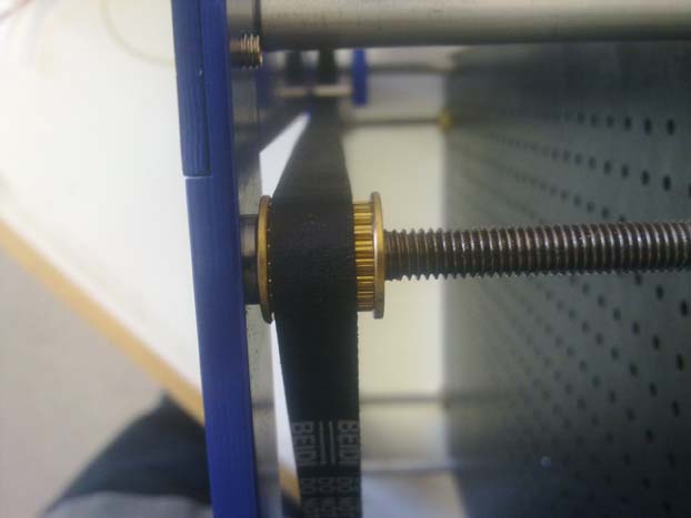

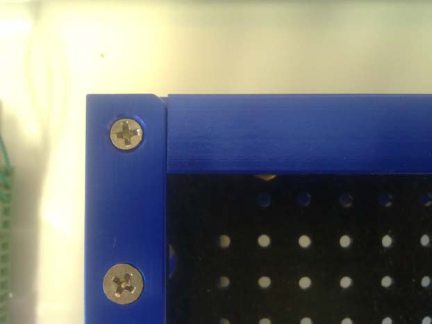

Not at all happy with this Z-bed situation since discovering one long side of the top frame was installed with the radius corners inside. As well, a the second screw to properly hold the stepper motor was entirely missing. There also seems to be a difference in the placement of toothed belt gears on their corresponding threaded rods this results in vertical slop that i cannot correct even when I level the bed against the top frame with the lock nuts.
Am I able to reposition the gears evenly on the threaded the rod (and maybe flush?) against the lower frame of the z-bed?? Or is my frame bent by the loose screw of the top frame getting jammed between top frame plates at some point betwen assembly and receipt / also resulted in one of the uprights being loose.

Sorry for the trouble. The Z bed was supposed to be shipped as a kit (not assembled). Because of miss-communication, my tech there in China assembled all Z bed when shipped. You may want to disassemble it and do it again.
By the way, we're not responsible for the duty tax.For the price we sold, I just want to let you know we didn't make a lot of profit by selling the unit. However, the complexity and difficulty to make it available on market is far more than anyone could imagine. Please understand that it is just a fancy 'toy' for folks who own a K40 and I decided to created one per request. I spent whole month in China to monitor the design(from scratch) to the finished product. It is not comparable to a Pro product with high precision axis which cost over $1000 for 600x400 XY stage. FYI, the parts on this mini Z bed are 100% customized. Even those 4 threaded rods are custom made and not available in the market.
I'm sorry if you're not happy with it. Please send it back for refund.

For what it's worth, I'm pretty happy with the Z-axis kit I received. I was starting to look at DIY'ing it, but for the price, there's no way I could have done it with the same results. I actually just started trying to get mine running today (after too long of a delay). My table was also not level, but it was a simple matter of taking the tension off at the idler, and spinning each corner individually to the top. I checked the spacing with calipers, got it all set right, and then reapplied tension to the belt. Once it's running, it should be set great.
