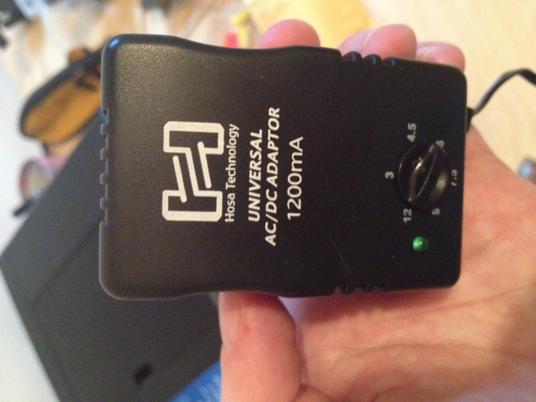

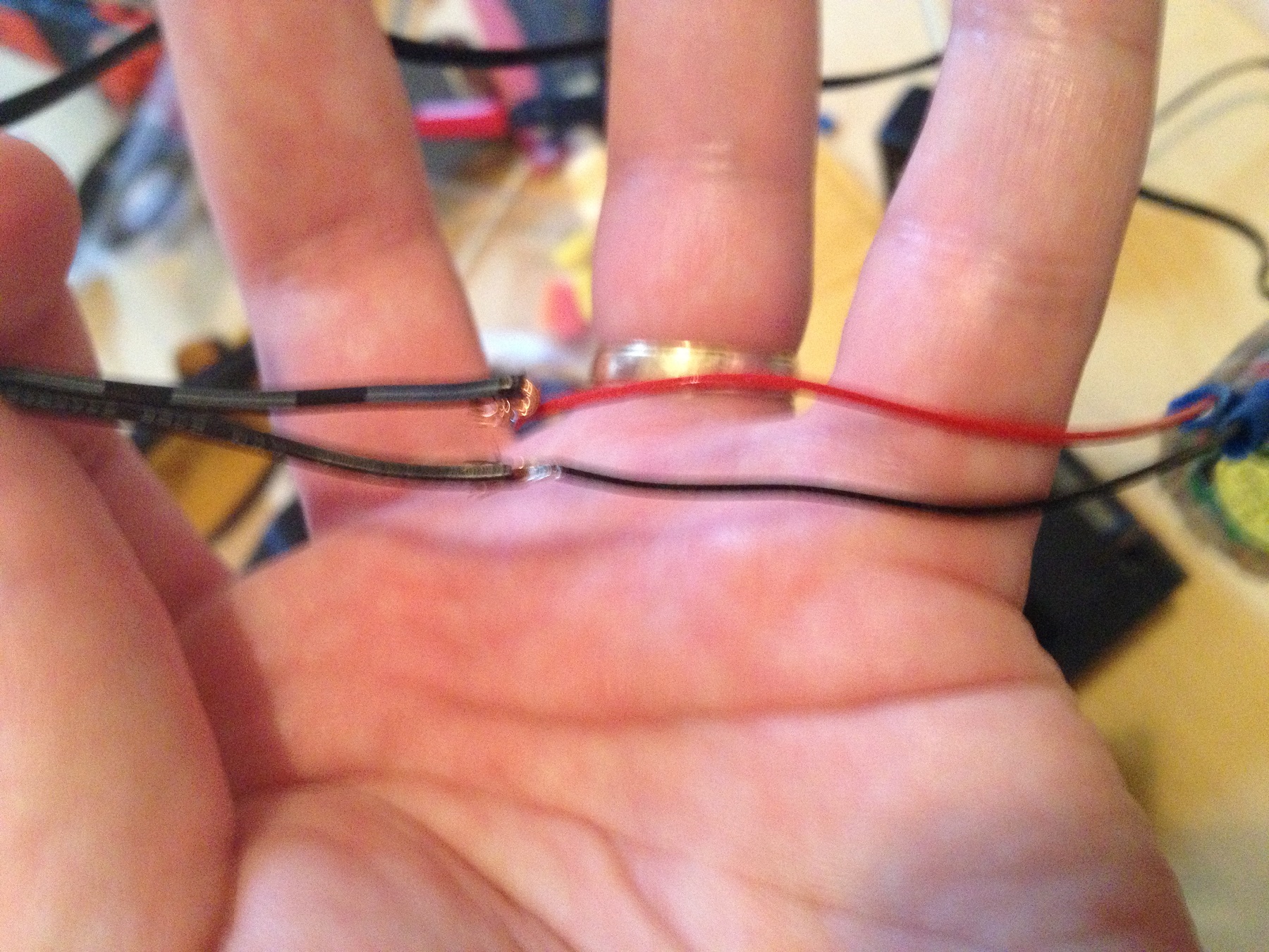

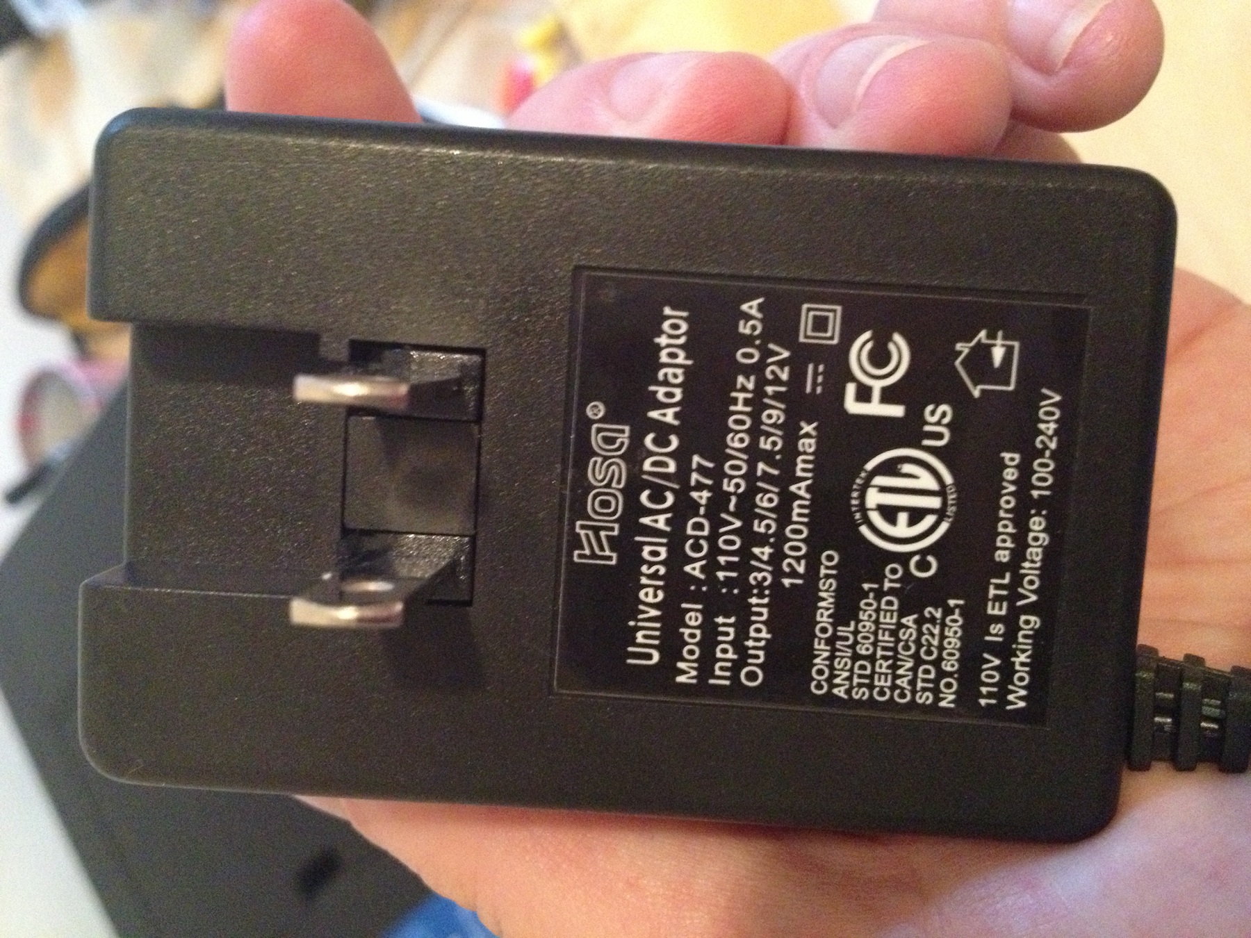

Thanks for the quick reply. The pump I'm trying to work with now (I threw the previous one away thinking that I probably killed it and it was my fault) is the EWP-2502HT12V " High temperature(100 'C) DC 12V 1.85L/Min (29GPH) mini Water Pump. Food grade pump.
I'm attaching photos of my AC adapter and the wiring I did. when I tested the pump it was always submerged in room temperature water
