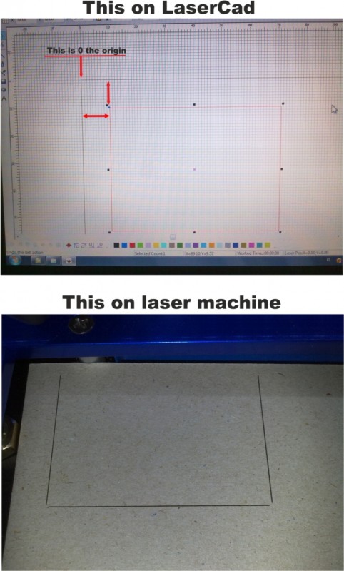

thanks for your quick response!
I have to ask you something else:

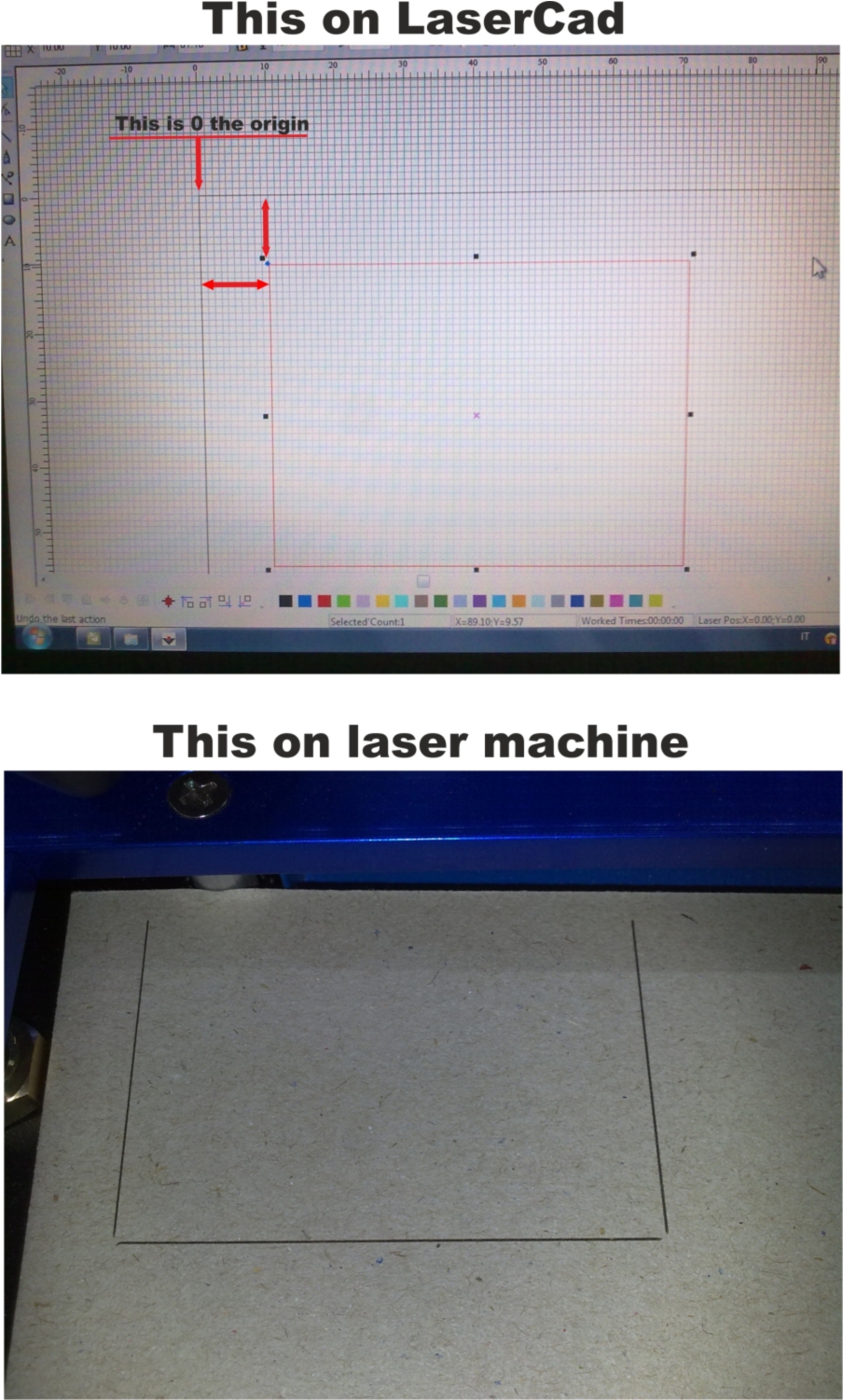

as you can see from the picture I can not coincide with the origin of lasercad that of the machine,
where I'm wrong. I'm doing some tests, which went well, but the position I have always moved by
hand from time to time, as you can see is the y-axis.
Alfonso
Alfonso

You may not be able to cut or engrave right on the machine origin point, also named as "HOME". It is the physical zero of the machine with XY limit switches located. The reason is that the XY need to take some time and distance to speed up to reach the desired speed.
FYI, You may setup the starting point (Origin) by programming the origin location through the LCD unit. It could be one of this:
- Machine zero: absolute zero
- Software control: what ever the origin point shows on the LaserCad
- Key control: Use the arrow to move the laser head where you want it to be the Origin then press "Origin"
The menus show mention this part well

Yeah, it's good practice to never use the exact machine origin as your starting origin, I usually go 1-2cm in each axis just to ensure the head has enough room to accelerate/decelerate. For example, if you try doing an engraving right on the machine origin, it will fail as the head needs a bit of room on each side to reach a constant velocity for engraving.

but if lasercad say x = 70 y = 50 and the machine gives me x = 72 (and I think is okay)
and y = 37 I think there is something wrong with y.
I read somewhere that the sequence of the motor wires Y is not the same of the motor X
because I used the same sequence for the two motors.

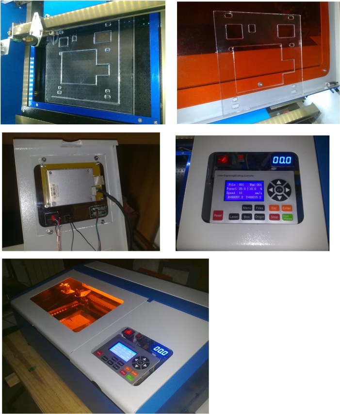

Thanks for your suggestion for acrylic ... I finally did the panel as you see in the picture .... small imperfections of measures taken bad, all things considered the final result is acceptable as my first cut. I used 2 mm/s and 90% power, 5 mm/s it was too little for my acrylic.
Alfonso
Alfonso

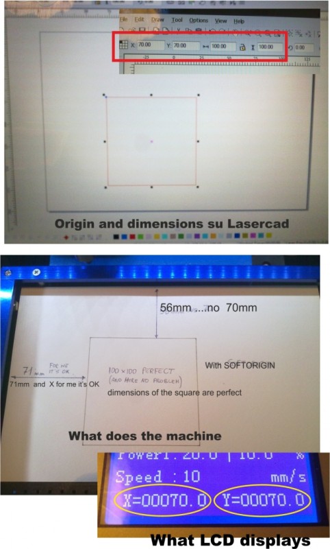

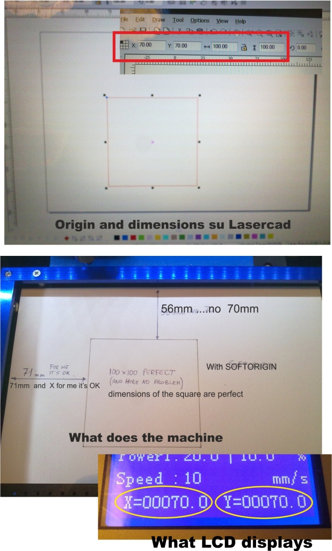

I try to explain better
I would that I see the origin on lasercad coincides with that of the machine, I can not understand where is the mistake
I set SOFTORIGIN on the machine, I have drawn a square 100mm x 100mm with origin x = 70 y = 70 (example chosen at random)
as you can see from the picture the only problem is the distance Y, everything else is perfect (X Origin, Dimensions of square)
the distance Y I expected was to be 71 mm as X (71 but not 70 because the paper passes under the edge of the table movable) and no 56 mm
I hope I explained.....I hope my English is understandable, sorry me
Alfonso
Alfonso

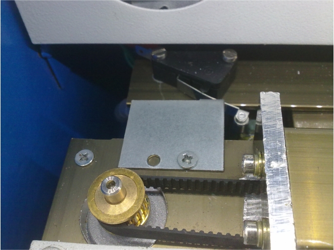

barillo66
- Posts: 21
- Joined: Tue Jun 25, 2013 9:03 am
- Location: Villanova (Rome)-Italia
Re: K40 conversion successful thanks to Marco
Hello
I solved the problem .... how could I not have thought of that before
The defect there is in the position of the limit switch Y
located too far down from the moving axis and then the machine zero
did not fit into the space of the floor, and then I solved like in the picture, it is now ok
but I'll have to make a plate to have a precise machine zero as I will
Alfonso
Alfonso
- Y LIMIT.jpg (231.81 KiB) Viewed 7401 times

Any chance of putting up the file you used to cut your acrylic panel with, looks good.
Jim
Jim
