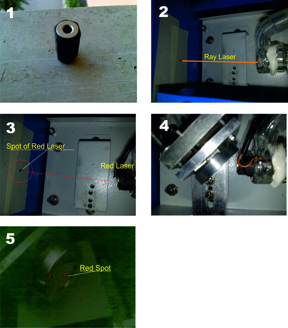

I have done so:
-I took the case of a jack (fig.1)
-I bought a red laser pointer and I disassembled and inserted into the jack,
preserving the power supply (3 button cell battery) and the switch to make it work
