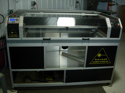

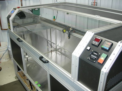

What is the current software revision for the DSP?
Here's what I have:
Main 7.12.12.26
LCD 5.12.02.29
LaserCAD V6.46
With my laser project nearly complete I would like to use the latest release....particularly the version that addresses the Z-stage function discussed in the thread started by Greolt.

Wayne, the OS link that I sent you was the latest I have. May be there is a new one after I talked to the programmer. But he insisted that there was a few very minor change and should have nothing to do with your machine. It is targeting to very big machine with speed issue.
The Z mechanism has been improved a bit from the OS I requested. You can stop Z and do Z+ Z- at anytime. Plus, it won't be necessary to travel down to the bottom and bounced back for reset. In fact, the traveling to the bottom issue was 'not' really an issue. It was about wire connection Z+ Z- that folks got confused. So, the change that I've requested was nothing but just the limit of the Z+ Z- connection. I found that I may be wasting a lot of time on that matter because of Z+ Z- limit connection.
Once I moved in to the warehouse, I'll have a bigger space for testing and I'll post more pictures and video regrading how to setup the power Z and the auto focus
