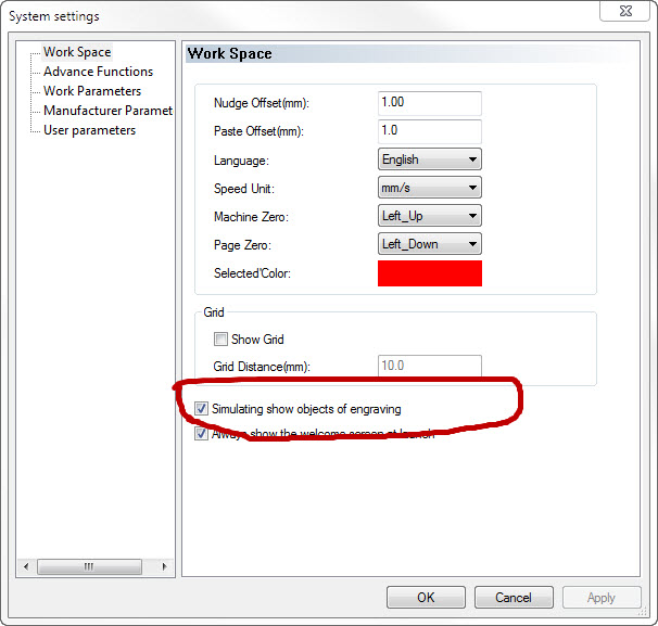

Greolt
Posts: 183
Re: Lasercad help: how do I fill sections for engraving?
Post by Greolt »

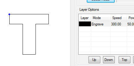

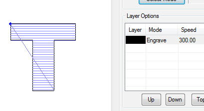

No need to import filled lettering or convert to bitmap. Outline works just fine.
Whenever you have an enclosed shape, (like the letter T) and select "Engrave"
The engraving will fill the shape at whatever scan gap you have set.
As you can see when you simulate the job.

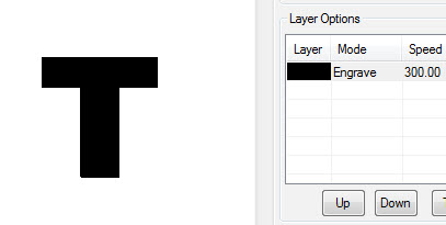

If you go to System Setting / Workspace and select "Simulating show objects of engraving"
Then all the areas that will be engraved are shown in solid colour. This is still just an outline but shows as solid colour to indicate the area that will be engraved.
