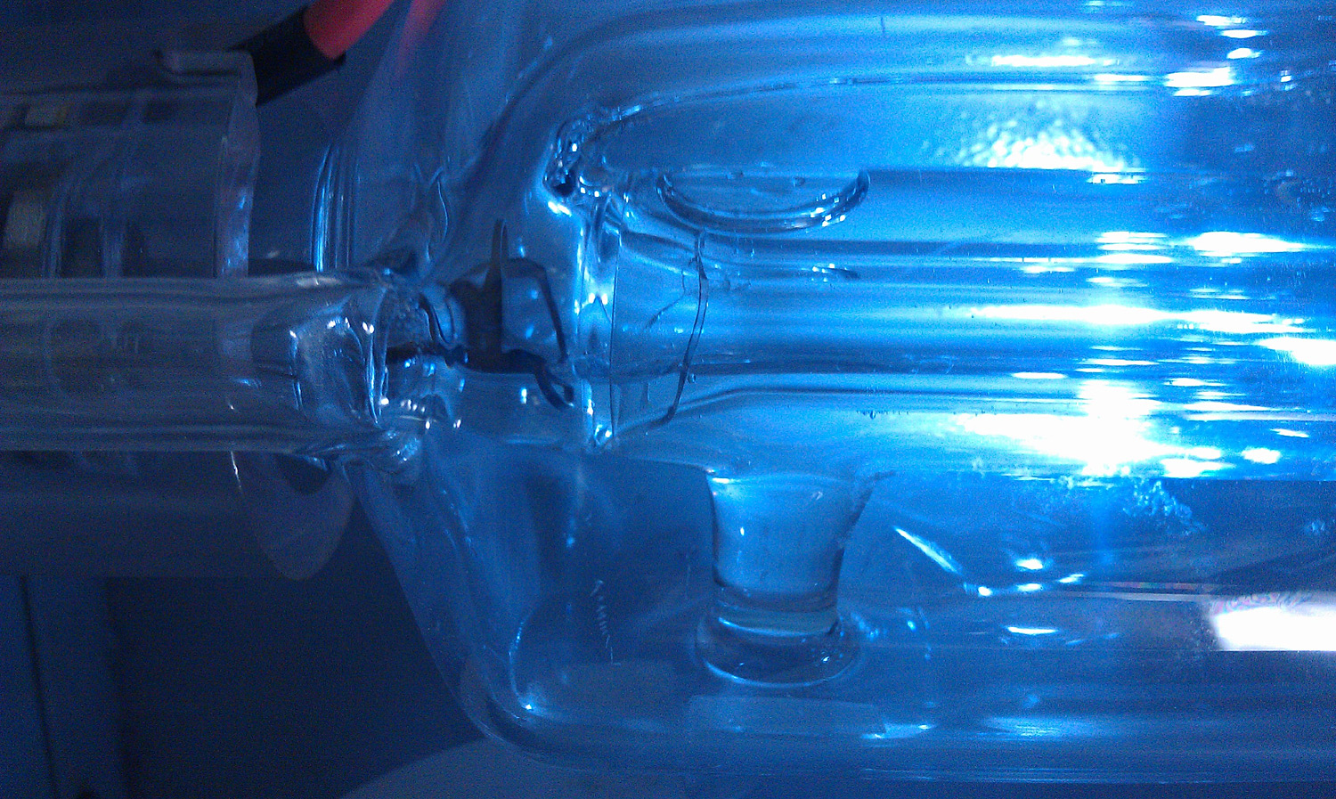

I want to warn folks who own a Reci laser tube. Do NOT use CW3000 "Water Chiller" for cooling as it is NOT a chiller. It is just an Air-water cooled radiator and it won't work well for Reci tube. The manufacturer is misleading to label it as "Water chiller" and it ended up some sad story on Reci tube. Without a true water chiller, the life span of Reci tube would be dropped tremendously and Reci will not cover the warranty if they know that you don't cool it properly.
A customer of mine use a water radiator to cool a 130W laser tube bought from me and 5 months later it cracked. Lucky I was able to get a new tube replacement for him as I'm authorized to sell Reci tube and have quantity order with Reci. The Reci know me better and agreed to replace it. A folk used CW3000 to cool Reci 80W and ended up a cracked tube. Usually high water temperature won't crack a laser tube but in most case it shorten it's life-span. What it killed the tube is water bubble that couldn't escape from the tube and the differential temperature between the electrode and the glass causing the cracked. One will find that the crack always happened near to the Cathode or the Anode. If that happen, the cause was most likely caused by the water-bubble.
Water cooling for Reci tube. CW3000 is NOT a chiller!

Thanks for clear explanation
. Now I know, what was responsible of the mystery crack(near the cathode)
of my previously bad tube(now all well with the lightobject tube
) that never worked from the
beginning. I would like to add few more suggestions to help avoid the situation(apart from the real chiller as
already mentioned), is to use a pump with good flow rate(not too high to cause cavitation(results due to dissolved
air separating out due to high force of the impeller)-tiny bubbles from nowhere being the tell tale sign).
Also use a reservoir leveled just above the tube to help the existing bubbles escape.
Few drops of Wetting agent(ones used in CPU water cooling loops), should help prevent the bubbles from
sticking to the tube walls, and will help the bubbles to move gradually and coalesce into a larger bubble,
that will eventually escape in the reservoir. Also visual checking with a high power hand torch light to
confirm no bubbles are present(mostly needed the first time, if everything mentioned above is followed)
will provide the peace of mind before starting the laser.
